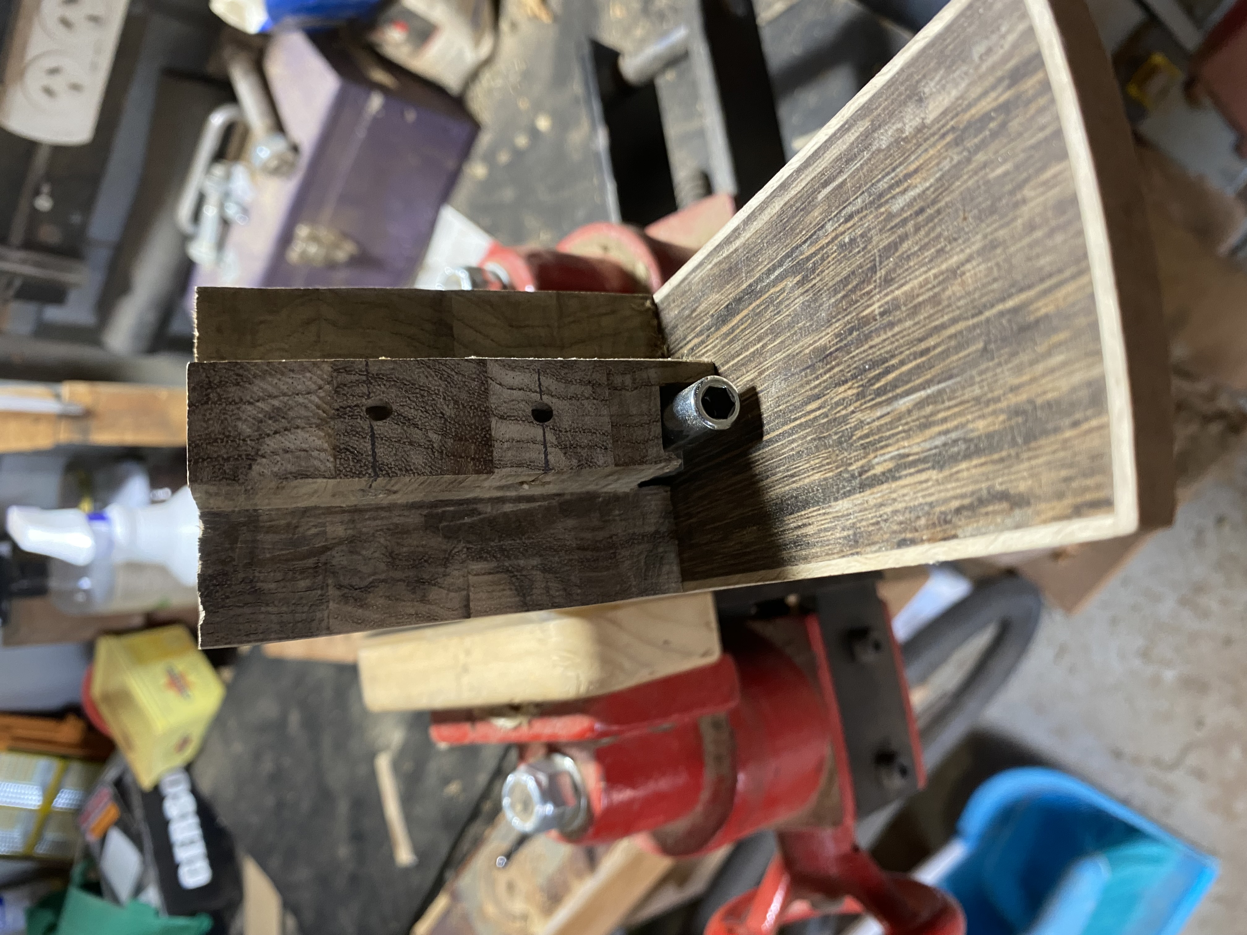

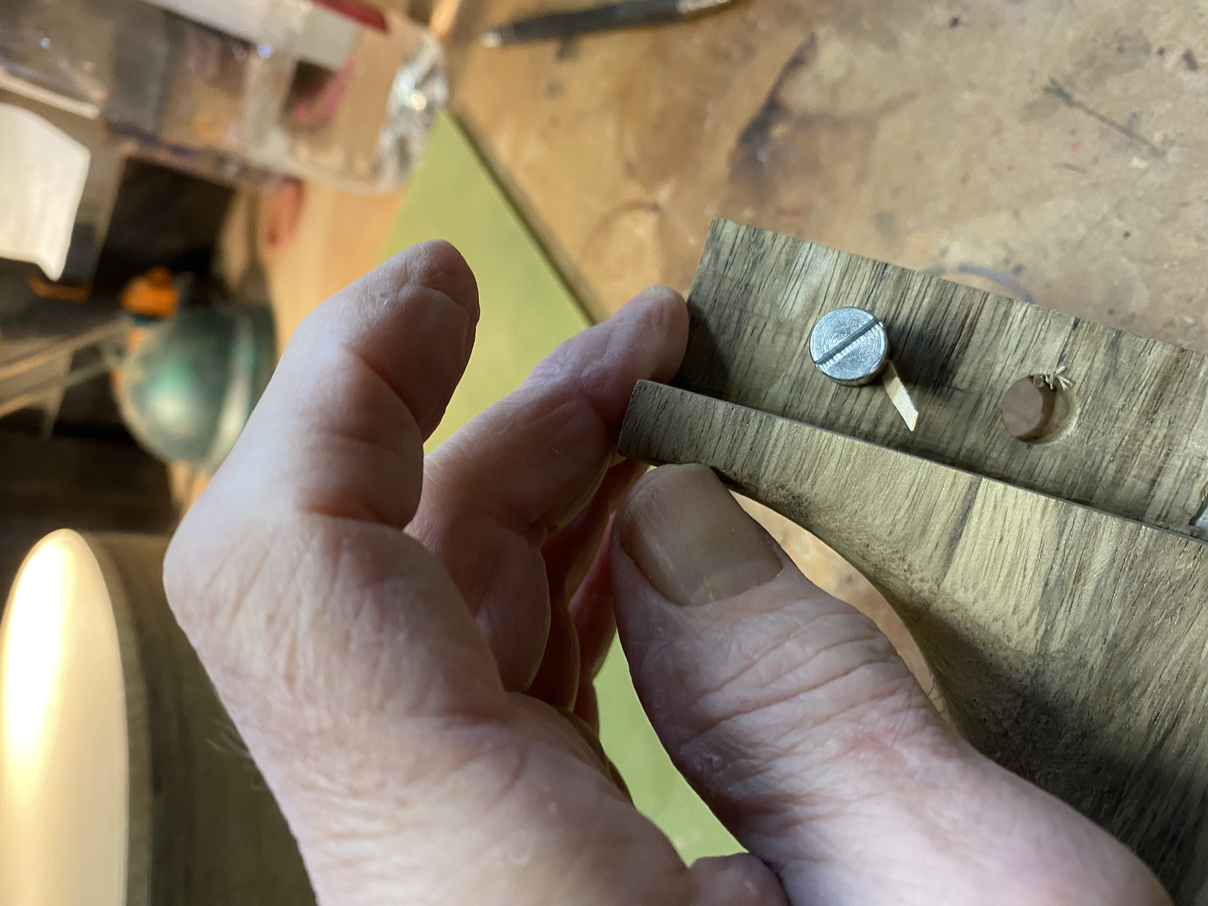

I’ve taken some photos of how I drill and install the neck bolts in my guitars, I hope I get them in order. I don’t use a jig my method is simple and I’ve used it on around 55 guitars with no problems. I will mention that when drilling the barrel nut holes in the tenon that it’s advisable to use a forstner bit. Sydney tools has 10mm bits and they’re not expensive. I put a little bit of colour on the end of the punch with a sharpie or texta it helps show the position. Wayne
Holes in neck block. I drill those when I make the block
Bolts nuts and homemade punch to mark tenon
Tenon ready to mark
Punch in bolt hole to mark tenon
Marks on tenon from the punch
Transfer marks to sides of tenon
Ready to drill
Barrel nut holes drilled
Lining up to drill pilot holes
Pilot holes drilled
Bolt holes opened to 9/32”
Installing nuts with a little piece of veneer for a tight fit
Bolts fitted
My installation tool
Tightening the bolts
All bolted up
