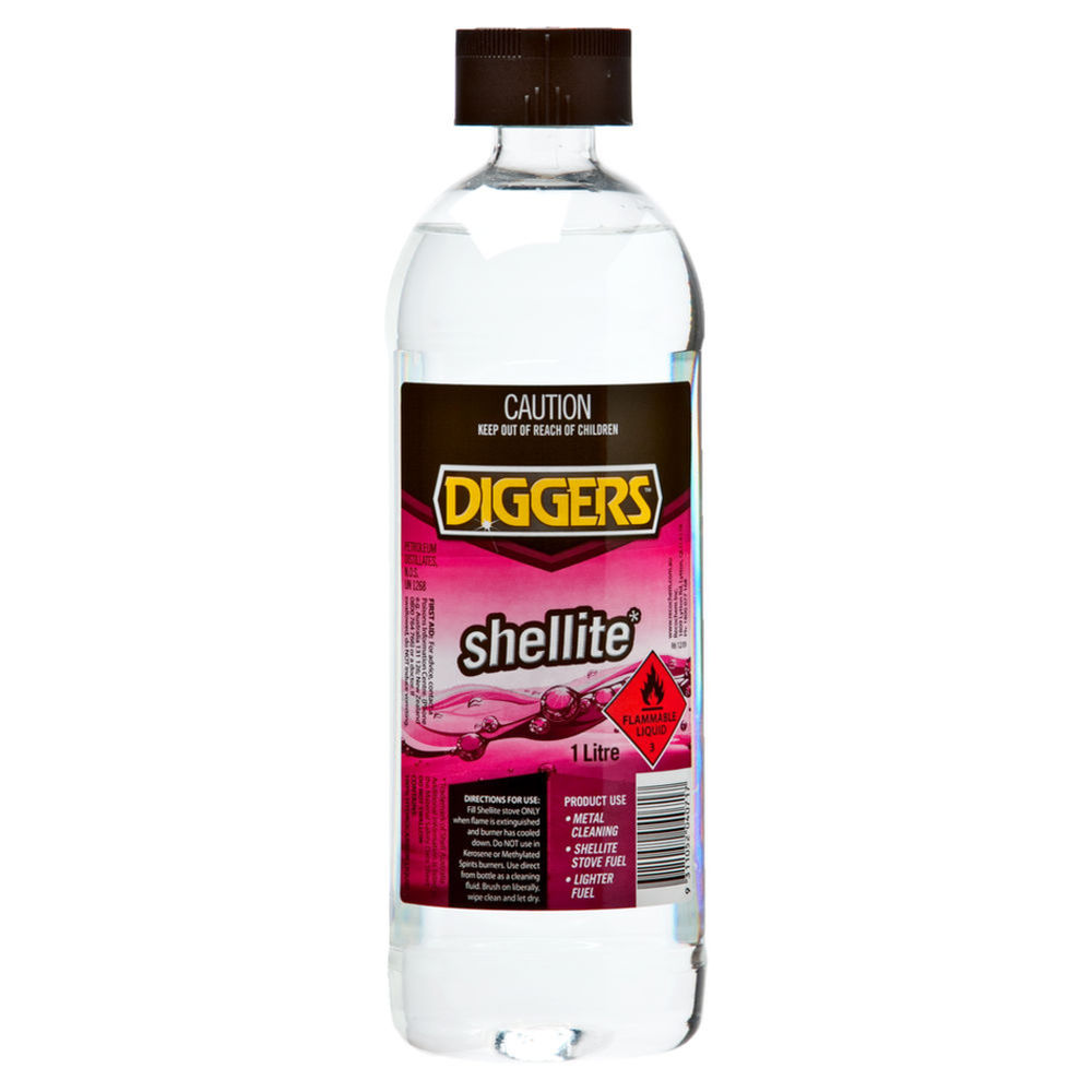

I have some adhesive residue left on the binding after removing the masking tape and I'm just a little concerned if I use the white spirits to help remove it will the be any adverse effect when applying the pre cat lacquer.
Any advice?
Cheers. Rod.

Shellite shouldn't be an issue......I use it for cleaning up wood surface prior to finishing.

Shellite is naptha....it will flash off and shouldn't leave a residue of any sort. I sometimes use it to clear oil that's bled out during French Polishing sessions.

Diggers "white spirit" is a different product to their Shellite, more akin to dry cleaning fluid.
Probably ok for this application but may not be finish safe on lacquer/shellac like the shellite/naptha

The white spirit seems a bit "oily" to me...I only use it for cleaning chisels etc.

ok so is sheltie or naphtha available at Bunnings?

Shellite should be available at Bunnings...I get it from my local Mitre 10. Diggers brand.
