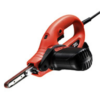

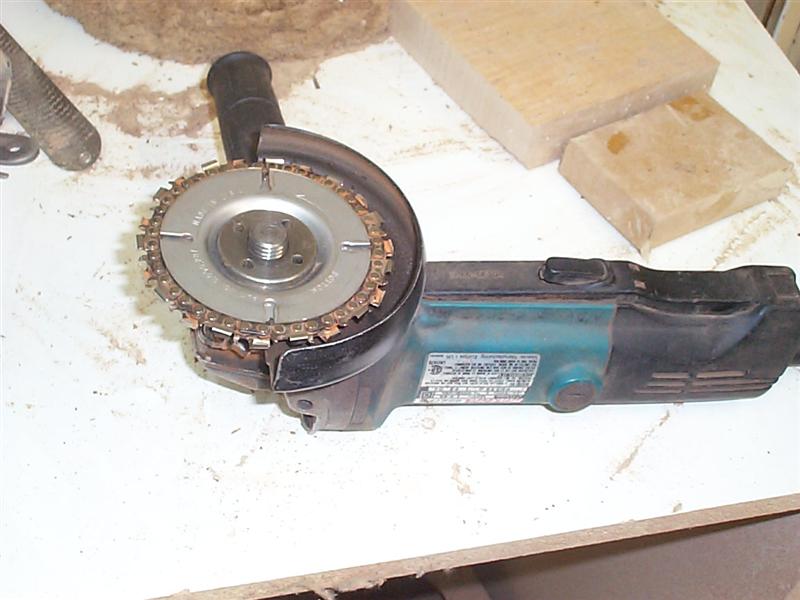

Post by Bob Connor » Mon Jun 29, 2009 10:48 pm
This is my weapon of choice for necks.
Takes about 20 minutes.
I've got an angle grinder with an Arbortech Pro-4 Woodcarver blade on it that I'll try at some stage as well. I usually reserve that for archtop mandos but it should work just as well for necks :twisted:

Post by Bob Connor » Mon Jun 29, 2009 11:24 pm
J.F. Custom wrote:Do you carve your archtop backs with a chainsaw and clean up with the leaf blower in reverse mulching mode too? :lol:
Just about. That's what the Arbortech and angle grinder are for. It's virtually a chainsaw. Makes me a bit nervous using it actually. But it's quick and quite accurate if you use a light touch.
Graham MacDonald uses the same as does Mario Proulx (Canadian Luthier) except his is called a Lancelot.
This is what Mario's Lancelot looks like.

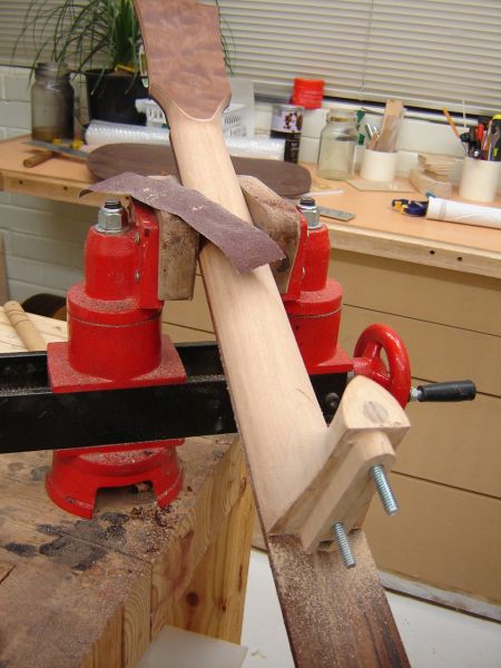

Here is a neck I am finishing now with my neck sanding strip. Just needs a final sand.

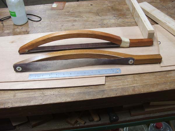

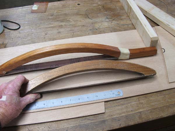

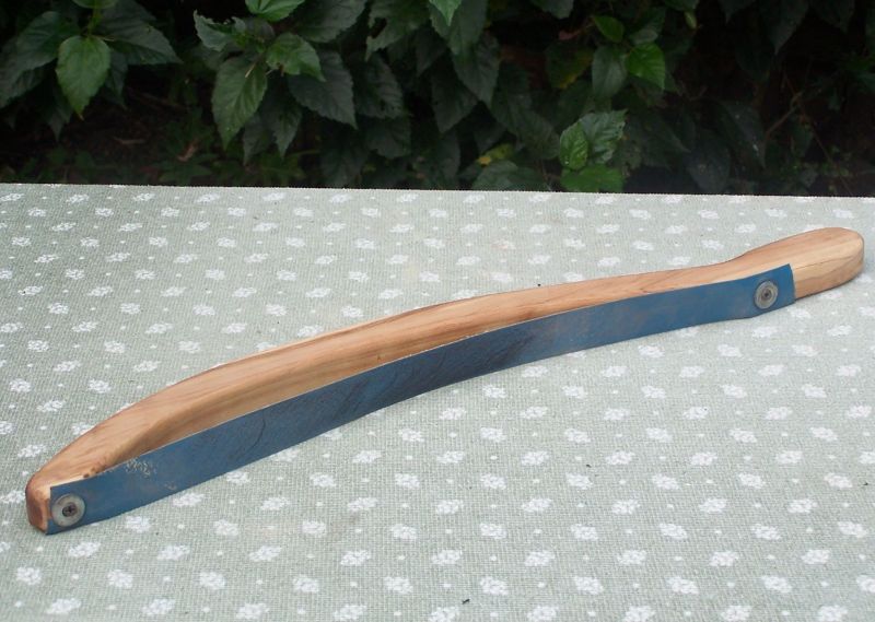

Here is another version of Bob's rasp. This one is cordless and much more refined.Sanding belt is a little slack for curves and can be tightened with a finger for more control.Great on cabriolet legs and guitar necks.I use one with 80 grit and one with 120 grit.

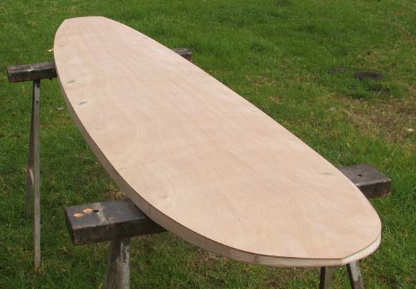

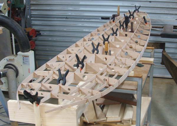

And speaking of shaping surfboards Dom, I've got a couple of hollow bodies on the go at the moment.Going to be skinned with Paulownia and no Glass.The almost green surfboard.

Hey Micheal,
Nice sanding sticks! A good way to achieve gentle flex in the paper.

micheal those sanding sticks are genius. do i dare to dream that blisters could be a thing of the past?
Post by Allen » Wed Jul 01, 2009 6:07 pm
I saw Micheal's when I was at his place back in March. I came home and made one for myself right away, and it works an absolute charm on necks. I had a picture all set to go, but waited to see if Micheal would let you all into his brilliance.
I even made mine out of camphor laural in honor of the man that gave me the inspiration. :lol:

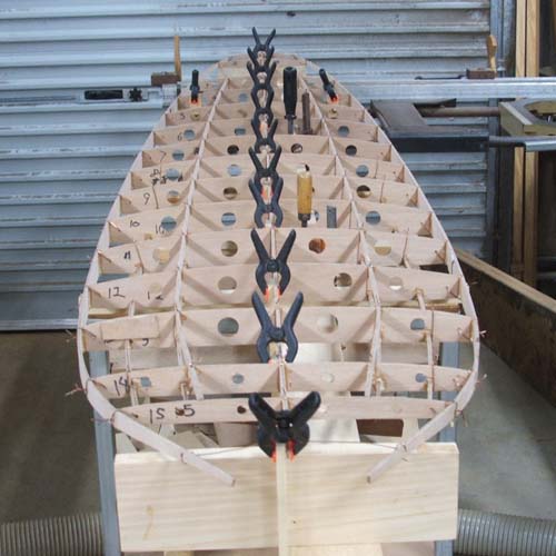

Post by Localele » Thu Jul 02, 2009 5:31 am
Heres one I pepared earlier Kim.Got 4mm ply on top and 3mm ply bottom.No solid timber for the rails in this photo.
Cheers from Micheal.

Post by PHANTOM » Thu Jul 02, 2009 8:21 am
That board frame looks like your building the endevour.
Carpe Diem
Post by Bob Connor » Thu Jul 02, 2009 8:25 am
Localele wrote:Heres one I pepared earlier Kim.Got 4mm ply on top and 3mm ply bottom.No solid timber for the rails in this photo.
Which end does the neck go? :?
Localele
Moderator
Posts: 357
Location: Corndale,NSW
Post by Localele » Thu Jul 02, 2009 6:04 pm
Neck goes at the far end where it is squared off a bit.
