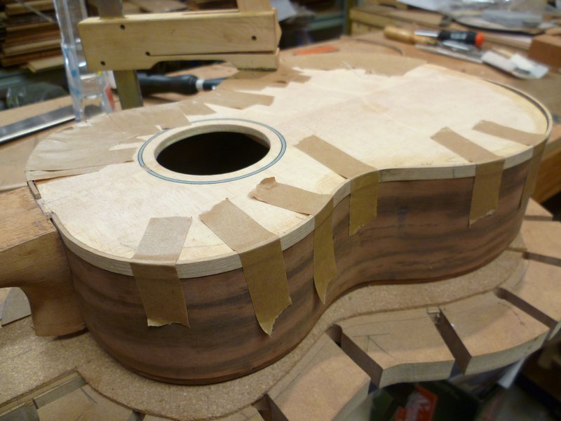

Managed to get the topside bindings done today......I'm old fashioned and stubborn so bindings were bent up on an iron which took ages. Hand bending binding and sides on a classical isn't a huge task but on a uke the curve radii are alot tighter. I usually use macrame rope to snug up bindings on my classicals but on the uke I opted for LMI binding tape. My secret weapon is the photographers sealing iron I bought for fitting the top on my lute. This tool is a must have IMHO.....great for heating up and retaping sections of binding that aren't quite snug in the routed channel. The binding I finally decided on...well I don't know exactly what the hell it is but I got it from Tim and it seems to go well with both the sitka top and the tiger myrtle back and sides. In hindsight I should have inserted some bwb purflings behind the binding on the top and back....when installing bare bindings the fit in the channel has to be perfect or gaps become obvious. Purfs give you a bit of leeway of binding fit isn't perfect.

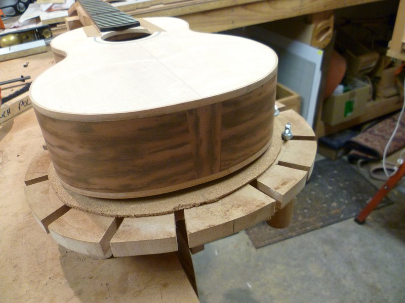

Post by kiwigeo » Sat Jan 28, 2012 8:26 pm

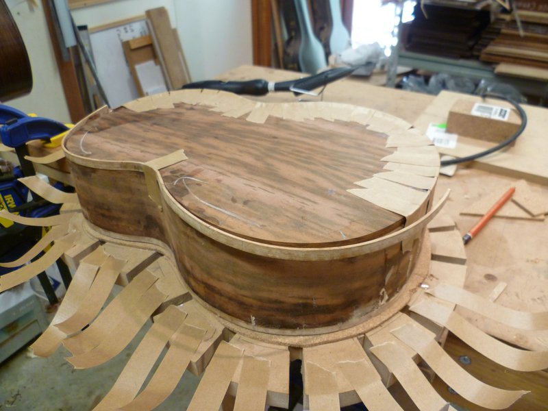

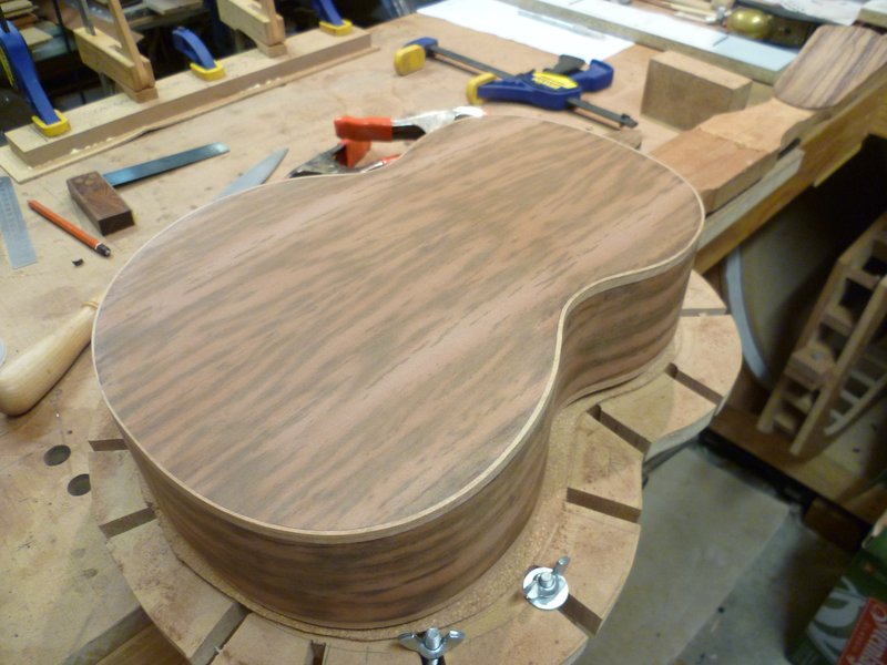

Last of the bindings glued in......was that a sh*t of a job! Tomorrow my favourite job...scraping back bindings.

Re: Steph's Tiger Tenor Uke
Post by Allen » Sun Jan 29, 2012 7:55 am
Ya, everyone thinks because it's a uke, they will be easy to build. Something to get you started on before you jump into the serious business of guitars. I find while a guitar is a bit more time consuming because of the size and extra bracing, a uke is a heck of a lot more challenging to put together. All those curves are just so tight.

Post by kiwigeo » Sun Jan 29, 2012 10:46 am
Allen wrote:Ya, everyone thinks because it's a uke, they will be easy to build. Something to get you started on before you jump into the serious business of guitars. I find while a guitar is a bit more time consuming because of the size and extra bracing, a uke is a heck of a lot more challenging to put together. All those curves are just so tight.
It's all looking very sharp and tidy Martin.
Thanks Allen,
Many true words there.....I reckon if id succeeded in getting the ebony bindings to bend into those waist bends I'd be up for an Order of Australia Award.
One question Allen....are the backs of you ukes live? This one has a fairly thin back which has a bit of flex in it but Im planning to thin down the periphery of the back to allow more flex.

Post by Allen » Sun Jan 29, 2012 11:32 am
Yes. Pretty much every part of a good uke will vibrate like mad. I've had the most success in making them light and lively.

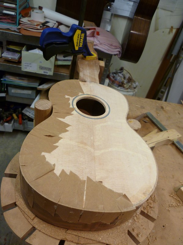

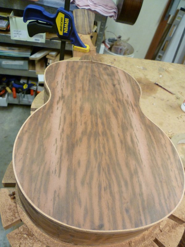

All I got done was pulling off the binding tape on the back bindings and doing a quick scrape job on same. The bindings seem to go ok with the Tiger Myrtle.

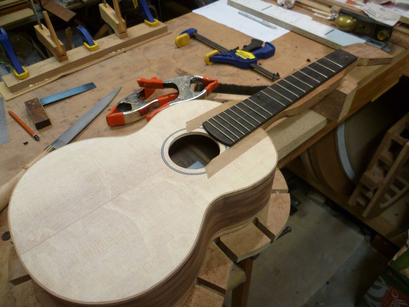

Fretboard jigged up and fretted and ready for gluing on.

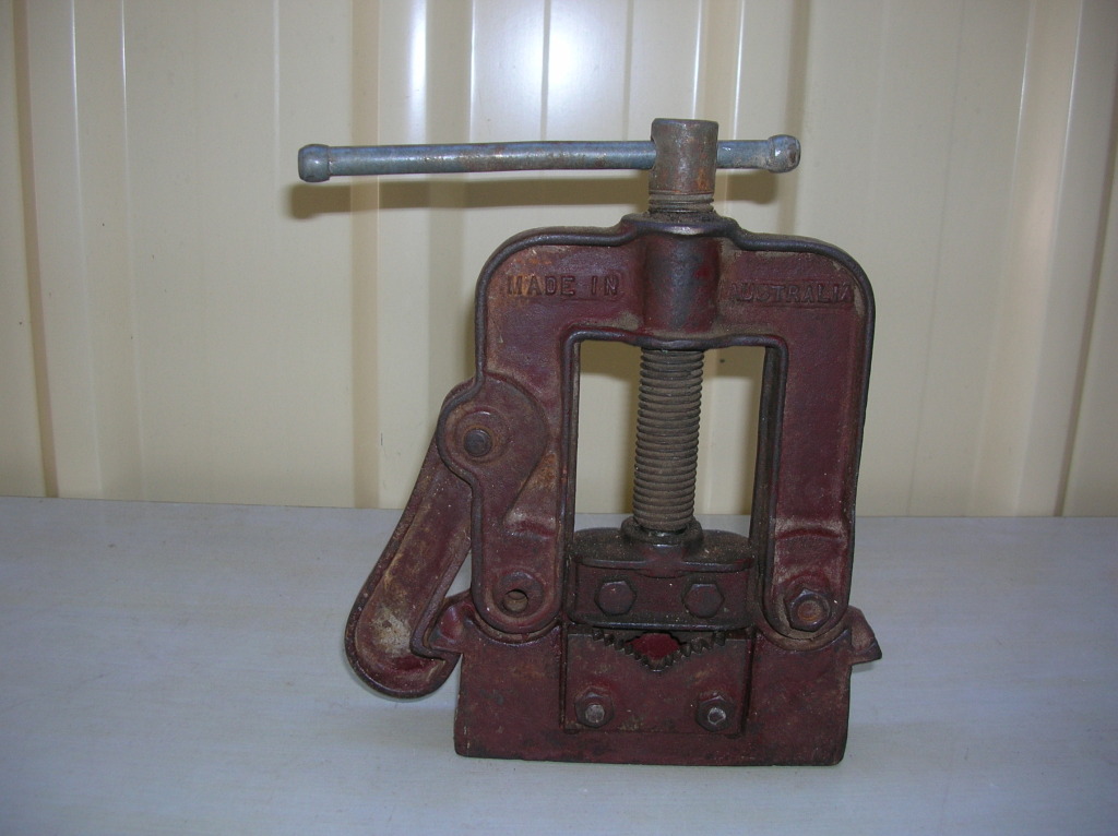

I keep seeing a type of pipe clamp on E bay that I would think would convert to a decent press for frets, with a bit of a tinker.
I'm a hammerer.....I find it helps release tension. I do have a set of Stewmac Jaws cauls for my drill press but havent yet used them.

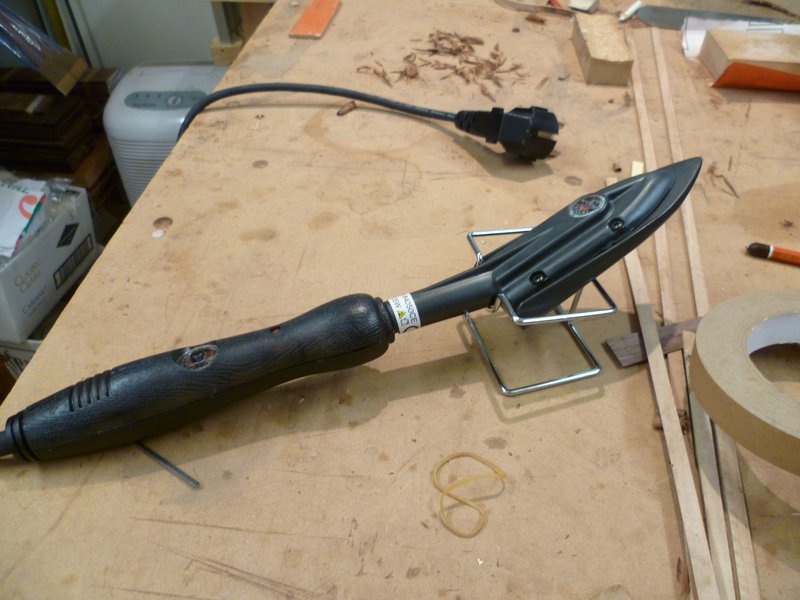

Also had meant to ask where you got that electric photographers sealing iron from? Quite a handy tool I'm thinking.
