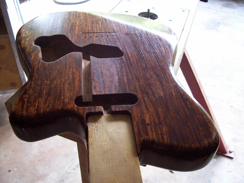

I have been putting tung oil on coffee tables and kitchen bench tops for 17 years. Not the type of tung oil that Sebastiaan is talking about as most tung oils are mixed with linseed or other oils (to make them easier to use) then a solvent like mineral turps or naptha(white spirits). I buy pure tung oil which is nothing but oil straight from the nut and has no know toxicity. As a solvent I choose gum turps but you can use anything really, nasty old naptha seems to be a popular choice.
Tung oil is said to be the hardest and most water resistant of all wood finishing oils and is also easy to repair. Kitchen bench tops that i made 15 years ago are still in service as well as coffee tables that cop a beating.

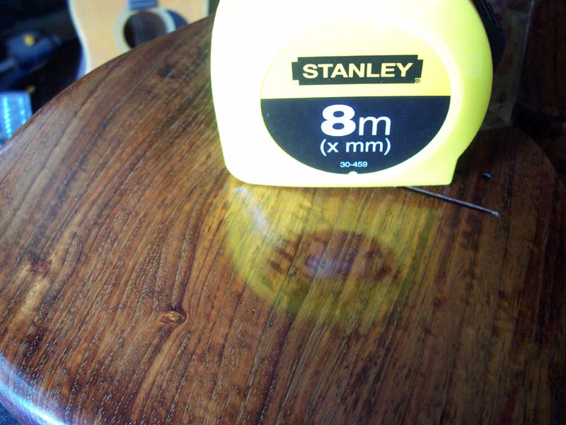

Here is a solid body that I have used pure tung oil on. I sanded the wood then used a grain filler but wiped it back hard as I wanted the grain to show then put on 15 coats of the oil, one per day hand rubbed with no sanding or leveling between coats, you can get away with 5 coats but the more you put the harder it gets. I then let it harden and buffed it.
The pic with the tape in it is the gloss at 45 degrees and the other pic is about 30 degrees.
