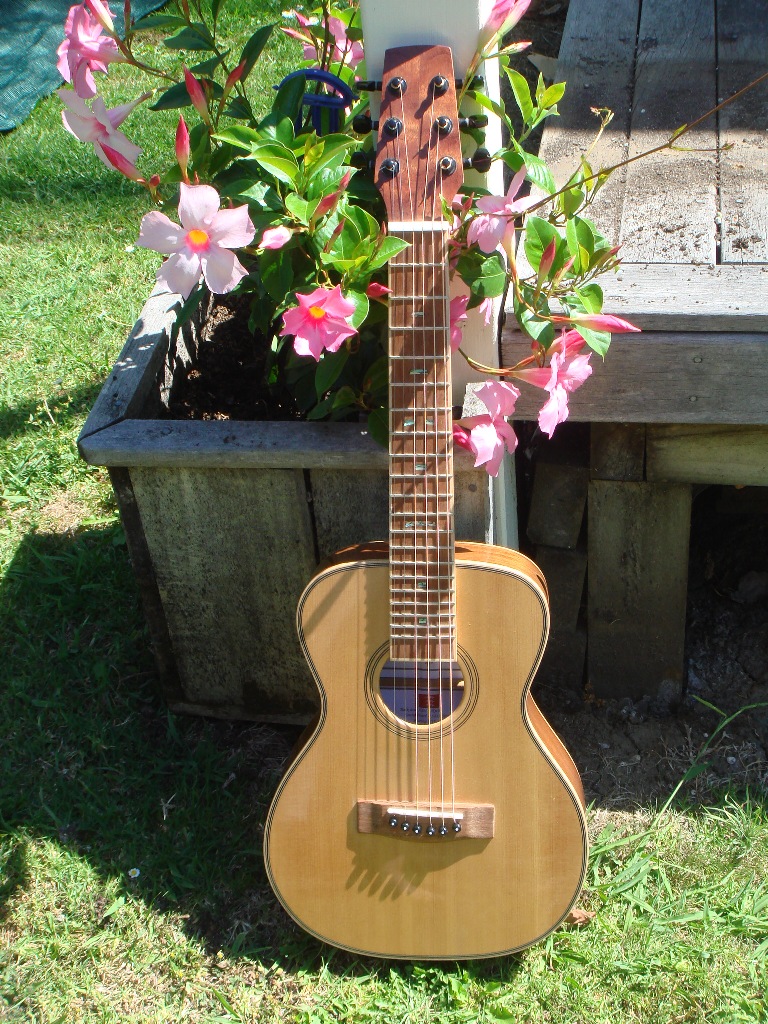

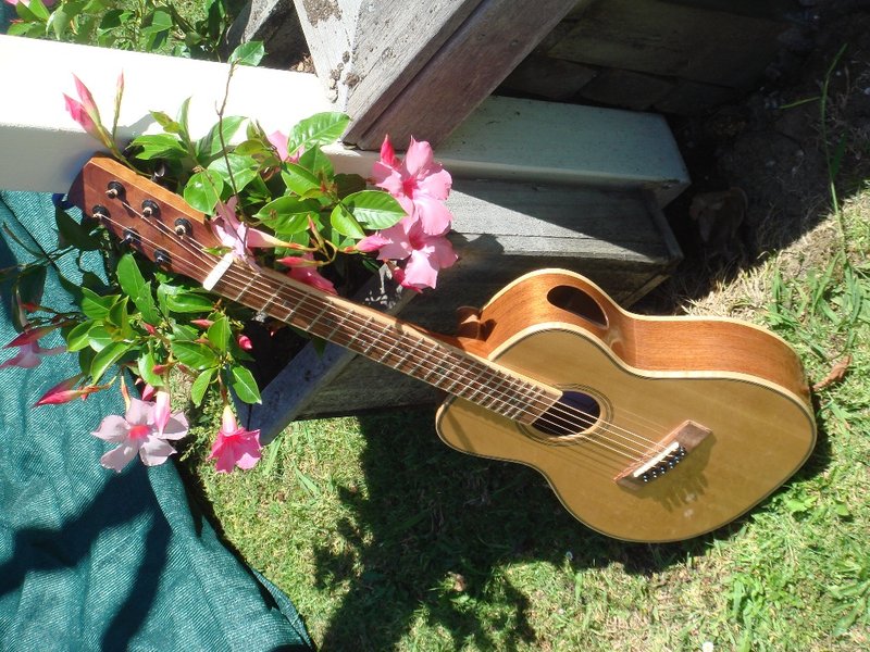

Full frontal outside in the strong sunlight

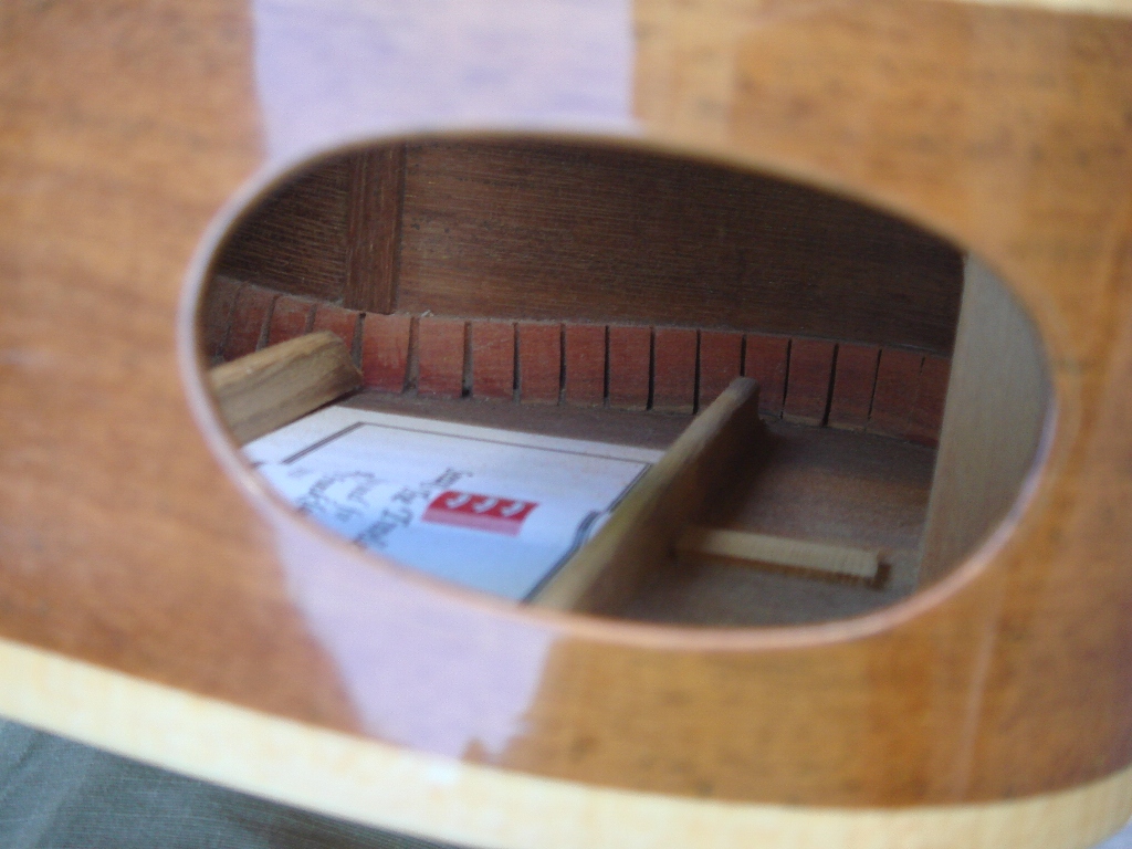

And again, with view of sound port
View through the sound port - its nice to be able to be able to play the guitar and see whats going inside at the same time - perhaps thats why sound ports were invented? All that hard work and you can't see it -unless you put in a soundport!

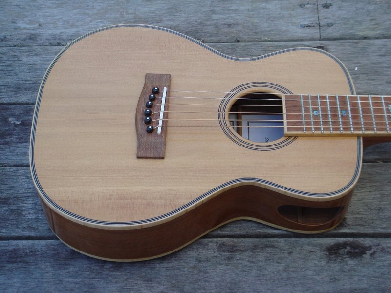

The top!

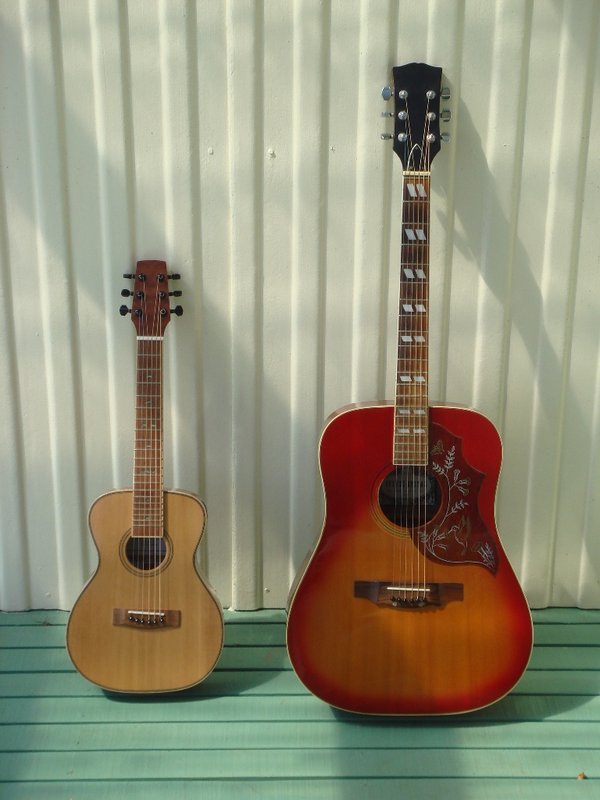

This is for Toejam - next to Big Daddy.
two together
BTW, the dreadnought is the one guitar I will never part with - I have had it since I was 18 - and thats a long, long time ago now. It's no lutherial masterpiece but I would not swap it for anything. It still has the scent of mahogany when you open the case after all this time. I serenaded my wife to be with it and sang my kids to sleep with it (irish folk songs always seemed to work best!! 4 bars and they were out for the count - or maybe they just wanted me to stop???). When I put new stings on it, I feel like Jimmy Page, Carlos Santana and John Williams, all rolled into one - until I start actually playing it of course.

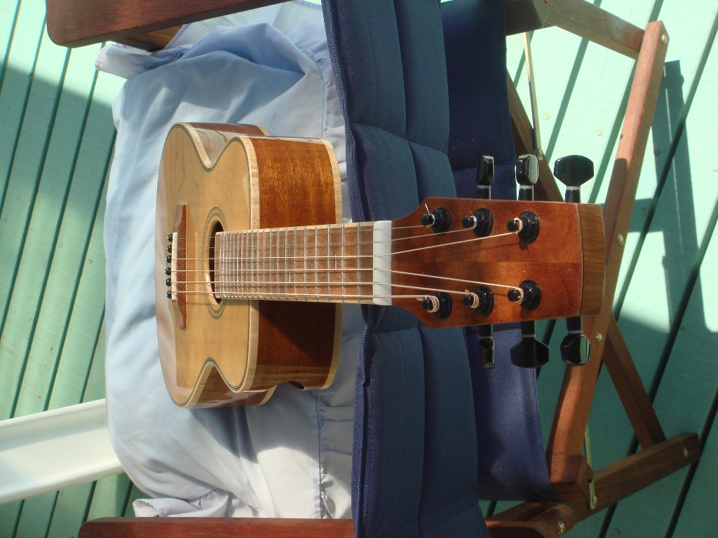

View of the headstock and fretboard. Everything almost lines up!

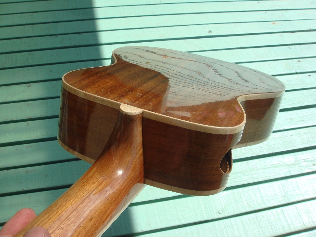

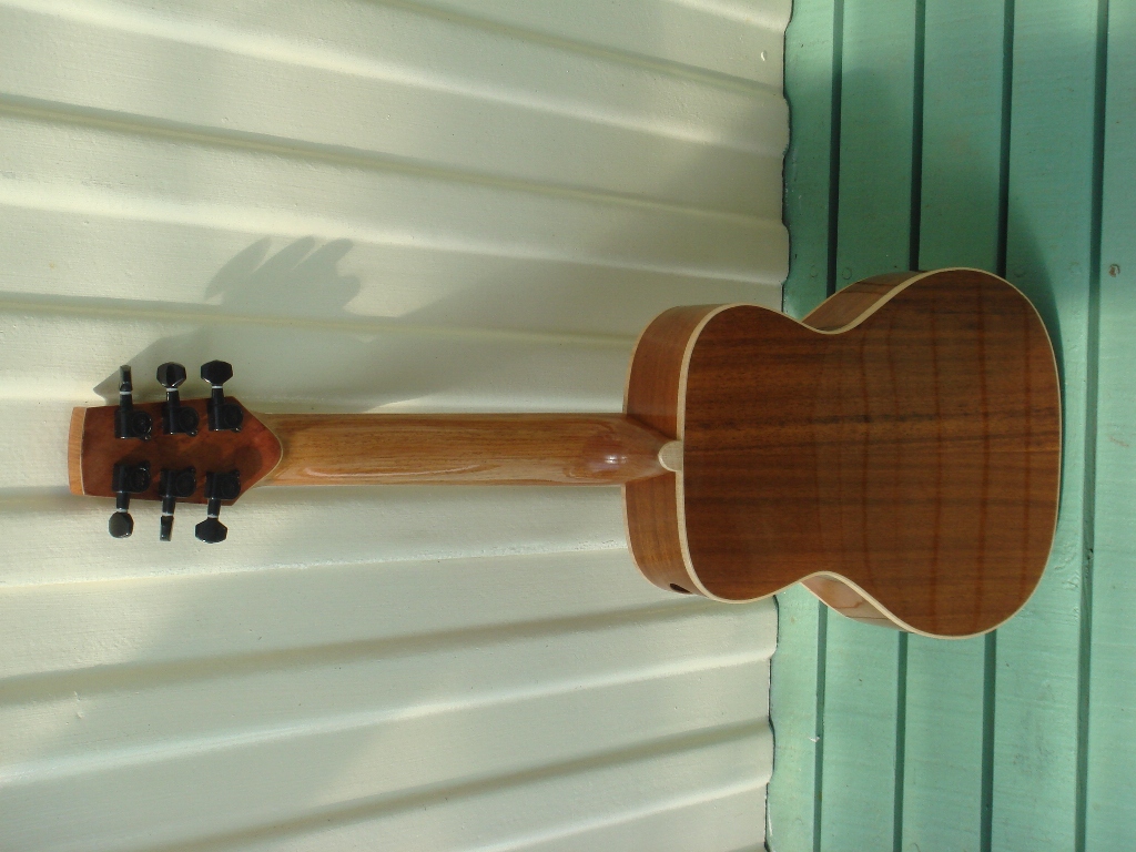

The back is a very pretty colour, I think
the back
I am also happy with the finish - the blotches you see are actually reflections of flowers. Its shiny.
shiny back

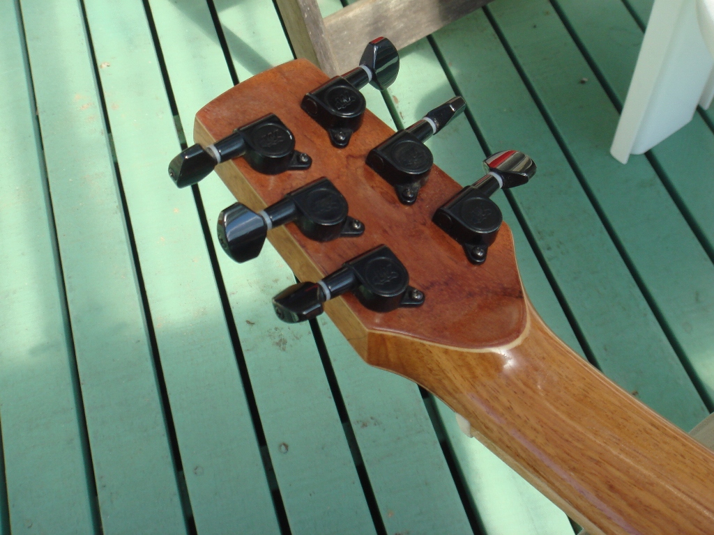

Finally the back of the headstock - my first laminated headstock - again, needs must, I stuffed up the tuner holes and got one out of line , so had to fill them in, cover them up and start again. I wonder if that's why laminated headstocks were invented? You never know , do you?
back of headstock

Tidy work Richard, you must be happy to see it finally hit the gallery. I am guessing that scale is pretty close to a Terz guitar are you tuning it up to a G?

that kwila comes up pretty spiffy, Richard. well done!

I love small guitars. The wood choices work a treat on this one. You've got that finish down pat too.
Have you found a case to fit it?

Nice job Richard, I like the timber combinations too & the shape is excellent (I like a tight waist :wink: ). Got the strings & bridge on upside down though :lol: :lol: :lol: .
