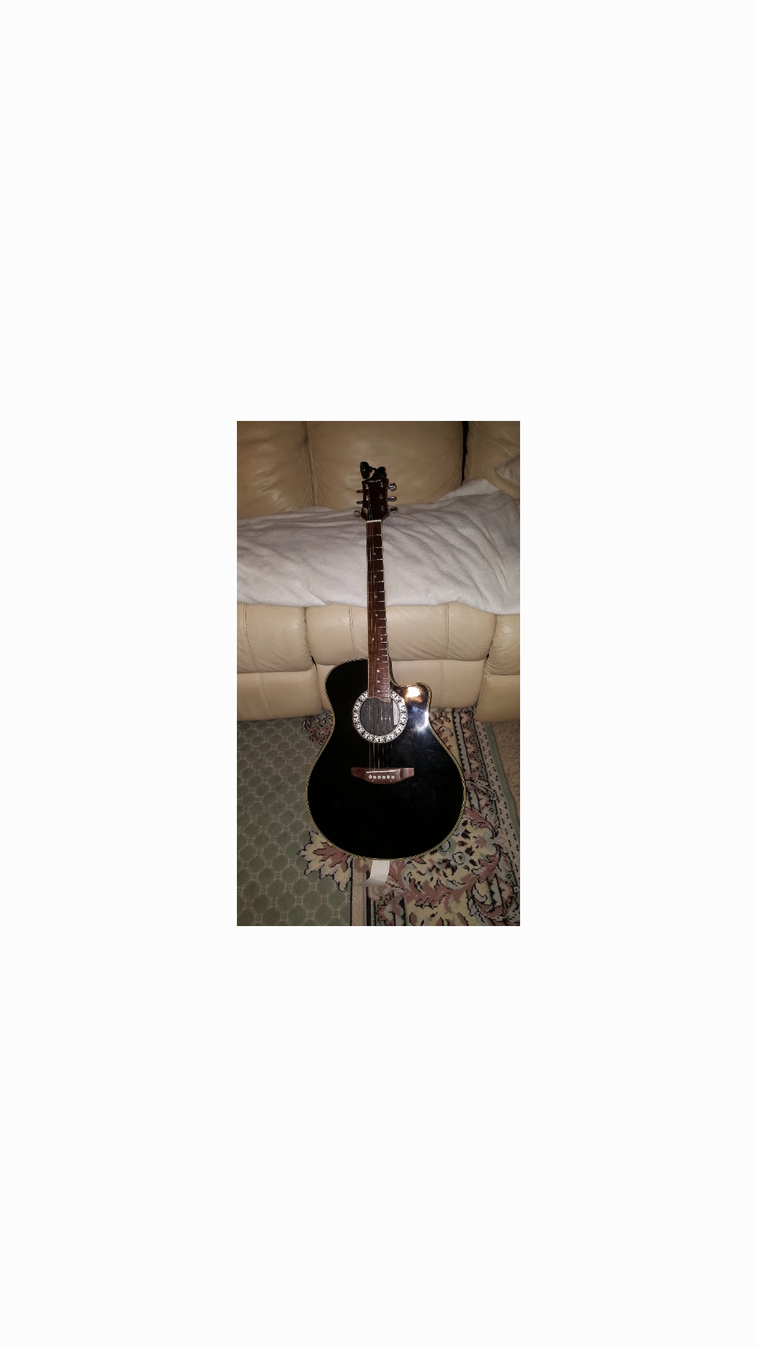

Post by David Herring » Fri May 20, 2022 11:20 am
[img][/img
All finished and ready to go to a good home. Had not seen an Onyx before but looks like Ovation copy. Fixed all the crackling with cotton buds and Kleanium contact Kleen. Bridge is glued and not pretty but solid. Thanks everyone for your help.
