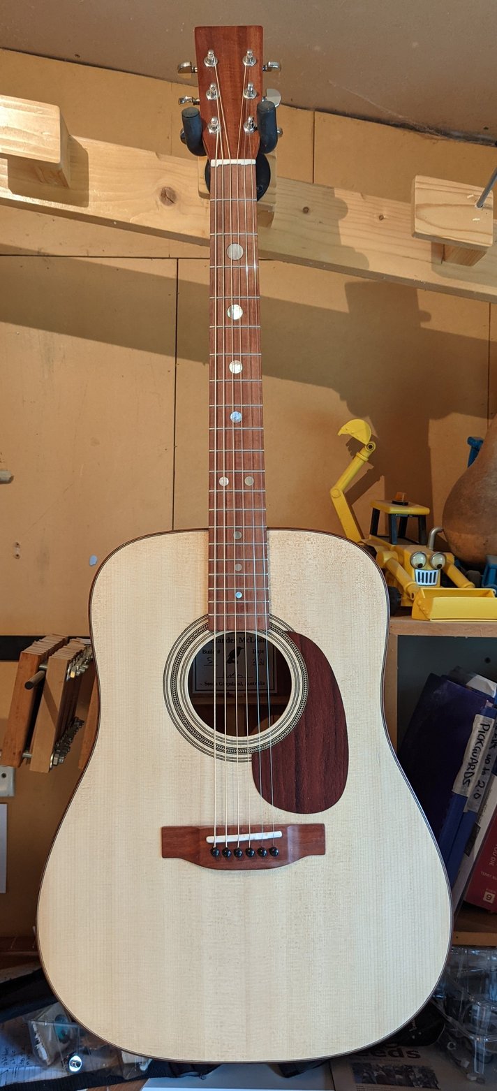

I have built 5 guitars over 5 years but hope to build more than 10 within 1 year ! I have a love for recycled timbers and enjoy the challenge of turning them into viable instruments, a long road to take ! This is Build 05, a lutz top set into tas blackwood back and sides, with recycled redgum ( fence post ) fretboard and eucalyptus ( floor joist ) neck. The inlay markers are made from some abalone I found whilst out for a walk. Am happy with the result apart from some finishing woes, looks streaky viewed from an angle. Still, I am improving guitar by guitar.

Welcome to the forum Alex and nice work on that guitar. What did you use as a finish?

Thanks Martin ! I'm using U-beaut hard shellac and Robbie O'Briens french polishing course. No 2 came up well

but that was about 2 years ago and I'm using the same bottle. I did test it and it did set ( over about 3 days ), would the age of the shellac affect the finish, or is it just me getting used to the technique ?

A bit hard to see the streaking you're talking about on the guitar No 5. is it just on the top wood or on the back and sides also? Is the streaking on the surface of the finish or in the wood underneath? If had streaking with hard shellac when I've waited too long between bodying sessions....were talking a couple of weeks.
Shellac does have a shelf life....using made up shellac that's 2 years it probably pushing but if it passes all the tests then you should be ok.

#5 looks great in the photo! I also find finishing to be the most difficult part of the build to pull off without flaws (which is to say that I have never done one without flaws). It seems to either require very fancy gear, or incredibly fastidious technique, or both. II am also very impatient by the time I have finished building the thing, so tend to rush the last step. 10 in a year is very ambitious! Is this as a business venture? And does this mean building ten alike, which would be most efficient, or mixing them up? You will be really developing your chops by the end of that effort.

Martin I tried to get a photo which shows what I mean, it's there but hard to photograph. It's the topwood, there are flat spots where the wood 'looks thirstier' that in other places, but perhaps I am being fussy !

Looks lovely in the photos. You're entitled to be as fussy as you like :)
I agree it took me as long to put the finish on as it took to build the guitar, until I swapped to french polish. I find it the easiest to both apply and fix when things dont go right. Mine dont turn out with that uber-shiny " dipped in plastic" look others can achieve but its good enough for me. More than offsets the hassles with paint/lacquer I feel.
