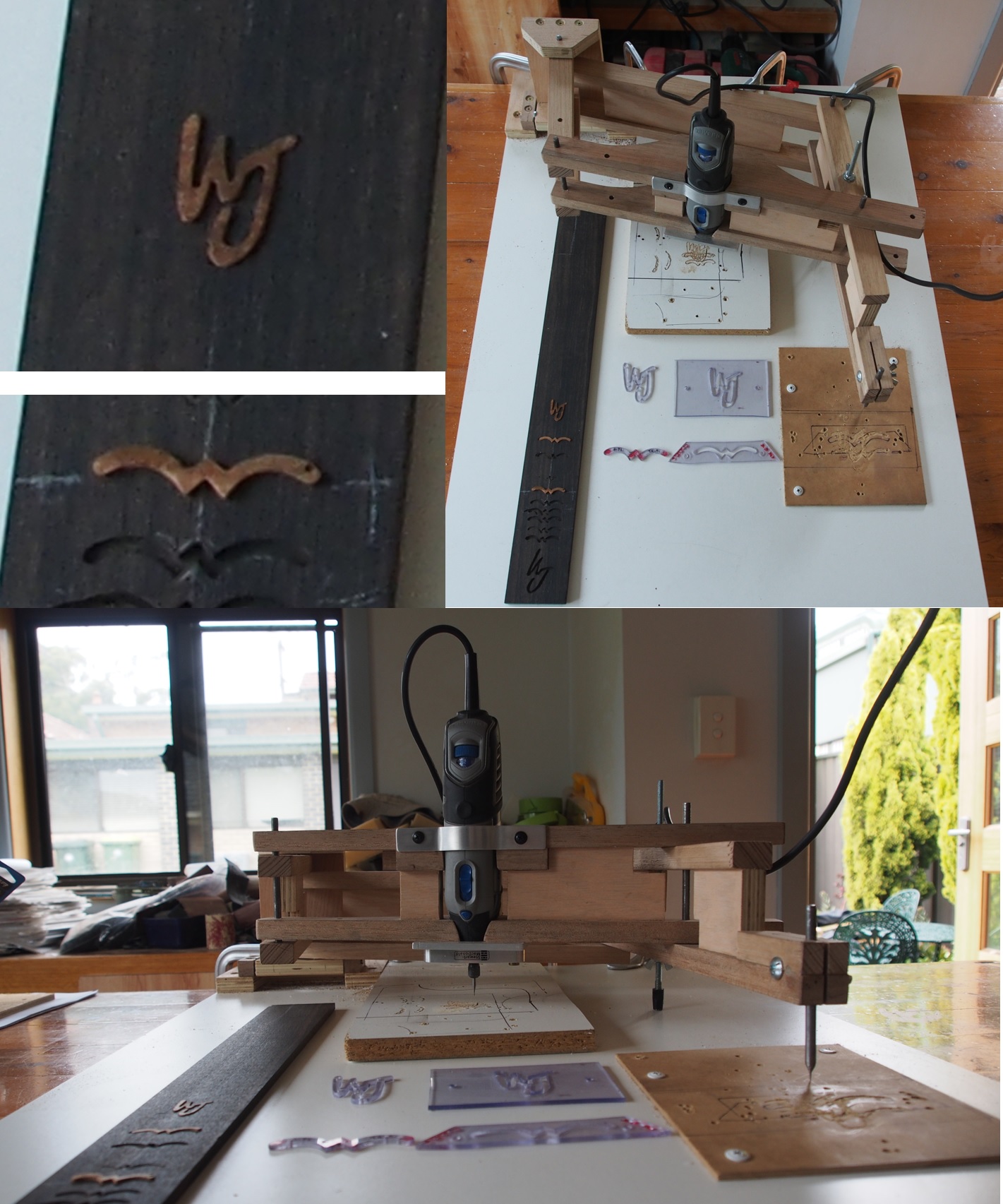

In between house projects I decided to make a jig for guitar inlay work. Previously, I was using my Dremel tool freehand using paper cutout patterns and this was a slow process. I was considering purchasing a small CNC machine, however, at this stage my budget is limited. As an alternate method I decided to make a Pantograph Router from available scrap materials to make my design inlays.
This involved searching the internet where I found a suitable Pantograph Router design on You tube from 'Woodgears' (see link: 3-D router pantograph - Woodgears). I purchased the building plans for $12.00. It took me 3 to 4 days to build the Pantograph Router and then make suitable to fit my Dremel tool. The hard part was then making the perplex matching guide templates. I used 'Word' to create the inlay design patterns for the fretboard and the headstock logo. I then used my Dremel tool to cut the perplex guide shapes. This took a few goes to make the matching guide templates accurately to the shapes designed.

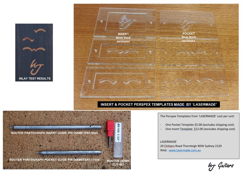

I then made some test inlays runs using a 1/32" router down cut bit. This involved making a pantograph guiding pin post to the same diameter as router bit to cut the inlay work correctly. The pantograph router has been set up to cutout half sized inlays. The guide templates had to be double in size to achieve the required sizing of my inlay designs.
At this stage I am happy with the results.

Getting perpex templates cut on laser is a great idea and yes I will check this out. There is a place nearby that may be able to do this.

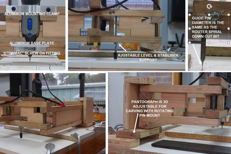

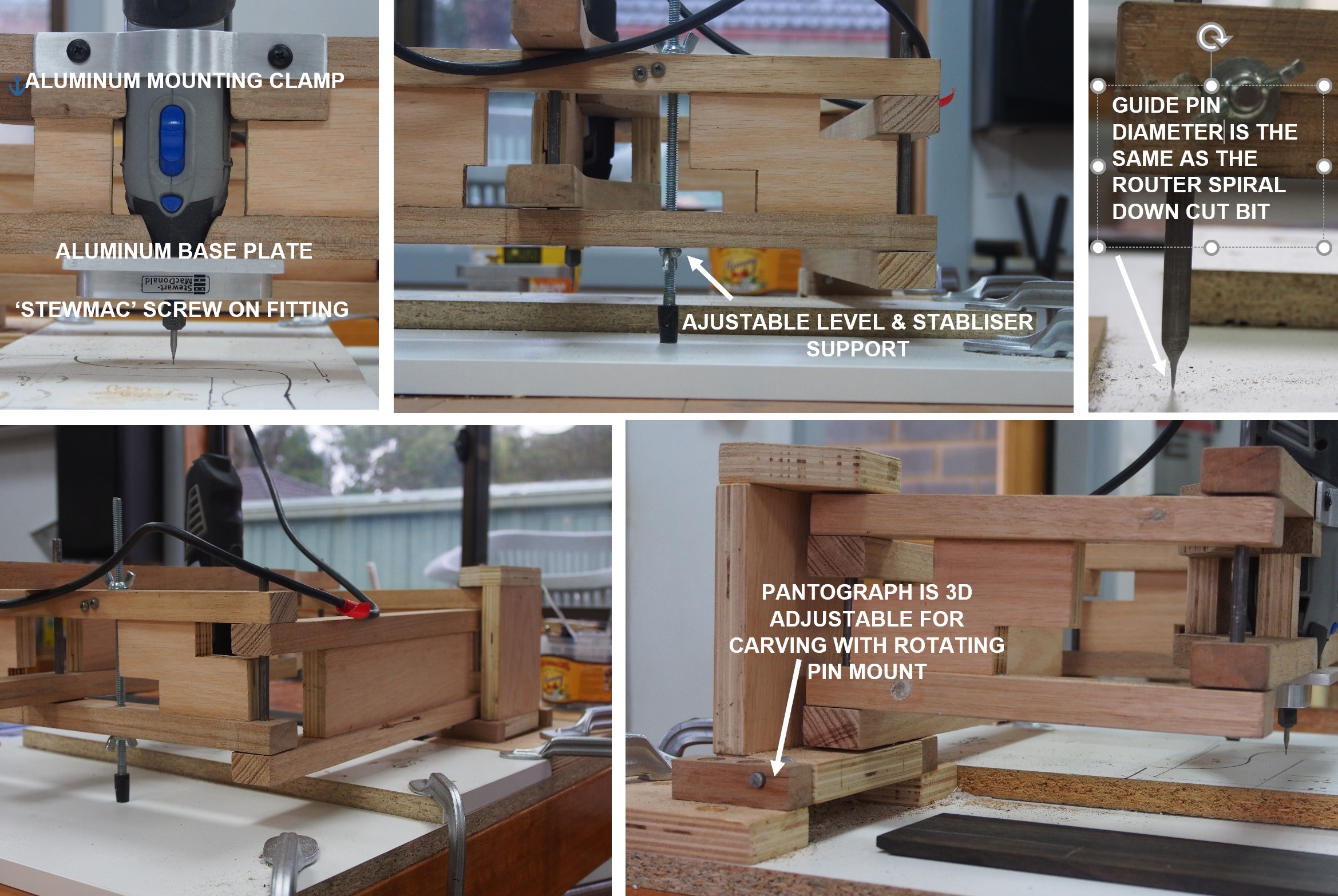

Yes it has been an interesting project. The pantograph design plans purchase did require some minor modification to the design to suit my Dremel tool. Instead of using timber clamp holders, I made an aluminum side clamp and base plate that enabled me to use a spare 'StewMac' Dremel screw on fitting that has a dust blower connection. I added an adjustable height vertical support that keeps the pantograph level and stable. See attached photos.
I also intend to make some clamps that slide into the base board to align and hold the guitar parts that are to be cut for inlaying. It is important that that these parts have been glued or attached on a mounting board with glue or double sided tape when cutting timber or pearl pieces. For fretboard pocket inlay cutting only clamping is required.
Its good when you can make a jig with available left over materials in your workshop and save on costs to help better build your guitar projects.

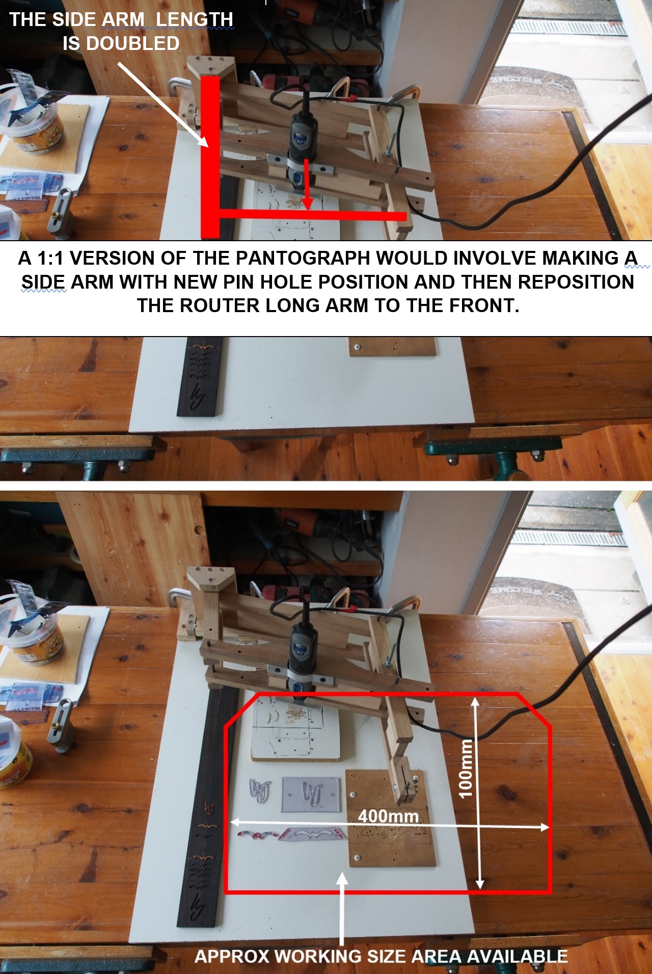

With the ability to go 3d, if you could some how add a pin somewhere that allows it to be 1:1 then you could use it for making and copying bridges etc, in essence then a duplicator as well
Re: Guitar Inlay cutting Jig
What are the maximum dimensions you can cut to? I guess this is governed by the closest/furthest the pub will move from the pivot.
Am I also right in thinking that you could do a complete bridge as long as the template was laid perpendicular to the pin-pivot line?

Yes I see there are more possibilities to add more value to the pantograph. A swappable longer side arm should work, see photo attachment. I would need to gain more experience with the 3D carving approach to make a guitar bridge. Its an interesting idea to develop.With the ability to go 3d, if you could some how add a pin somewhere that allows it to be 1:1 then you could use it for making and copying bridges etc, in essence then a duplicator as well
The maximum dimension area available for an object to cut a piece is approximately 400mm x 100mm, see photo attachment. The plans drawings available for $12.00 from 'Woodgears' show this more clearly. At this stage I have no experience in making a bridge using a pantograph. I would need to trial the process to set out where the pin-pivot would best be positioned to start the carve. Both the bridge guide template and piece to carve would need to be aligned / positioned in the same orientation. I'd expect that you would need to be careful in the 3D operation to carve with the appropriate router bit.by TallDad71 » Sat Mar 20, 2021 9:34 pm

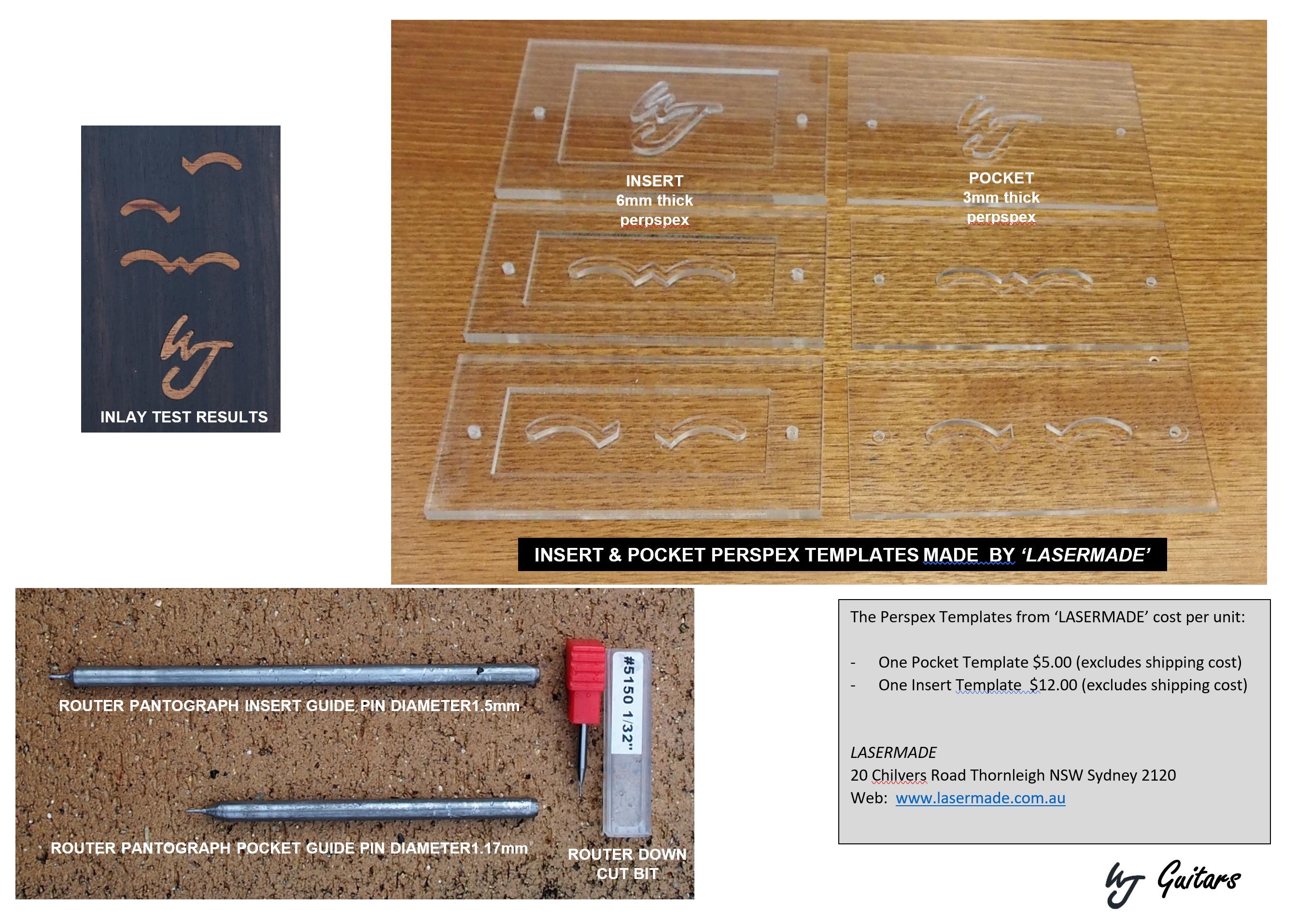

As previous suggested I organised getting the perspex templates made using a laser cutter.
This involved creating CAD drawings in a free trial CAD programme called 'SketchUP'. For each template drawing I created '3D' and '2D' DXF files. As a guide to make making the CAD drawings, see pdf attachment.
Only the '2D' files were finally required. I then sent the '2D' files to a company called 'LASERMADE'. After receiving these templates I have made test inlays and I am happy with the final results. See jpeg photo attachment.
I have provided some information on the photos that may be helpful if you are interested in making and using a router pantograph for your own style of inlay work.
