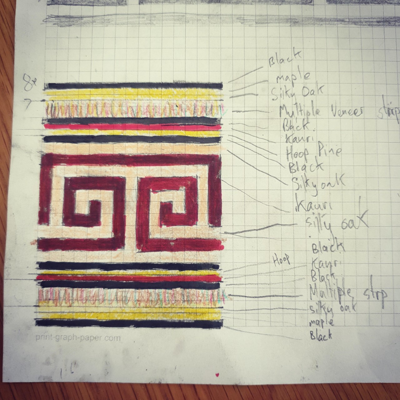

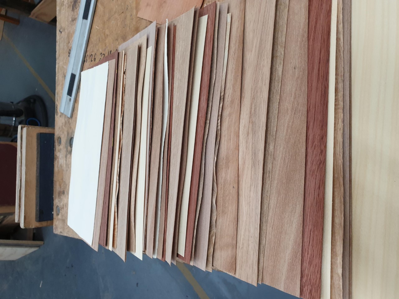

This the Design
Veeners ready for glueing the quasi rope band
Rope Band Block Glued Up

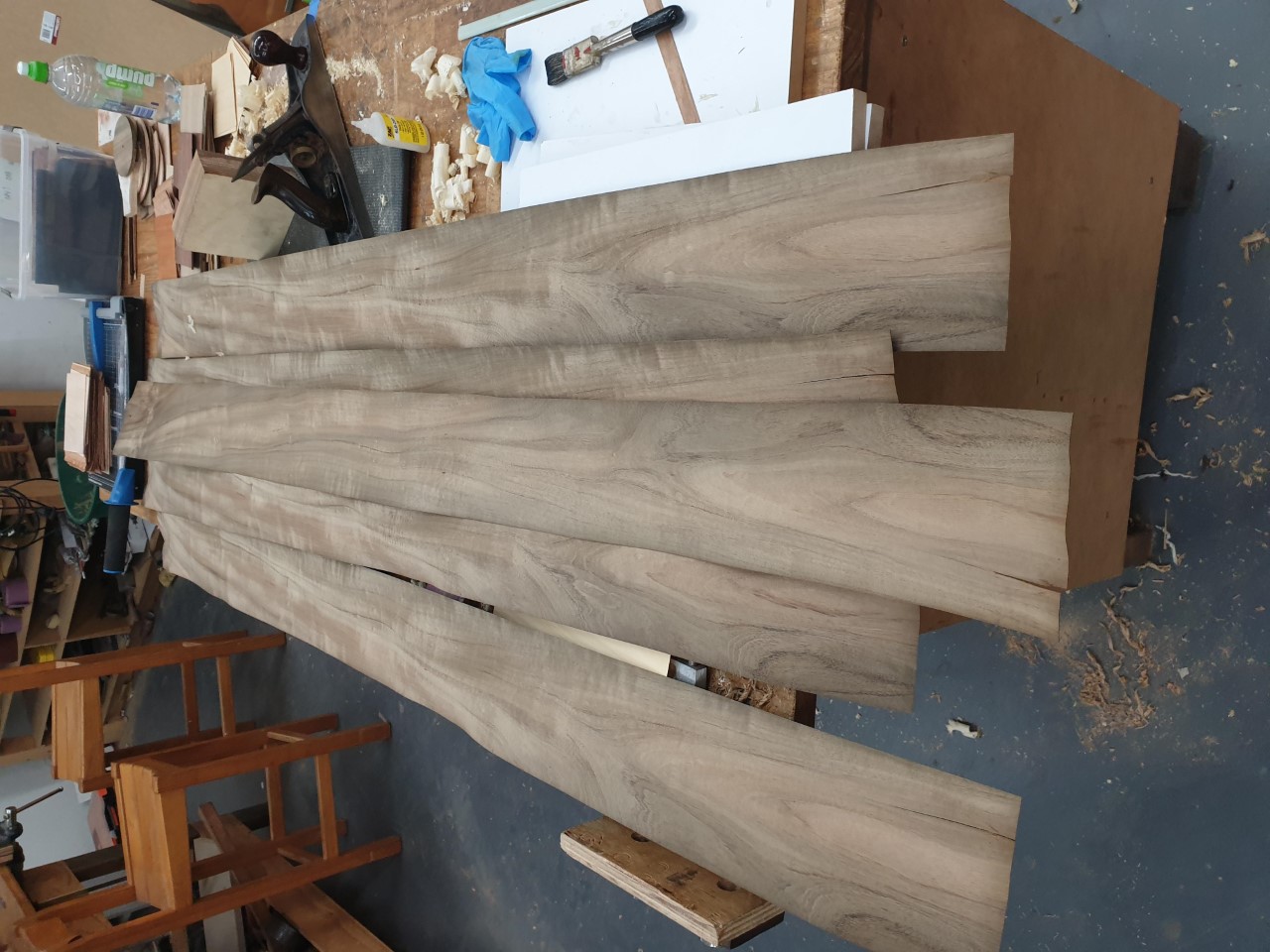

10 metres of Walnut Veneer!!
First row glued and planed

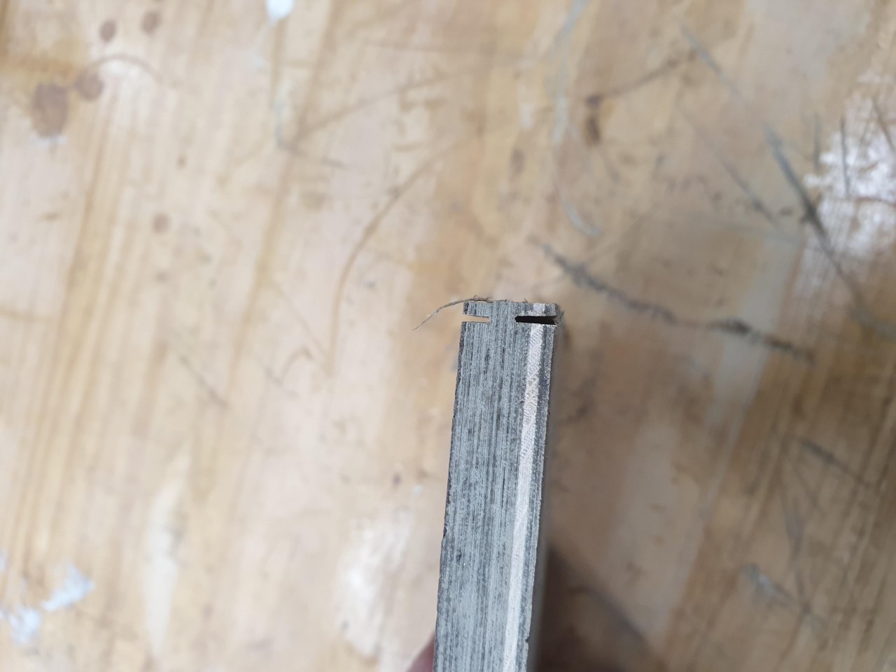

The first test cut. I ended up setting up a jig on the Table saw and used the Fret Saw Blade to cut the thinnest Kerf I could Get. I got it set up to be able to cut it cleanly by squaring the block and flipping it.

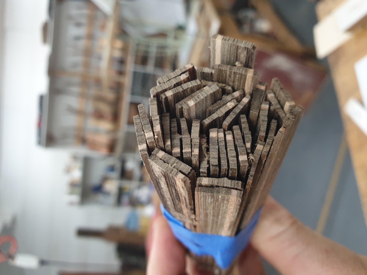

35 Strips cut for the first Column of the mosaic pattern. Only 245 to go.!!!!

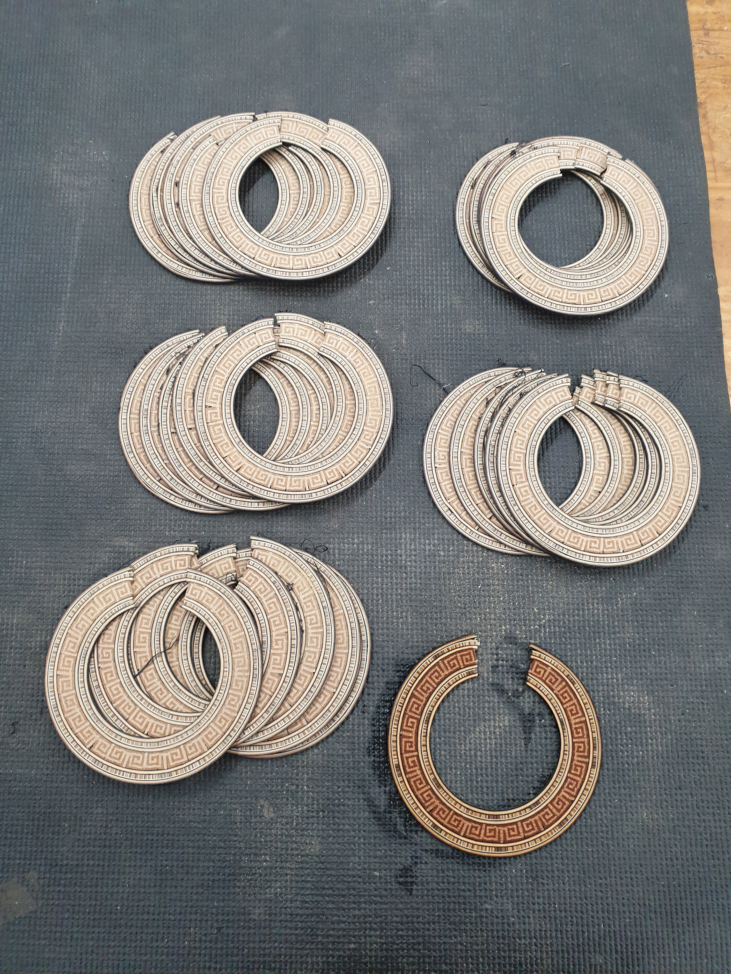

Hi There,

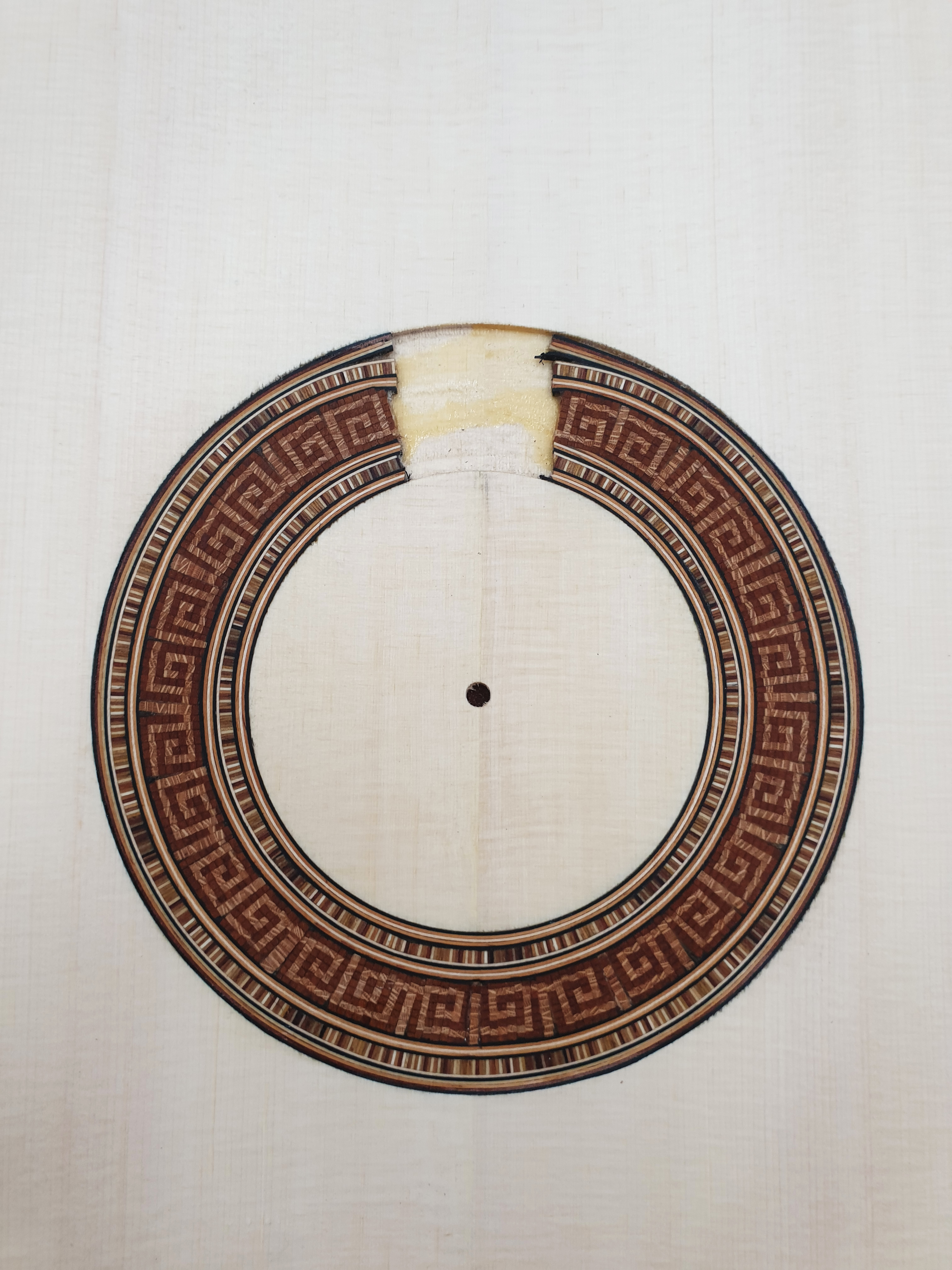

I have been working on this rosette log during the covid lock-down when my guitar making classes stopped for a little while. I have finally cut up the rosettes and although they are far from perfect I am still really happy with the outcome.
In the Pics above I used walnut and silky oak as the main timbers for the centre mosaic tile but I decided after making one stack that the contrast was not striking enough for me. I then got to work making my own veneers on the drum sander because I had already blown my budget on the previous veneers! I used Mahogany and a very pale silky oak which looked better.

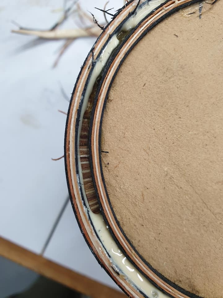

The only thing I didn’t get quite right was the angle of the tile columns when I glued them to the log . I did plane each one of them but not quite enough and this produced a few gaps. After installing them into a soundboard I simply scalped out the section that had small gaps and installed a piece to fit.
Some said I was mad and that the process looked tedious, but I rather enjoyed the journey and have ordered more veneer for the next one now that I have nutted out how to do it and get it right. It will be a much smaller log making the job a bit easier.

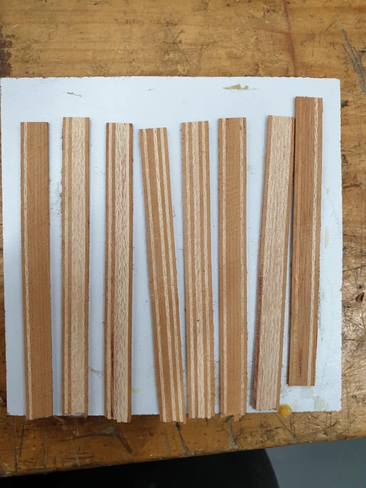

8 Rows to be Glued

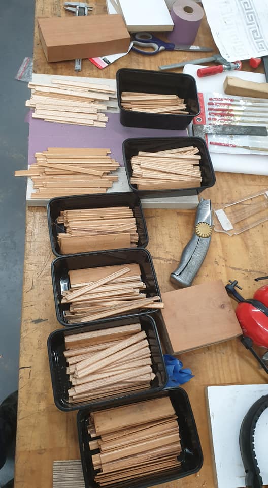

257 rows in there boxes!!

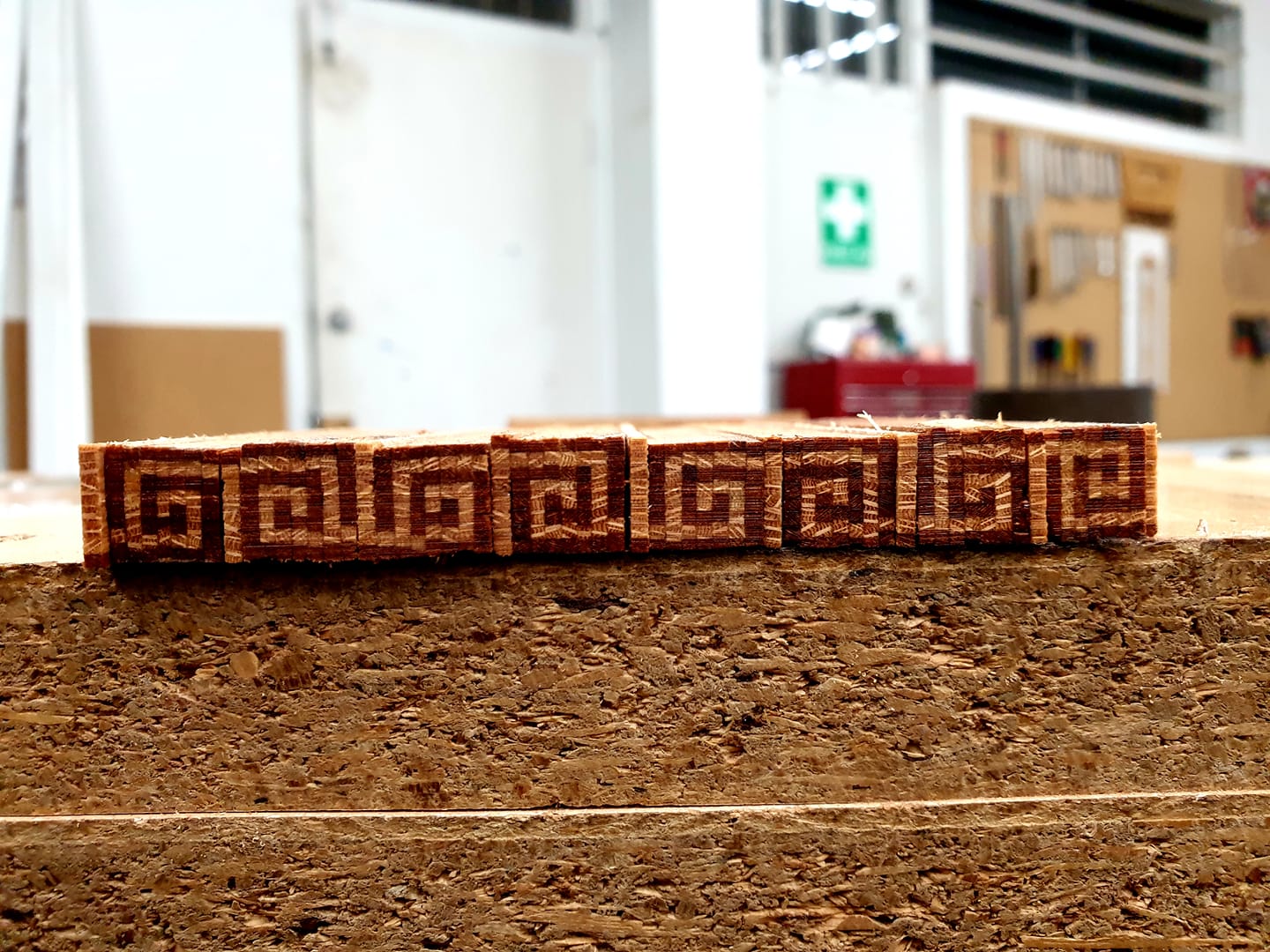

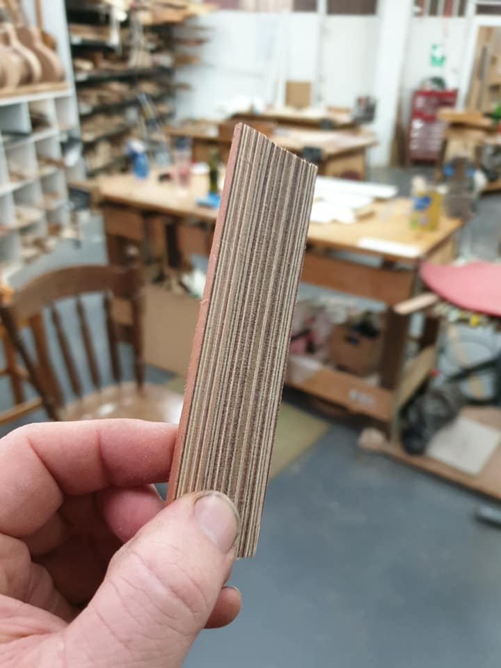

A few tile blocks ready to go

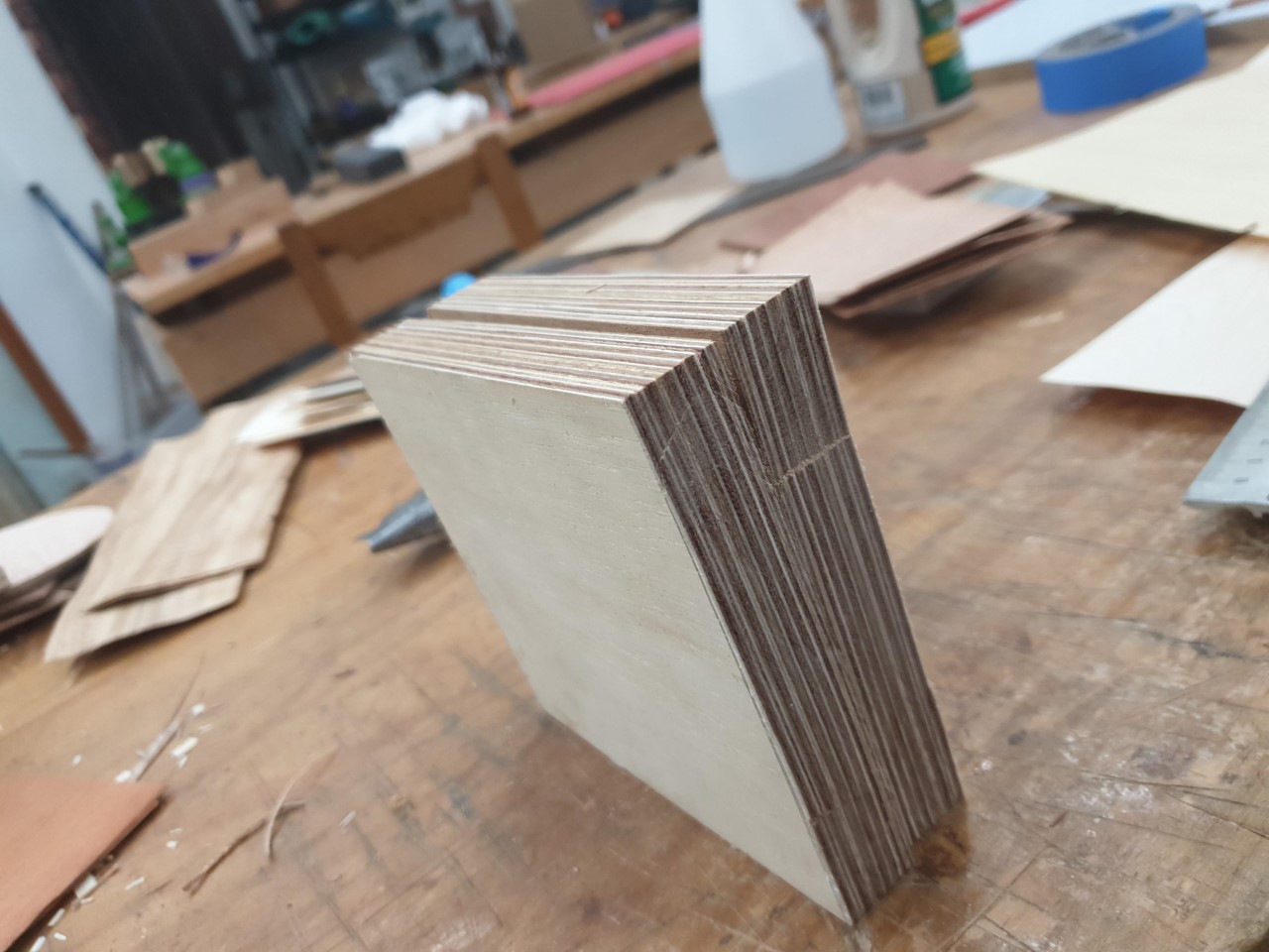

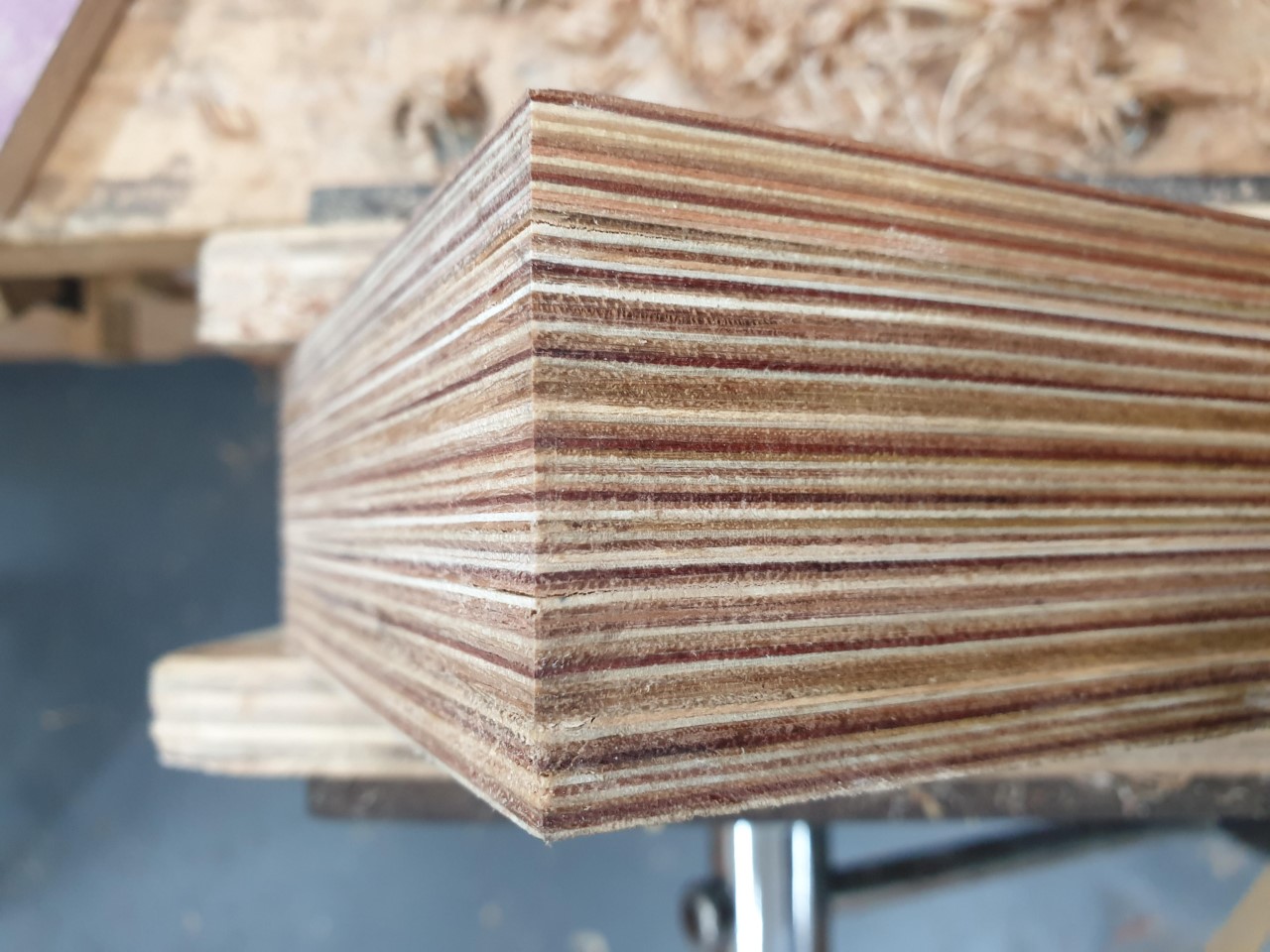

Veneers Glued into a stack
Veneers glued into a stack.jpg (36.56 KiB) Viewed 17933 times
Cut into 3mm Slices

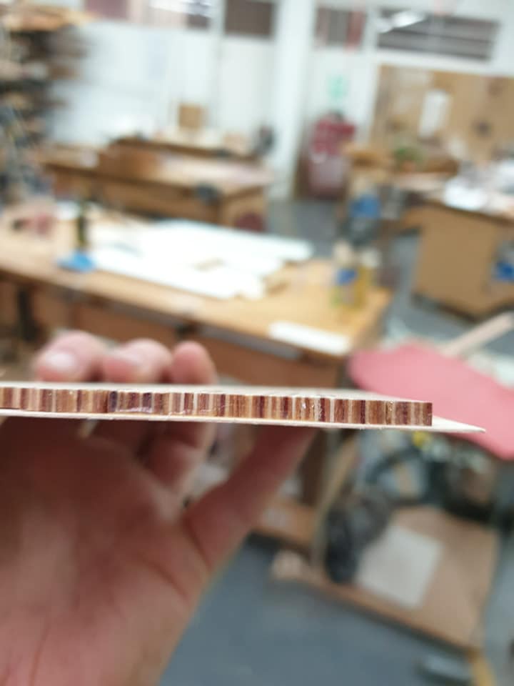

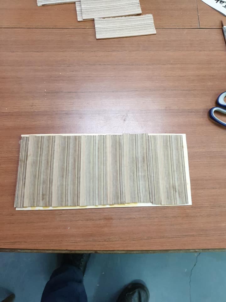

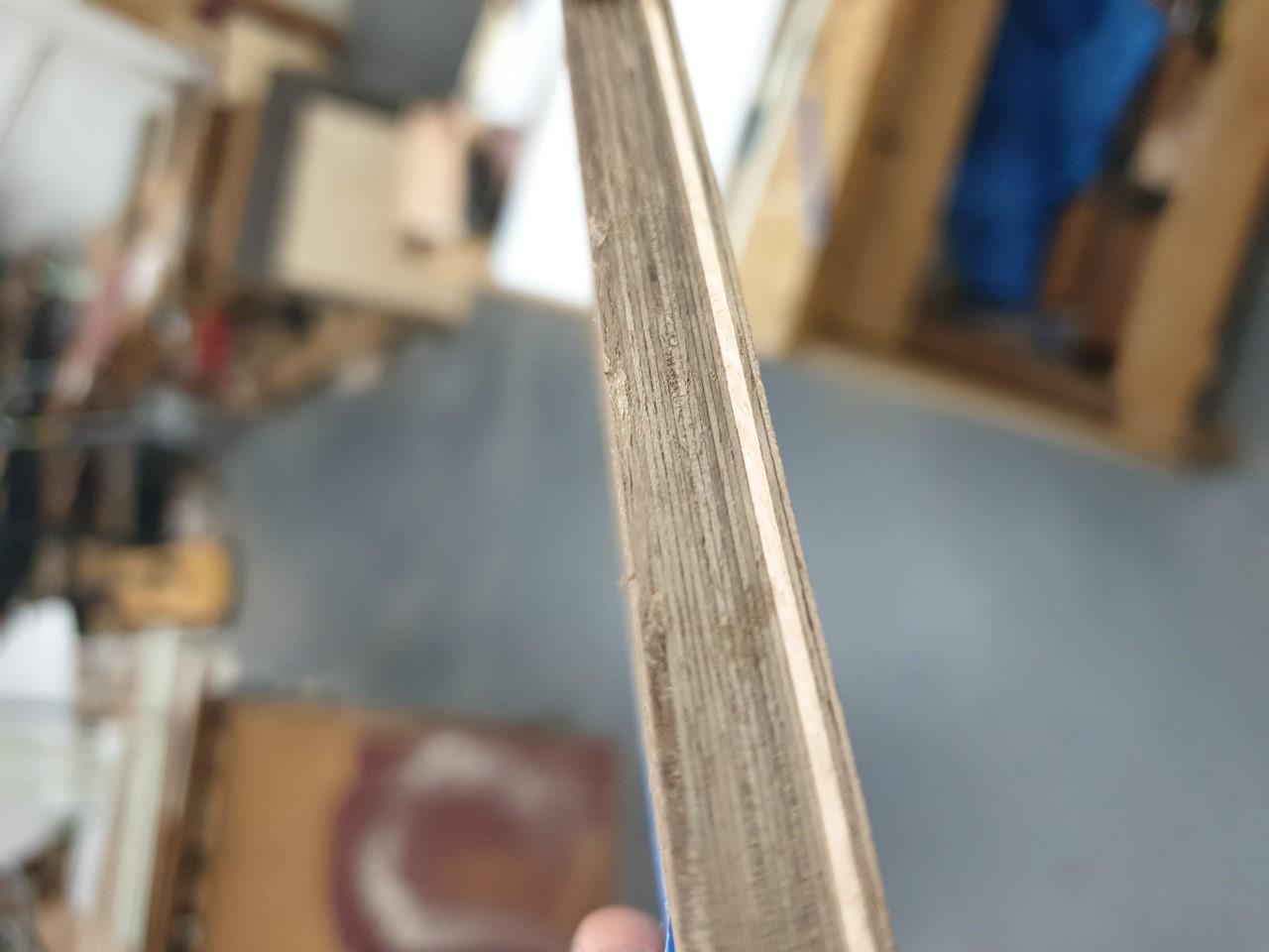

Slices are glued to a veneer
Side view of what it will look like

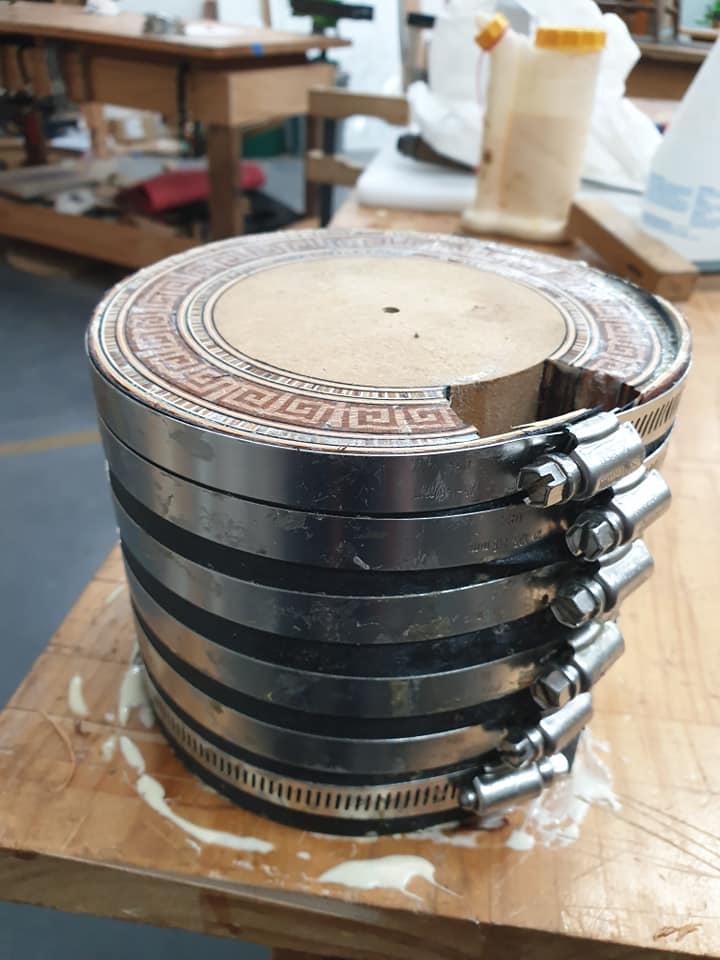

First Layers Glued up

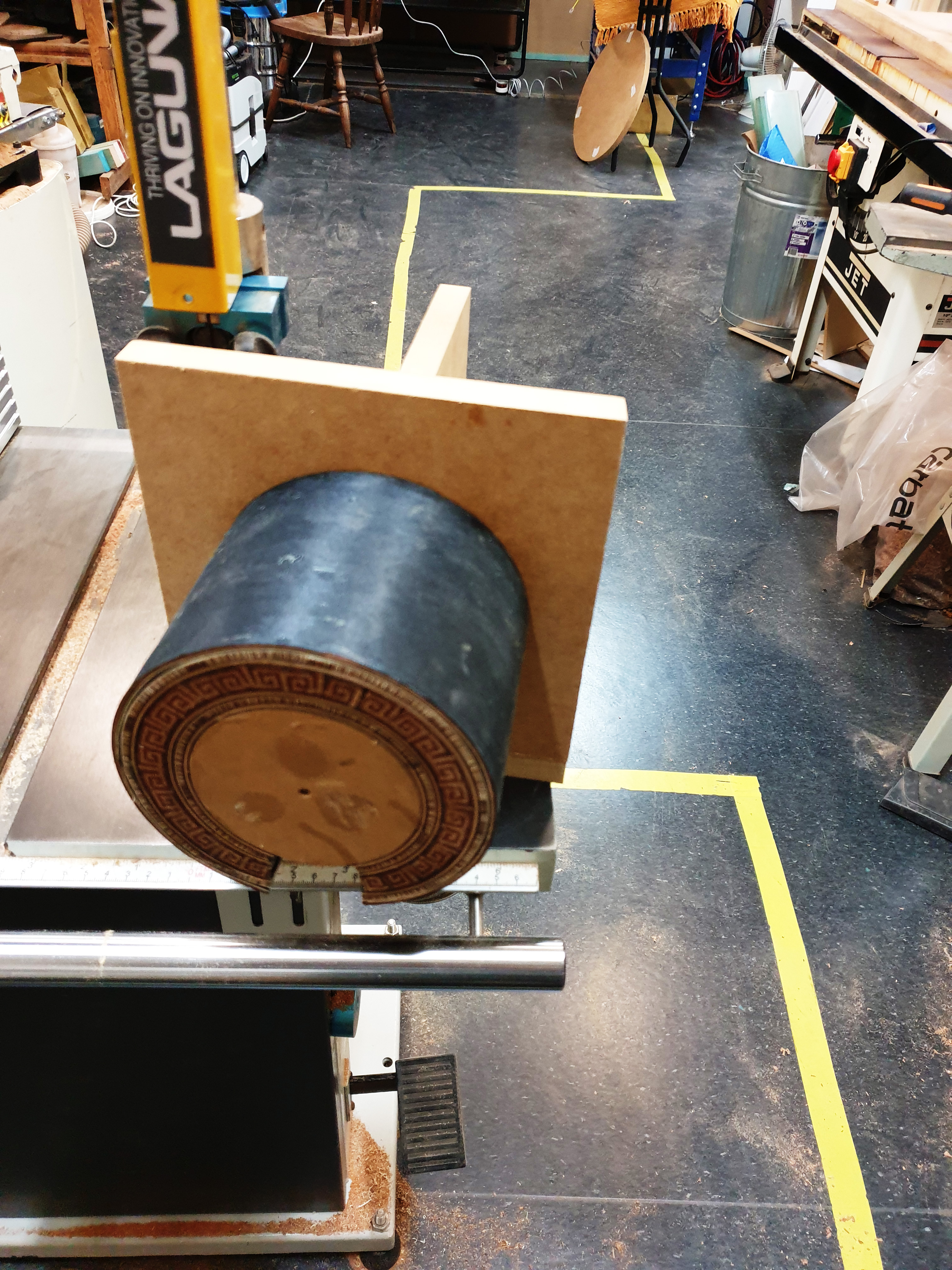

Final Layers glued on the log

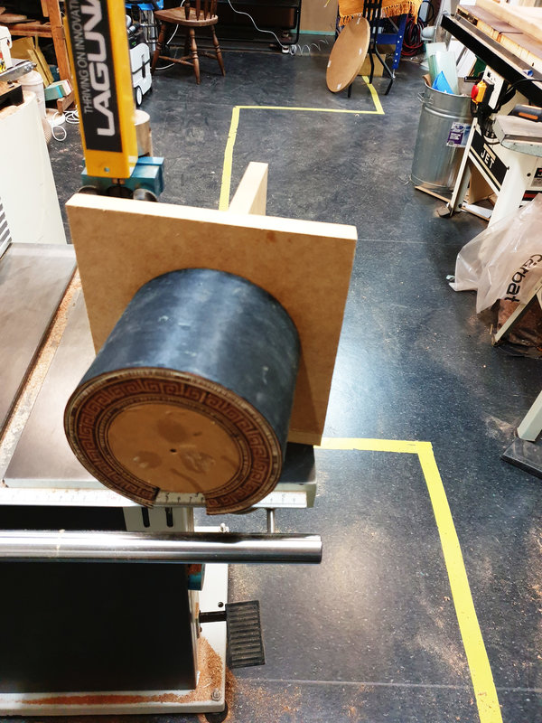

Made a bacon style slicer and super glued the log to it.
26 Rosettes!!!
Final Product
