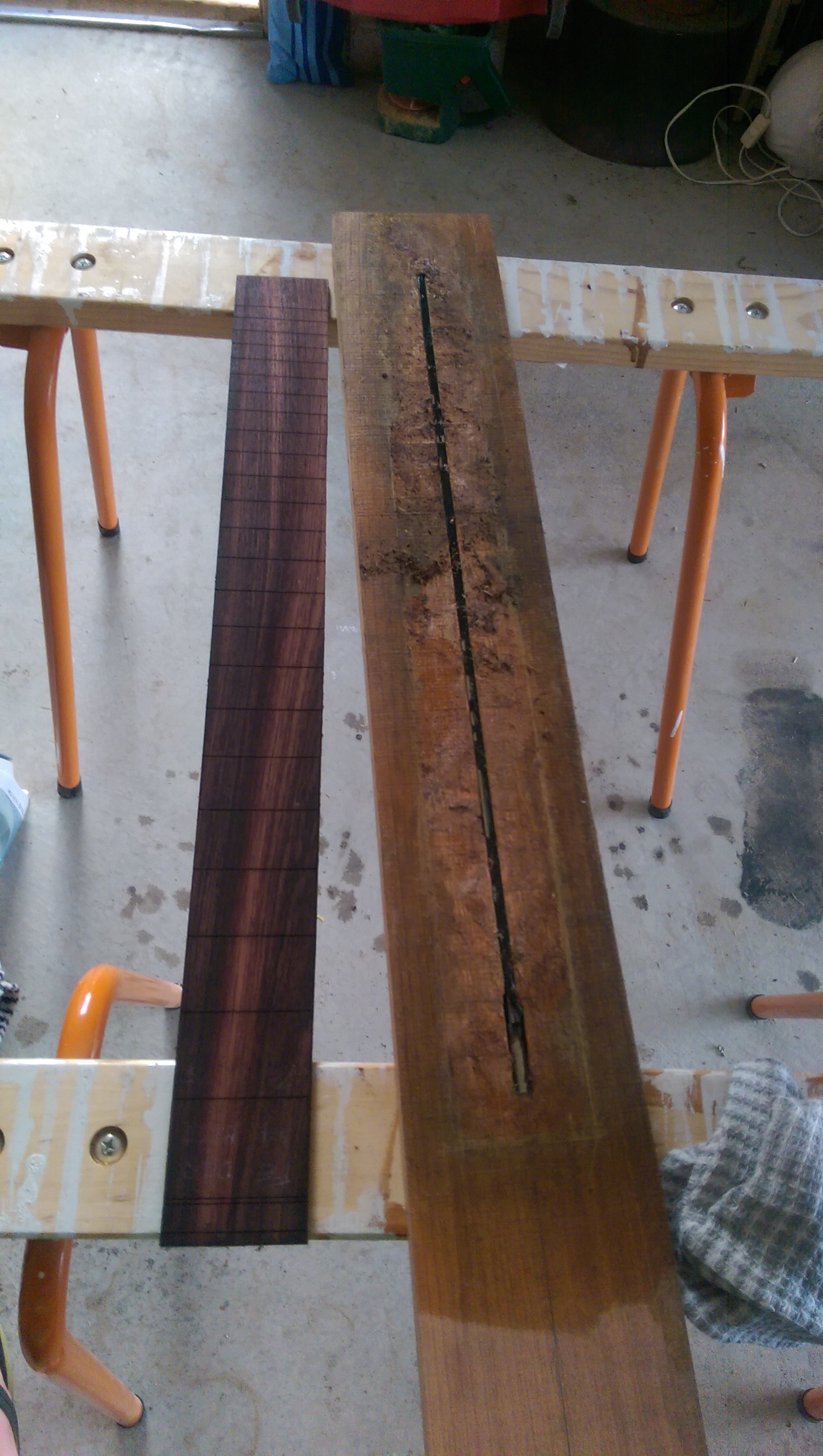

Got the two body halves joined yesterday, truss rod in the neck blank and fret board glued on.
First cock up had already happened though, I used tape to hold the fret board in place while I clamped it to keep it aligned. In clamping it the tape has been able to loosen a bit and now one end of the fret board has moved off centre line by a mm or two. I've got enough meat in the neck blank to make a functioning neck, but the truss rod won't be completely parallel to the neck. Thinking I might need to pull the fret board off and try again. Thoughts?

So that misalignment on the fret board has been eating away at me, so I did a bit of looking around and saw that with a bit of gear I should be able to pry it off and try again, this time with the pins Steve mentioned in another thread.
I was just using a hair dryer and it's feeling like bloody hard work. Some of the sites I saw suggested to use a clothes iron, but I want comfortable with that straight off the bat. Do you guys have any experience with that? Is it safe to do?
Re: Timber supply - WA
Post by simso » Wed Nov 15, 2017 11:44 pm
Clothes iron works just fine, it was my go to tool for about five years for pulling fretboards and bridges

Okay, cool thanks. I'm guessing I should be putting a cloth between the board and the iron?
Post by simso » Thu Nov 16, 2017 12:07 am
Yep, wet one if you want to create steam

Steam doesn't introduce any issues with warping or anything silly to the fret board then obviously? That was part of my fear with it.
blackalex1952
Posts: 775
Location: North East Victoria
Post by blackalex1952 » Thu Nov 16, 2017 1:06 pm
When I remove a fretboard, I use one of those bathroom radiant heat lamps on a mic stand actually. I place it around 18 inches from the job and then let the heat slowly penetrate, keeping a surface thermometer there to keep an eye on the temperature. I use knives and spatulas, warmed over a flame. After heating the tool, I can place it on a scrap of wood occasionally if I feel it might have got too hot. If it burns the scrap of wood, then I let it cool a little. Actually, I now have a feel for it so skip this step. I use craftwood cauls wrapped in Alfoil as heat shields to protect the finish for some jobs as well. I find that the heat lamps give greater control over the heat. The radiant heat penetrates slowly rather than the way a heat gun seems to work, and the job can be left slowly heating while I do something else rather than having to stand there waving the heat gun around. Cheers, Ross

Success! It's off. Two steps forward one step backwards. Ha ha.
Thanks for the help guys. Going to be much happier with it now.

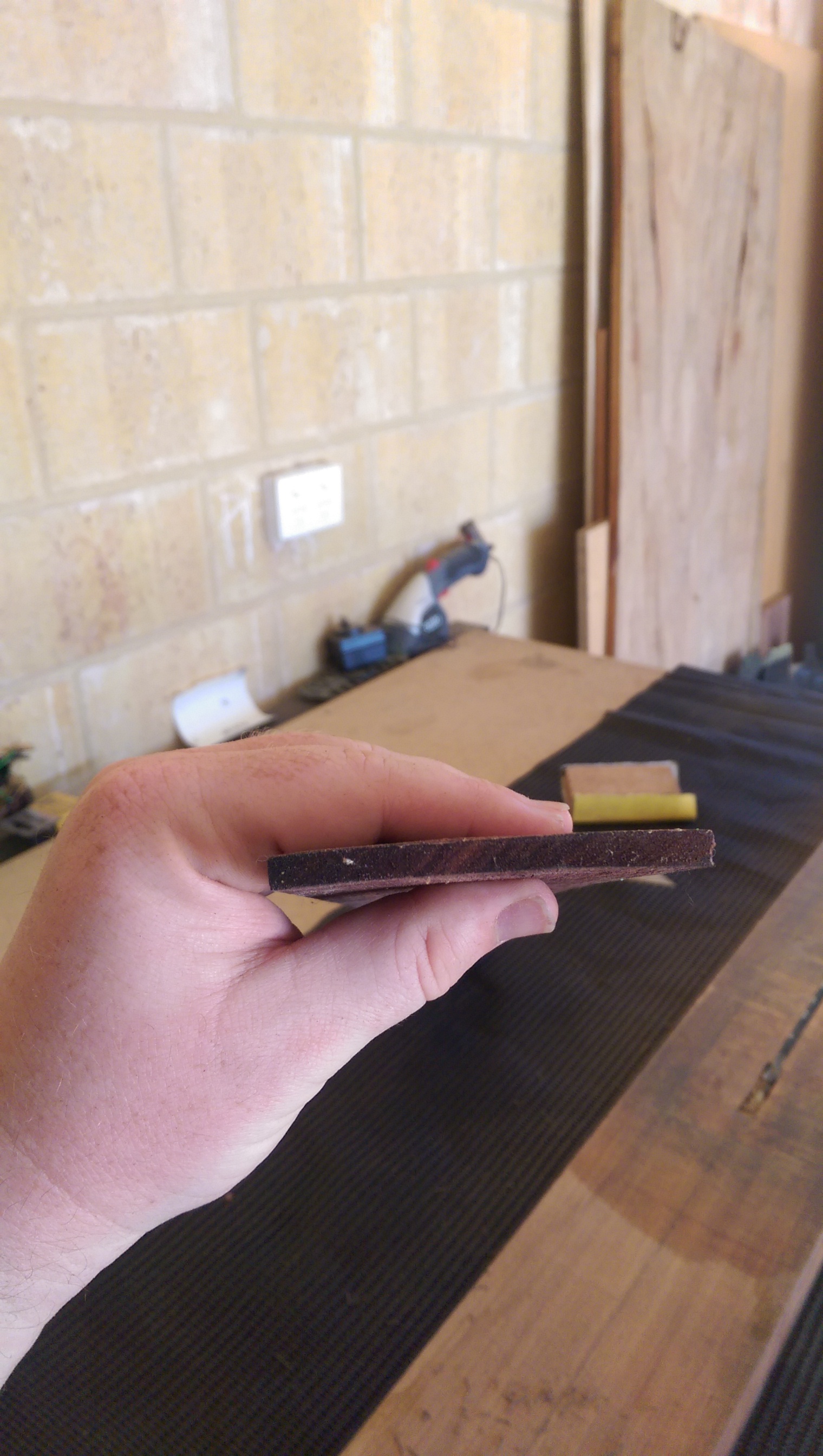

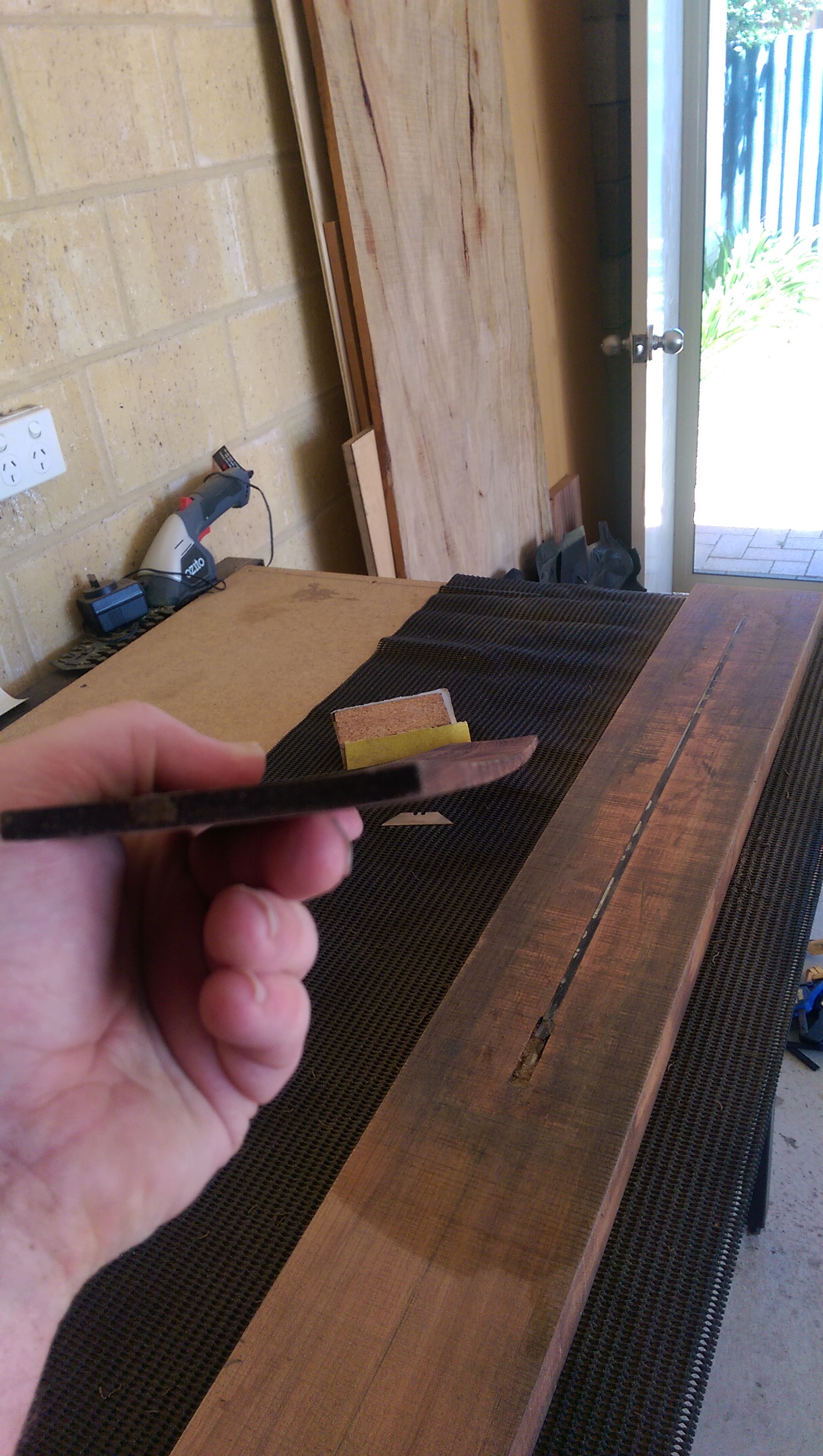

Since I removed the fret board, it seems it's now got a bit of a cup/warp going on. I'm worried that I won't be able to get it to sit flat.
Is there something I should be doing to straighten it out before I reattach it? Or will clamps and glue be enough to pull and hold it in?
Thanks in advance

Can't work out how to edit on my phone. Here are a couple of photos
Post by simso » Mon Nov 27, 2017 3:54 pm
It just the heat thats caused it to warp, wet it and clamp it flat until you need it
