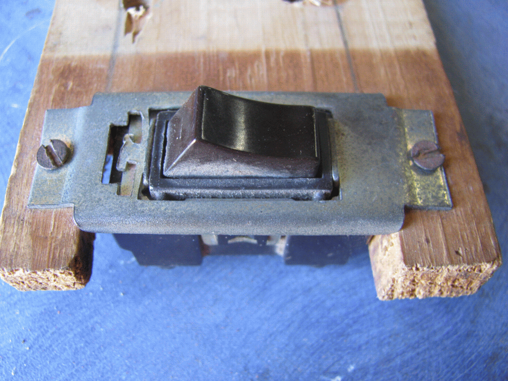

A lot of older machines have poor quality switches and some, like the uncovered bakelite metal bodied 1940's job that was on my Gilbro tablesaw are just out right dangerous.
I knew I should have replaced the switch way back when I first bought the machine and I did look around locally in earnest but he did not have one. :) The truth is that when I was confronted by the hideous price being asked by local suppliers, I decided back then that I would rather die from electrocution than pay the ransom. So I kept using the switch because it worked and as long as I squinted my eyes, clenched my teeth, and kept thinking it probably hasn't actually killed anyone in all these years, I was able to face each 'on' and 'off' event and think of it as an adventure into the unknown...Not real good for the Zen type focus though :|
Here is the switch....Ommmmmmmmmmmm.......

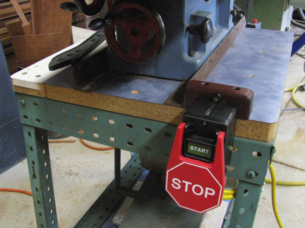

So on with a solution. I kept looking at the neato switch on the old Triton router table thinking I could cannibalize it because I use the TS so much more than the fixed router...but it seemed silly to make one tool more dangerous in an effort to make another more safe. Then I was browsing Rockler, a major tool and hardware outlet in the USA and came across a safety switch they had on special for $25USD. I checked the specs and although it is wired for 110v and has standard USA plugs fittings on each cable, it was fitted with 14 gauge wire and rated at 15amp. Further digging revealed that the switch is rated @ 10amp on a 250v supply so in the cart it went.
The switch is now on my old saw. Life is safe, but at the same time a little more boring:
(No smart arsed comments about the mecano set saw stand please Marty..it works fine, just like the old switch :lol: )
So the verdict, yes the wiring needs to be changed out to suit our 240vsupply but that is a very easy fix especially if you intended to hard wire the switch to a machine because you would then need to pull the switch apart to that anyhow. Yes you could just change out the plug ends remembering that white is neutral in the USA and blue is neutral in AU. But it is only two screws and a simple change over of cables for anyone with proper electrical training. All in all the switch operates very well, a bit of a 'cheapish' feel to the on button where you need to push a bit firmer than you would a $200 switch. But the off switch works well with or without the big plastic 'STOP' paddle and that is all it is, an actuator paddle that can be unclipped easily to reveal a RED 'OFF" button which is a little larger than the green 'START' button. I leave the paddle in place simply because it does work effectively as a 'hands free' fast stop switch. I have positioned the switch so a quick push with the knee is all it takes to shut the saw off and that's a handy thing should you suddenly discover you have no fingers. :?
Bottom line, this Taiwanese made switch is very good quality for the money and I would buy another without hesitation. Big, a bit ugly, but quite effective as a safety stop switch and it is very easy to fit, so it is both burnt thumbs up from me...Image

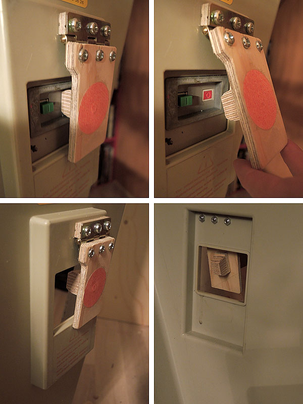

Post by charangohabsburg » Wed Nov 05, 2014 2:17 am
Cheap & dirty solution to upgrade a safety stop switch with a paddle (A modification I have made a few years back. The original tiny and recessed red stop button actually was more often than not a hit & miss endeavor! :lol:
Re: Safety Stop Switch For Static Machinery.
Post by Kamusur » Wed Nov 05, 2014 7:52 pm
Nice large target Markus and it looks like it is non-slip as well :cl
