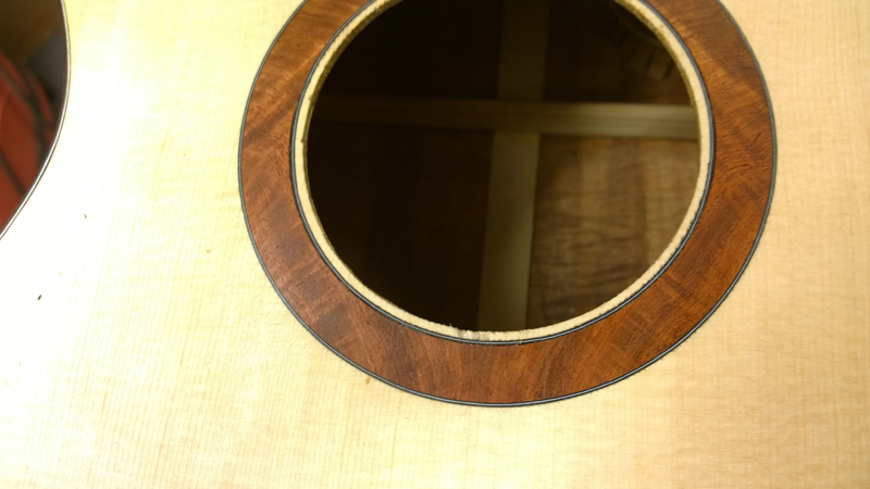

I am closing things up. I spent some more time on the neck profile so it does not look so chunky to me, also it feels good in the playing positions.
I also spent sure all of the bindings are flush on the rims. Filled a couple of gaps. One repair I had to make was to the spruce between the rosette and the sound hole. Somewhere along the line I knocked a bit of it out. Luckily I have a spruce ring underneath so I had a ledge to build up. I shaped a small piece of spruce from the cutoff to fill the cleaned up chip and glued it in with hot hide glue. It is hard to see the repair.

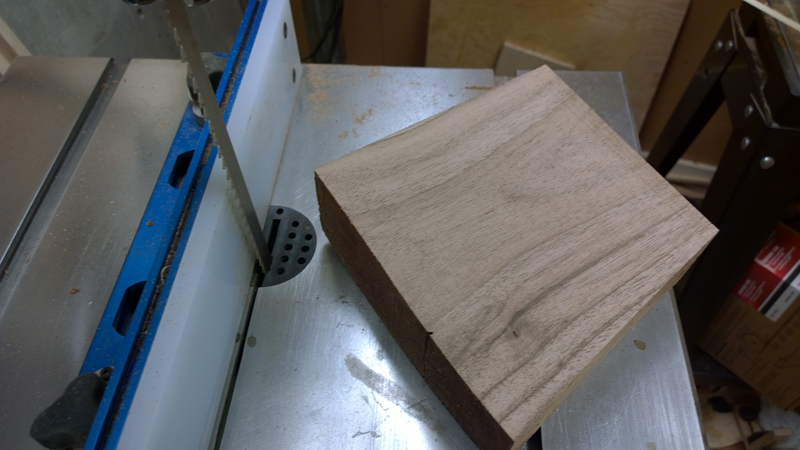

While I was waiting for the glue to cure I sliced up a block of walnut to use when I make my bridge. As in the book I will make a carbon fiber reinforced bridge and will ebonize the walnut. I will start rusting some steel wool tomorrow to make the solution. I never tried it before so it should be interesting.

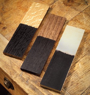

I've no idea where in the US my American Black Walnut comes from, but it's not short on tannins. And I guess "black" is in the name for a reason. Clearly, it can vary by piece and if the piece you have is lacking, it's possible to add more just by pre-coating with hot, strong, Irish tea. I guess other types of tea will work too.
Here's an article on ebonizing:
http://www.popularwoodworking.com/techn ... izing_wood
but this has a tendency to produce the jet black painted look which is not what I prefer. For tannin additives, there are many sources, from common tea, to tannin additives you can get from home brewing shops, to good old common wattle bark, which, apparently, used to be a major source of concentrated tannin.
I had to use tea on one stick of walnut I had, but the rest I've used "straight". I also found the whole process quite temperature dependent, which is also a means of colour control. Compared to the dyes I tried, I get much greater penetration. The result is sandable, which it never was with the dyes I tried.
Here's a pic that came from the original popular woodworking article:
"Different woods, same result. Three samples of ebonized wood (oak, walnut and maple) showing color consistency with the stain the grain variations being prominent".
This stuff paints on as a clear solution, so the chemical reaction happens in the wood, which is why it's sandable, providing you don't go mad!

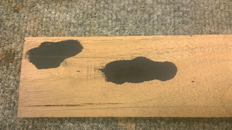

I have two solutions started, one vinegar with clean steel wool, for the second I started to rust steel wool. I will add vinegar after it rusts.
We shall see in a week or so. I have a lot of scrap and my wood looks the same as in the picture, so I am hopeful. I can try tree bark or black tea as a second option if my results do not look good.

The walnut I have will ebonize just fine, that is it has enough tannin in it. I started two batches of vinegar/steel wool one with an absolutely new and clean (I worked to wash out any oils) steel wool pad and the second with a steel wool pad I rusted with salt water and then washed out. The streak on the left was three days of one pad of 0000 steel wool in a quart of white wine vinegar, the right pad is two days of a somewhat rusted steel wool pad in a quart of vinegar. In both cases the steel wool has not dissolved even close to all the way.
The wood stained very quickly and is quite dark.
