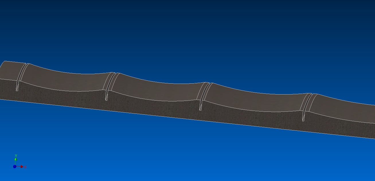

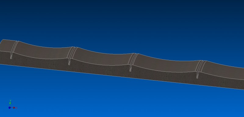

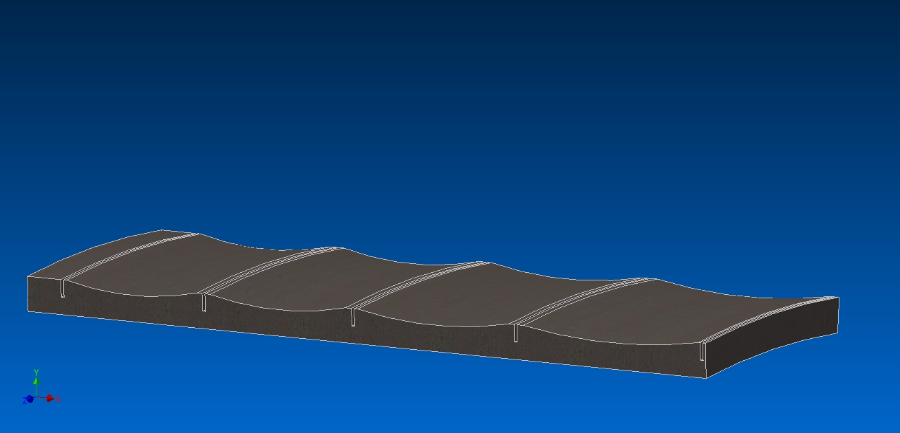

simso wrote:Not an easy one is it, I have cnc as well, but its actually rather tricky on this front as well
Not altogether impossible Steve,
here's a really quick bit of modeling (about ten minutes) I did in Inventor to model a short length of scalloped fretboard. There is actually a decreasing distance between fret slots to simulate a real life board but just doesn't show up in the images.
No particular accuracy, just wanted to see if I could model the scallop, the board has a 12" radius and scallops are a constant 1.5mm depth from the front face. I was going to then import it into Edgecam to generate a tool path but unfortunately the laptop I'm on runs into trouble accessing the license server so I couldn't fire the program up but I've done many hemispherical shapes using a ball nosed tool so with a bit of time I'm sure it could be done.

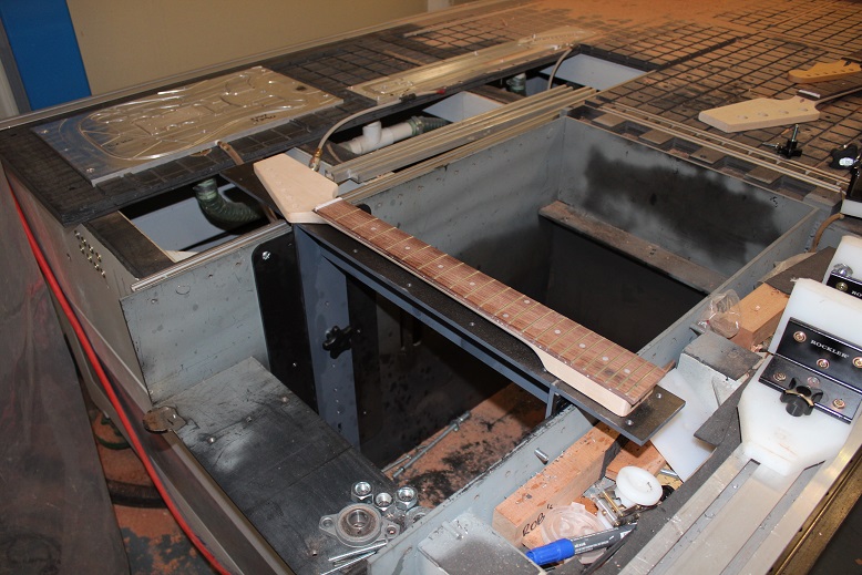

What trouble are you having using the cnc?
Im about to do a bunch of scallops on multiscale fretboards. Not only are they curved and decreasing in width, but angled AND different lengths (the scallops do not cover the full width of the fretboard). Im not expecting any issues. If you can draw it, its pretty much done.
What software are you using?
This is how i do mine:
https://www.facebook.com/ormsbyguitars/ ... nt_count=1
