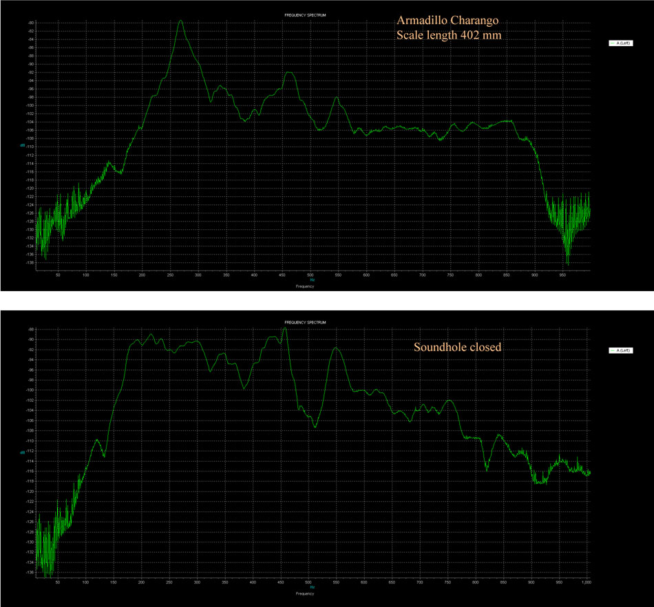

Post by charangohabsburg » Wed Aug 05, 2015 11:42 am
Spectrograms of this charango with opened and closed soundhole:
