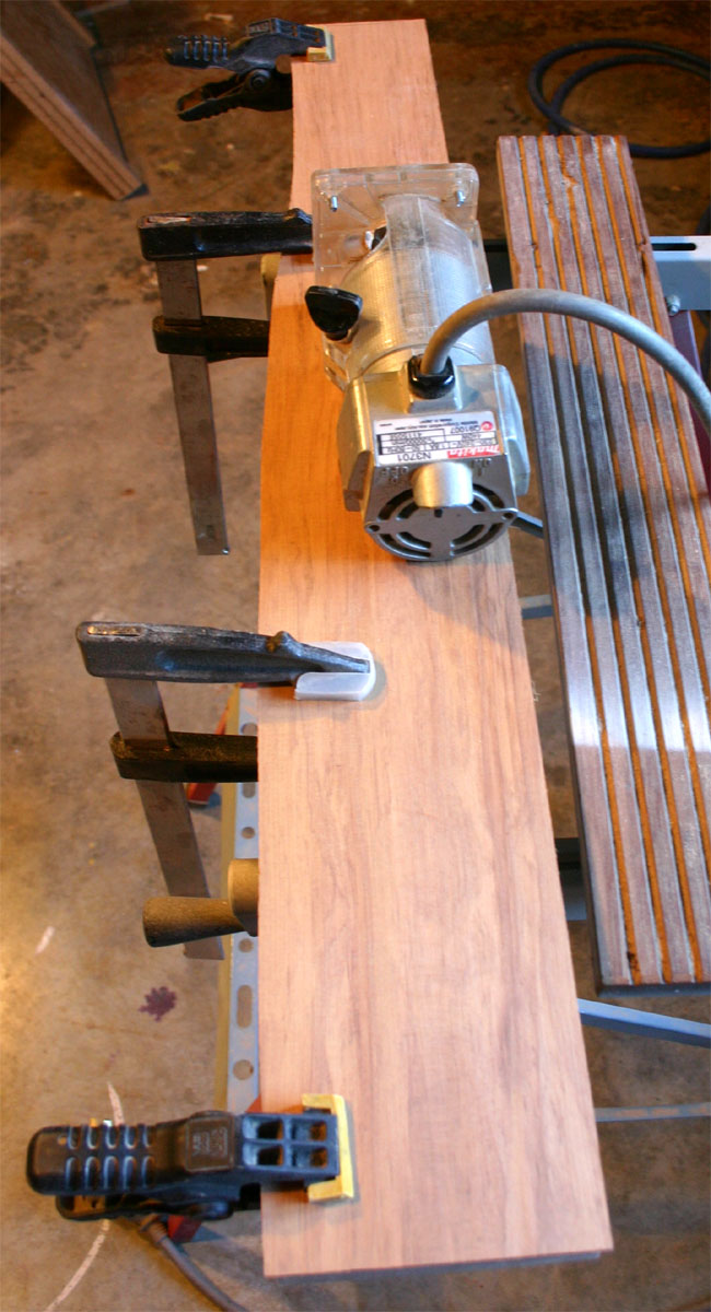

Is that a 45 degree chamfer bit is the trimmer Christian?
Col
christian
Posts: 338
Location: Bay of Islands NZ
Re: Build Thread: 000 Koru kahikatea/Heart Rimu.
Post by christian » Tue Jul 30, 2013 3:01 pm
yes a 45deg bit.

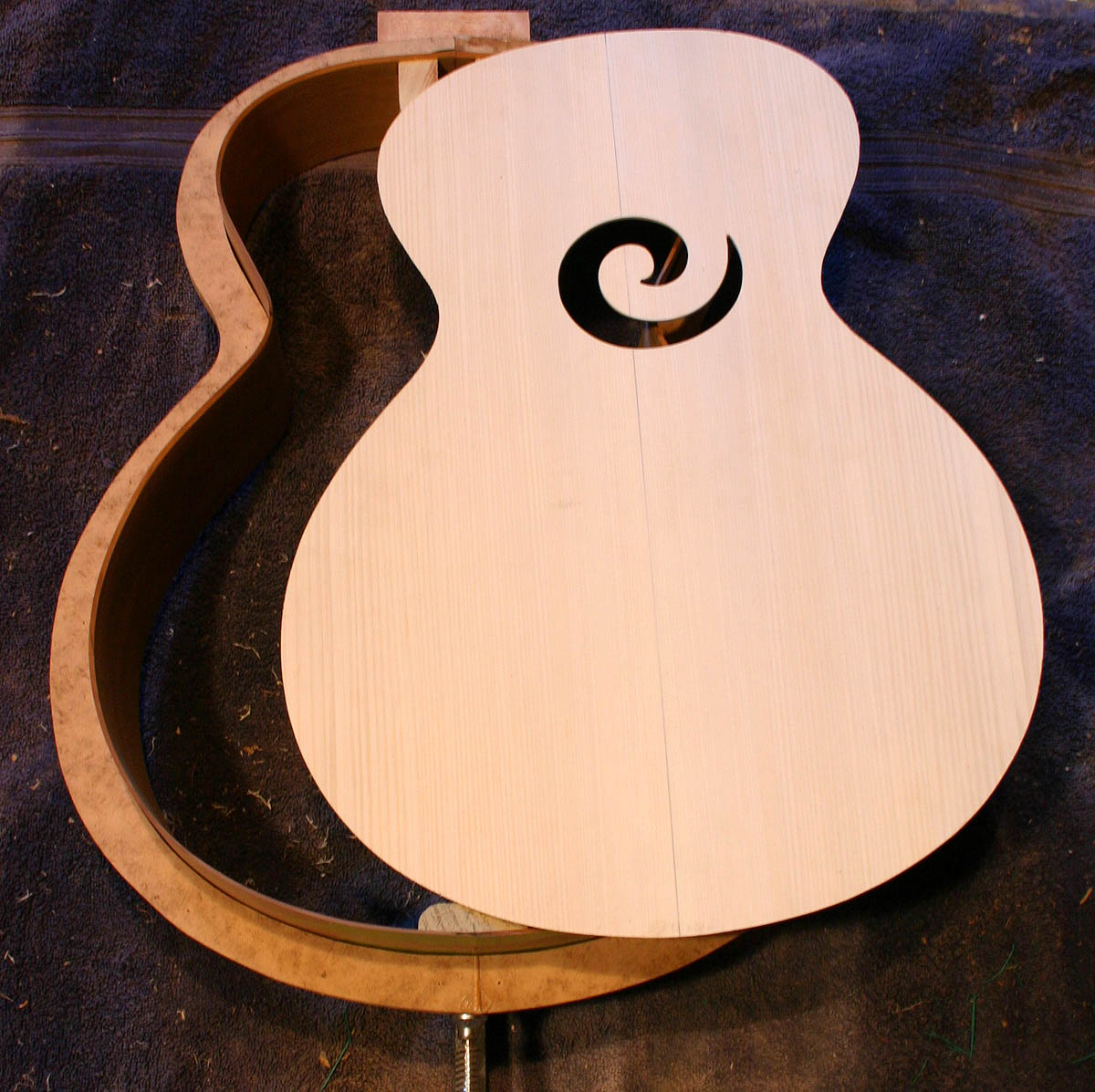

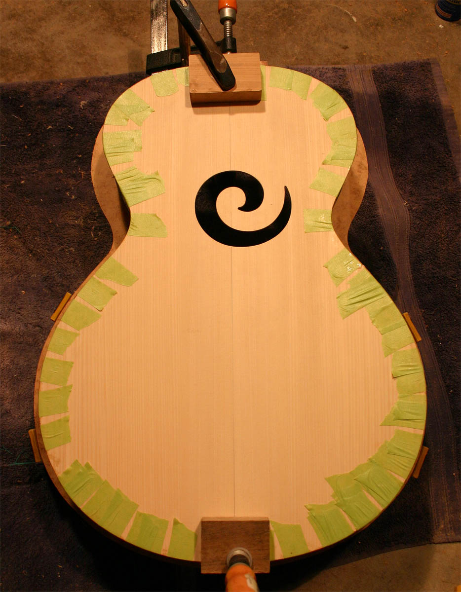

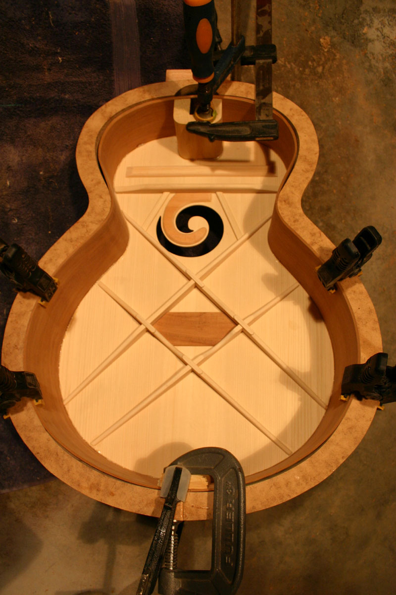

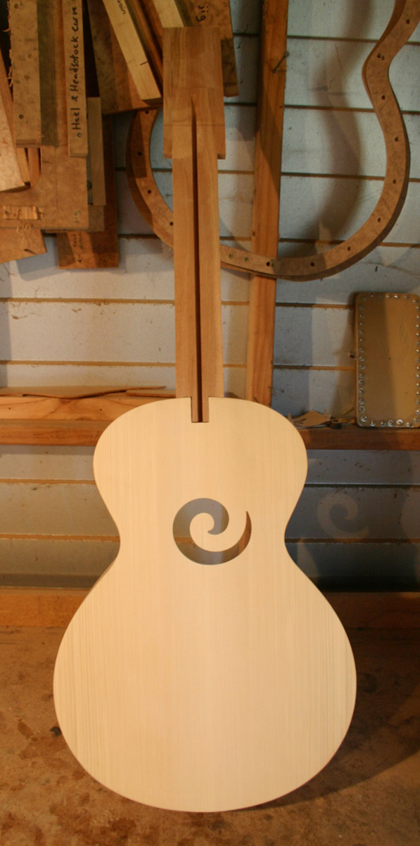

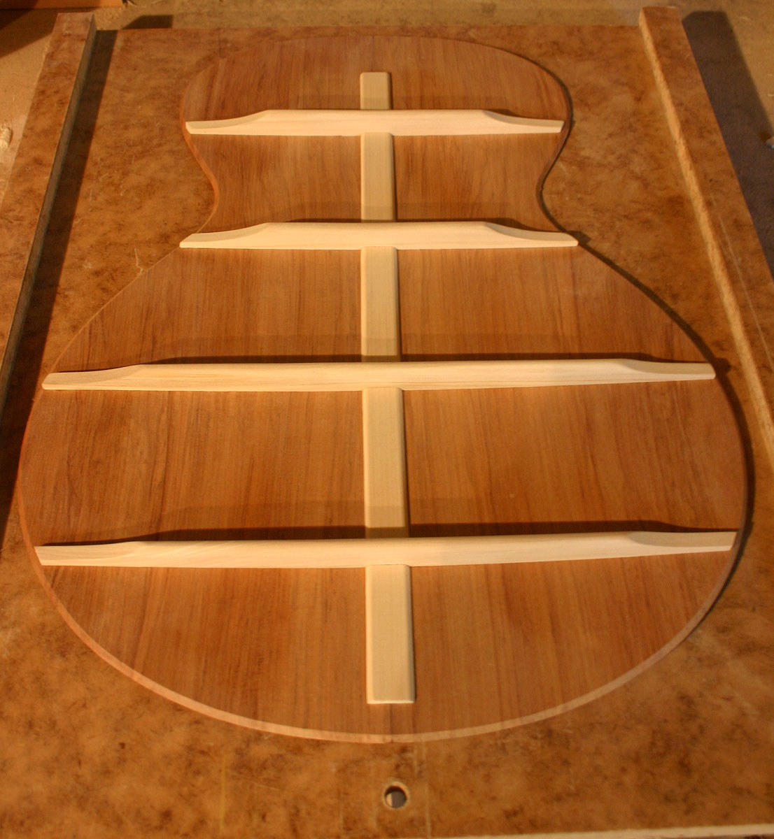

The next 10 pics are the sequence to cut out the koru soundhole and top bracing.
Christian

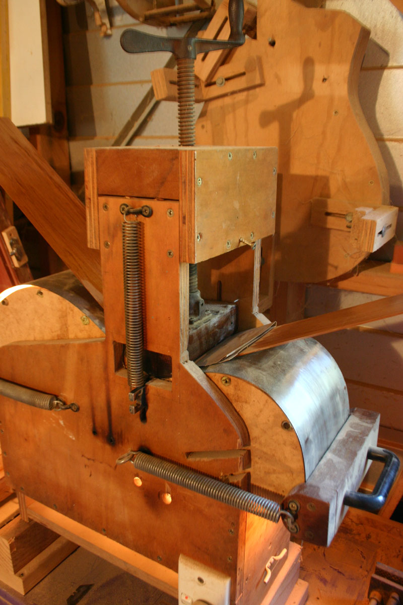

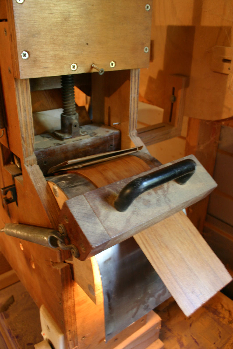

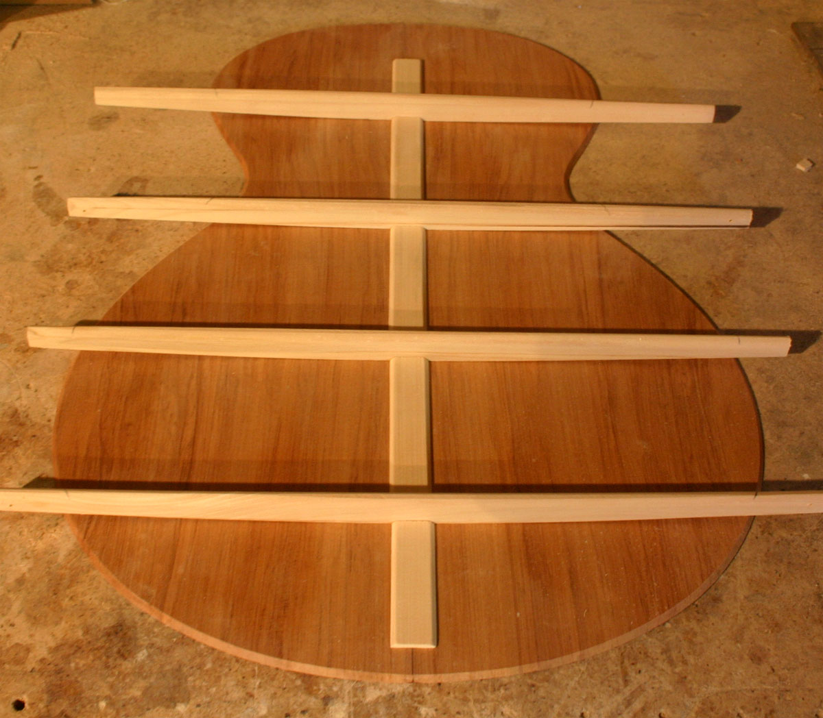

The next set of photos are of the back being braced, and the sides machined and bent on the trusty side bender.
Christian.

christian wrote:
Now that is the most interesting soundhole I've ever seen.
How creative! How will you trim that...if indeed you do?
christian
Posts: 338
Post by christian » Wed Aug 07, 2013 12:10 pm
Hi Steve,
Thanks, for the comments.
Indeed no trim on this one, pure form.
Christian.

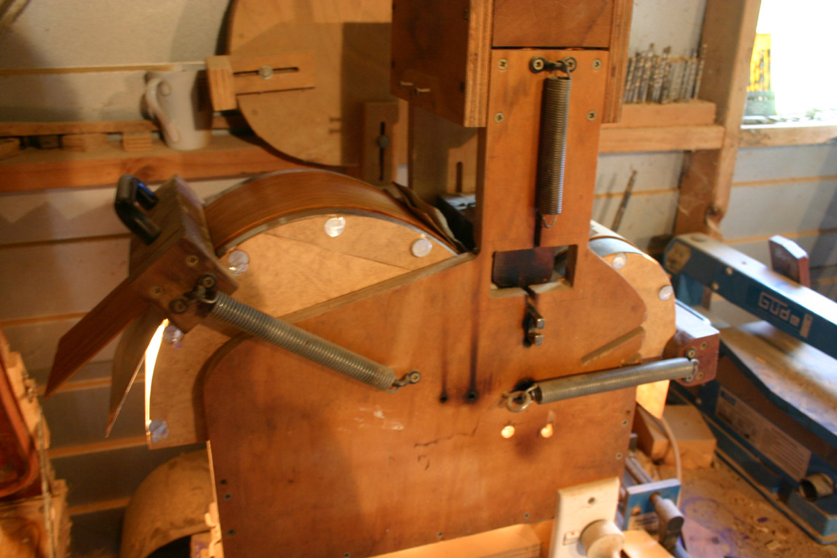

Two questions, Christian.
1. Do you add linings to the top and back? seems a really small glue area to hold a vibrating top....
2. Is your side bender using light bulbs? And, if so, how many. I've got 4 outdoor spots at 150watts, that get hot as blazes, and I'm not using for anything. I'd have a go at a side bender if you thought that much would do the trick, tho I do love bending on a hot pipe......that may have sounded wrong. I meant a bending pipe.....

nnickusa wrote:Two questions, Christian.
Christian, it is interesting having no kerfed linings - It looks like it would go together easily but I suspect it isn't the case. Nick, I just made a small LB bender for Ukuleles and I used 540 watts, it gets damn hot and worked well to my surprise, so I think 600w will do the trick.
Col
christian
Posts: 338
Post by christian » Tue Aug 13, 2013 8:08 am
Hey Nick and Col,
I do add pre bent linings they are very thin only 2.5mmx 10mm
you will find you don't really need much in the way of a lining if you don't have binding or purfling to worry about.
yip my bender has light bulbs three 150W. I found by lining the area with tin foil it heats up my steel slat super hot really quick. I only use the bender because I'm lazy, if you are competent on a hot pipe just stick with that.

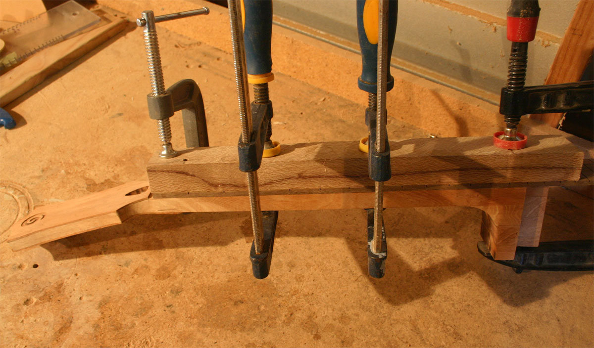

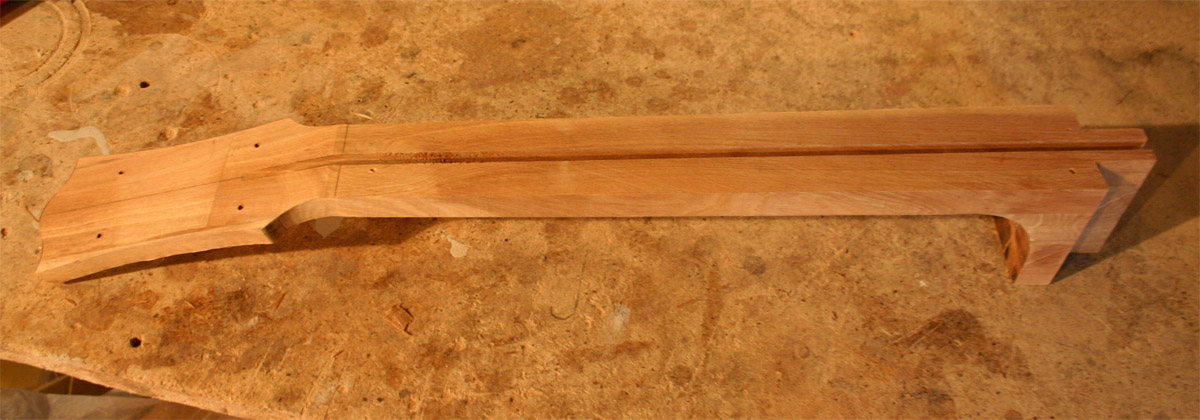

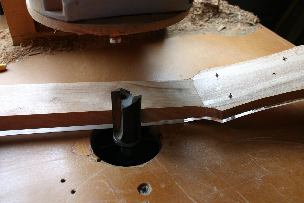

Post by christian » Sat Aug 17, 2013 7:27 am

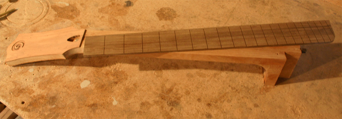

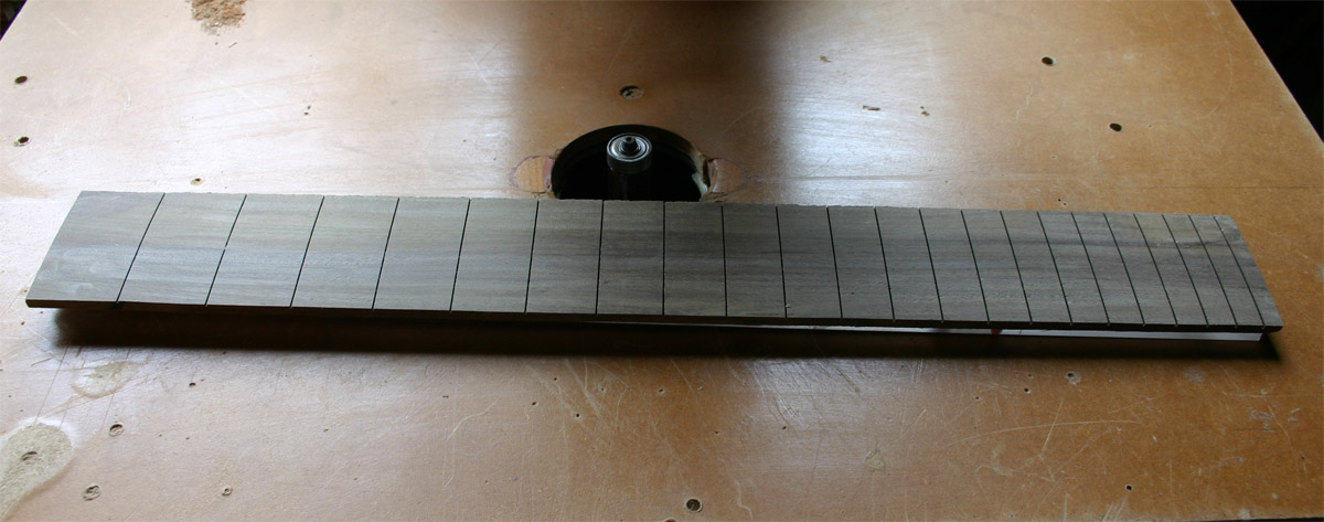

The next few pics are the shortened sequence of the Rimu neck construction and fitting.
Christian.
