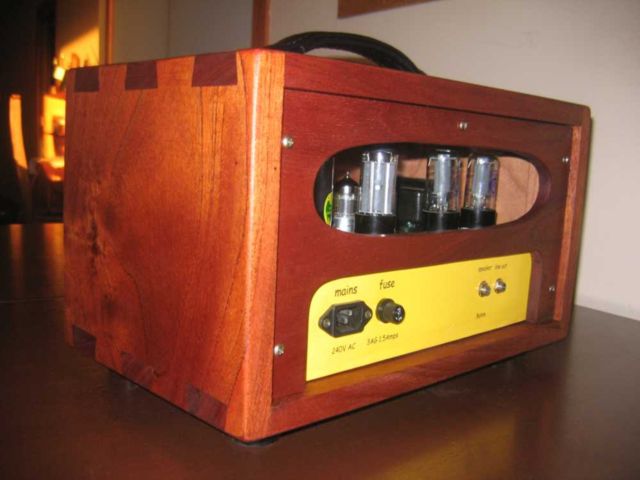

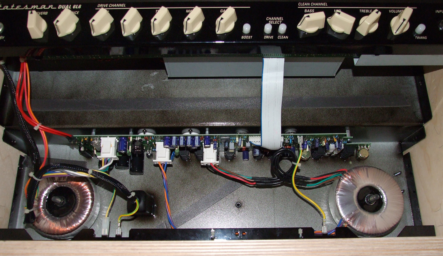

Hi Stu,
It so happens I have a few pics of it at work!
Thanks,
GregL.
Thanks,
GregL.

Re: Anyone had a similar valve amp issue?
That's really Nice Greg!! I'm thinking dovetails are the way to go visually (if I go down this head building path). Are these hand cut? or machined via table saw/ bandsaw/ router?

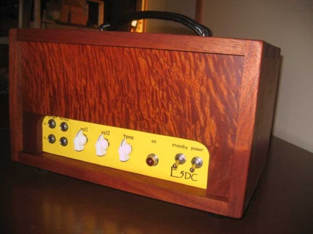

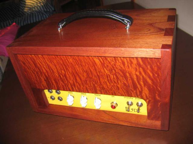

Hi Stu,
Hand cut dovetails.
I'm afraid I'm old fashioned, I don't have any digital devices in my electric guitar signal chain - guitar -> valve amp.
Hand cut dovetails.

Very cool. There's nothing wrong with that at all...

Might have to be a tolex affair on baltic birch ply, Greg, as the hard wood I would liked to have used is no where near dry enough...
- Posts: 146
- Location: Perth, WA
Wow, that amp is classy, or should that be Class A? Very nice indeed.
Ken

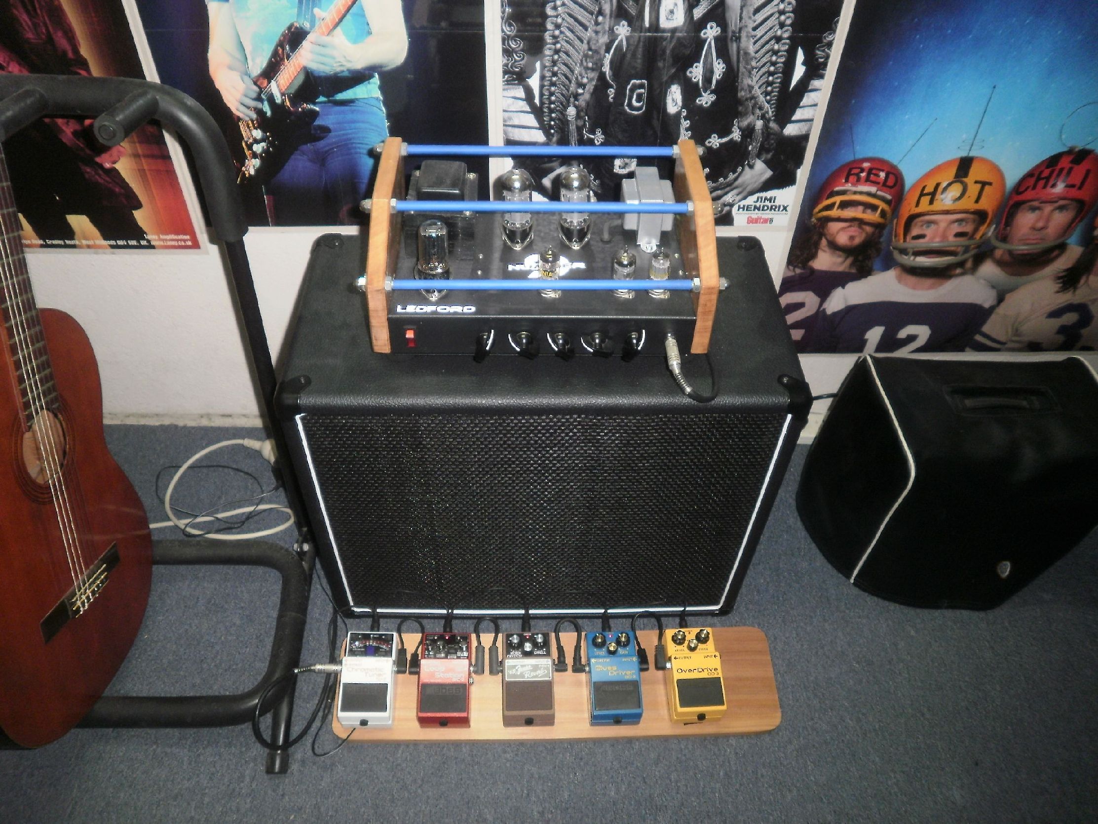

G'day Stu,
I have a similar hand built amp to GregL. It was made by Duane Ledford in Sydney and is nine watts running 6V6 power tubes and by changing the rectifier it could pump out 22 watts. The circuitry in this amp is first class and the amp is noiseless even when you crank it, however at certain frequencies there is harmonic valve rattle. It is just noticeable but in a more powerful amp it would probably be very noticeable. I think the rattle goes with the territory and something that most valve amps experience. I could be wrong there only speaking in my experiences. It is a beautiful, tone full, responsive little amp and I love it!
Just sharing my experiences.

Thanks for the tip Alan, That is a nice setup you have there.

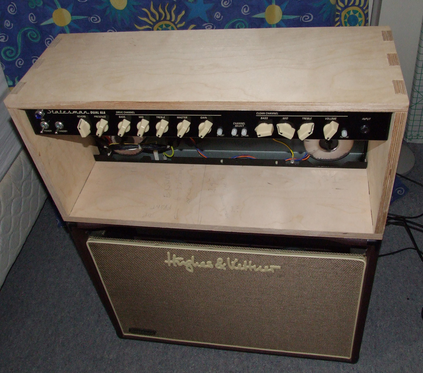

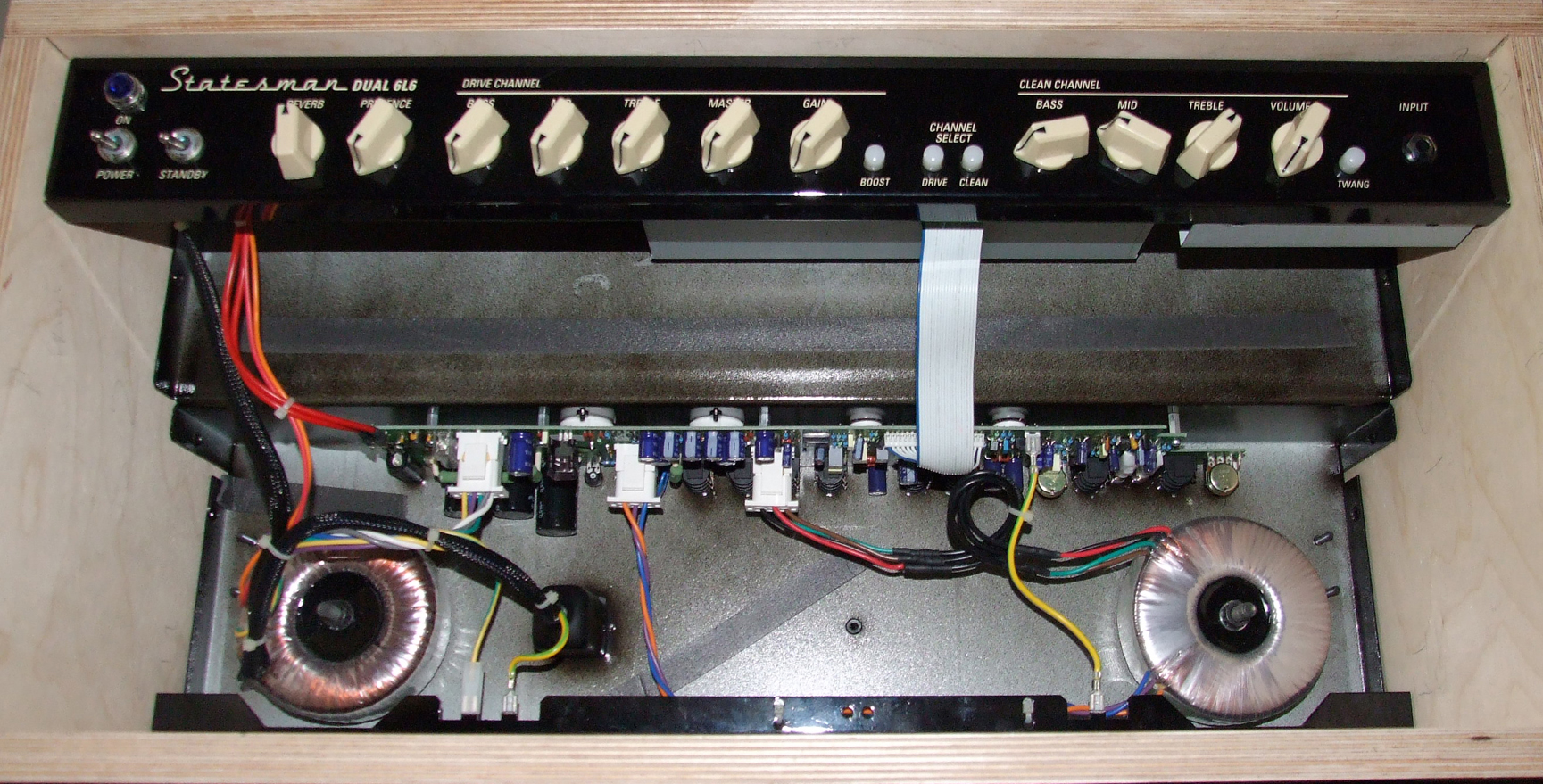

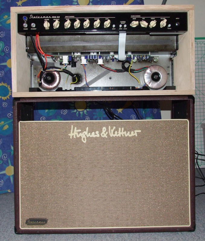

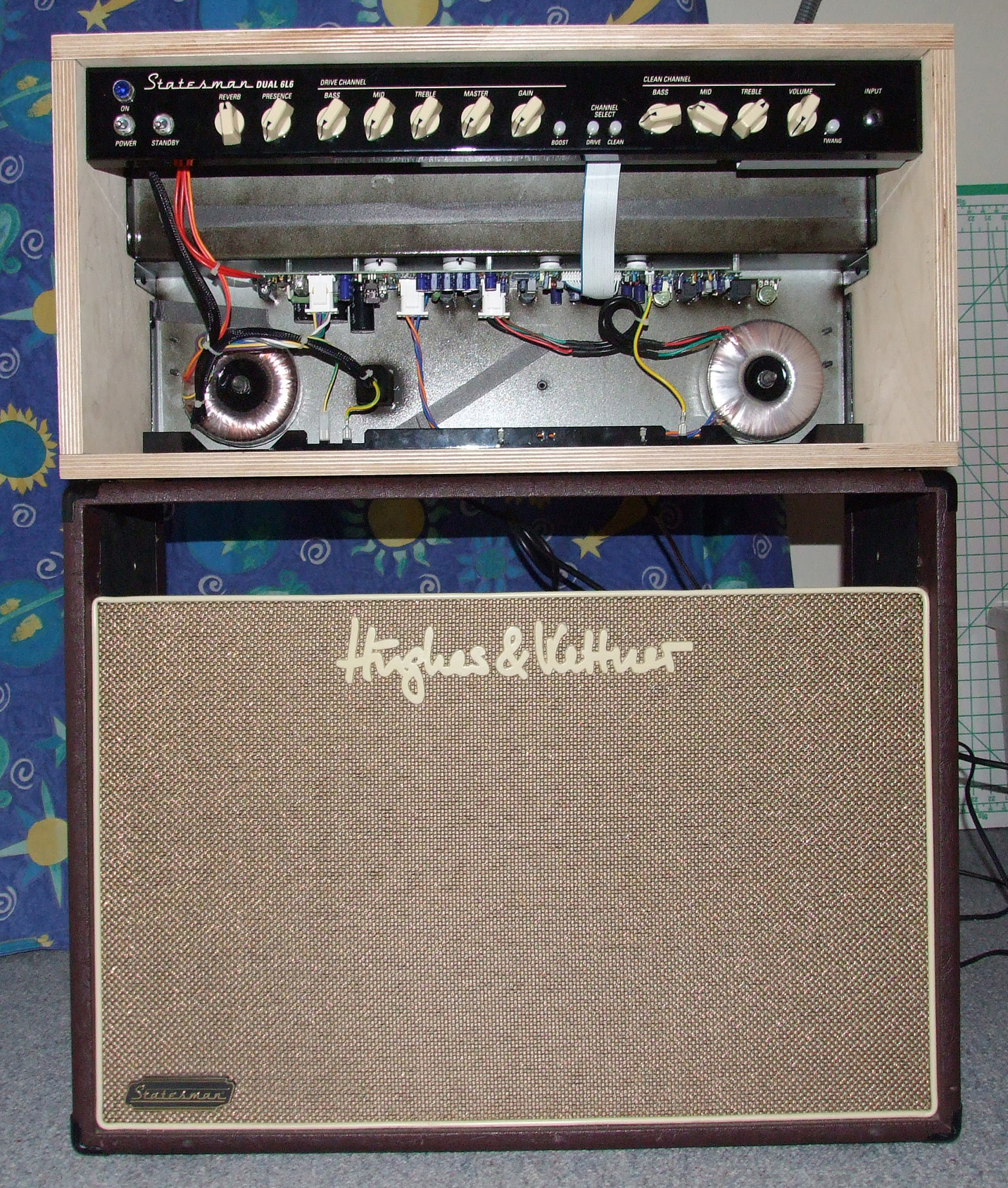

Just a quick update:
I put the valve head from the combo amp into a separate cabinet. This has eliminated the rattling issue entirely up to about 75% volume (60 watt amp). Prior to the mod I couldn't get it past 20% without rattle. It looks a bit silly but it works...Sound file to come in a few days. Still needs glue, sand and polish and I need some advice whether to seal the back of the speaker cabinet to avoid the sound from spilling out the back of the speaker cabinet.
Nice clean job Stu and can be taken back to it's original combo state if you decide to sell further down the line and new owner want's it back as a combo. Mind you, that cabinet should have been constructed of flame Maple, Blackwood bindings and internal spruce bracing at least!
Hi Stu,
Looks fine!
75% of a 60watt valve amp should be loud enough! If you need it louder, get more speakers. Try not placing the head on the speaker box, maybe even less rattling?
Depends what music style and what sound you're after. Open back (ie unsealed) is *usually* for less distorted, cleaner styles where the slight "floatiness" of the sound is an asset. Closed back (ie sealed) is perhaps more "constrained" and more controlled by the sound of the amp.
Ever notice how hard it is to verbally describe sounds?
Thanks,
GregL.
Looks fine!
Thanks,
GregL.
