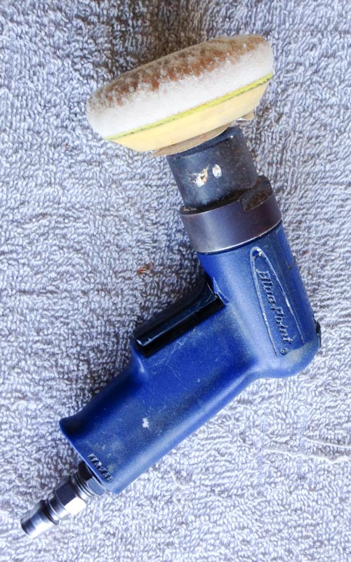

The mini buff I used is called a pistol buff in the automotive trade. I have the Snap-On brand one that will set you back a bit more than the cheap outlet store one, but I use it every single day, sometimes for hours at a time in the day job, and it just goes and goes and goes.
The pads are the hard white ones by Farecla for the buff out, and I'm using the 3M Perfect-it buffing compound. A very little goes a long way. Much less than you see in my tutorial.
I changed from the Autoglym compound because this new 3M one works far better, and the Autoglym seemed to separate and go bad well before I got though a 1/4 of the bottle.
If you get the combination of compound, speed of buff, and pressure on the pad right, the finish will come up like glass in seconds. No need for finer compounds or glazes. Slower speed works better than high speed.
I buffed out two ukes a couple of days ago in less than 15 minutes for the pair.

Could you give us a picture or a link to the Snap-on buff you use, Allen. I had a look at the Snap-on site, but couldn't find a mini/pistol buff, and I'd like to see what one looks like.

I use one of these with the pad Allen suggested above. It is cheap and works well.

If it's lacquer you are buffing, then there is no need at all to sand finer than P1500, and I only go that fine when I can't find a piece of P1200. If you are using a 2 pack product, then it depends on how hard it is on how fine you need to go. We use Glasurit at the Panel shop and we only sand out to P2000 in most instances. But it's pretty bloody rare that you ever need to go finer than P2500.
So for the Mirotone that I use, I wet-sand to P1200. The finish before sanding is already better than most factory instruments, but then again, I'm pretty good with the spray gun. Use the pistol (mini buff) with 3M Perfect-It compound. Minutes later it's like glass.
It's the combination of using the right density of pad with the compound along with the correct speed and pressure that gets the finish up nice and glossy very quickly. It's a bit like dancing. No one can tell you how to do it. You just have to practice.
Here is the picture of my buff.
And a couple of ukes that I buffed in under 15 minutes Sunday morning. Crappy photo as it was late this afternoon when I got back out in the shed.
