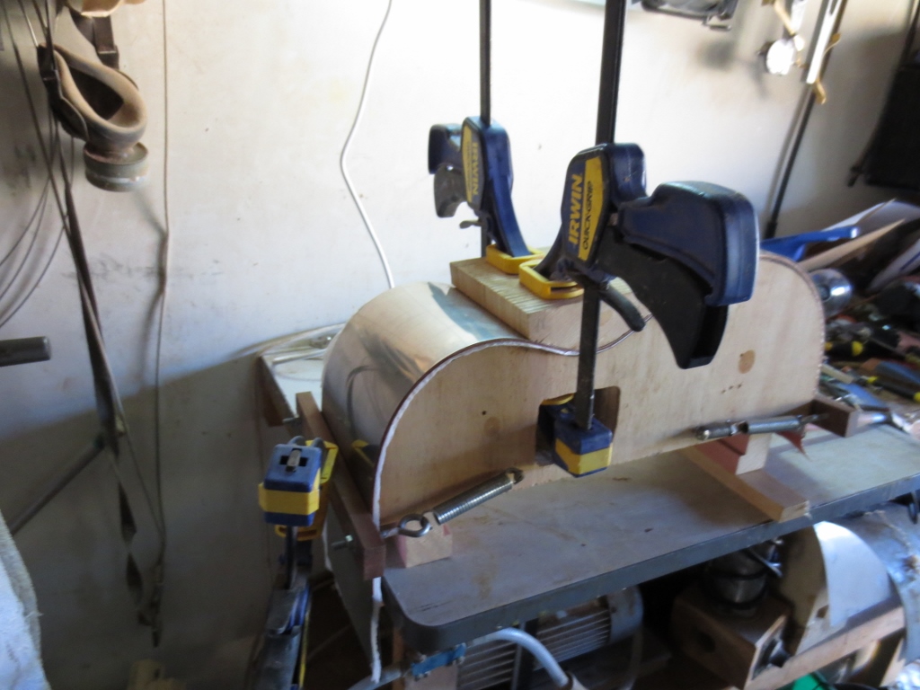

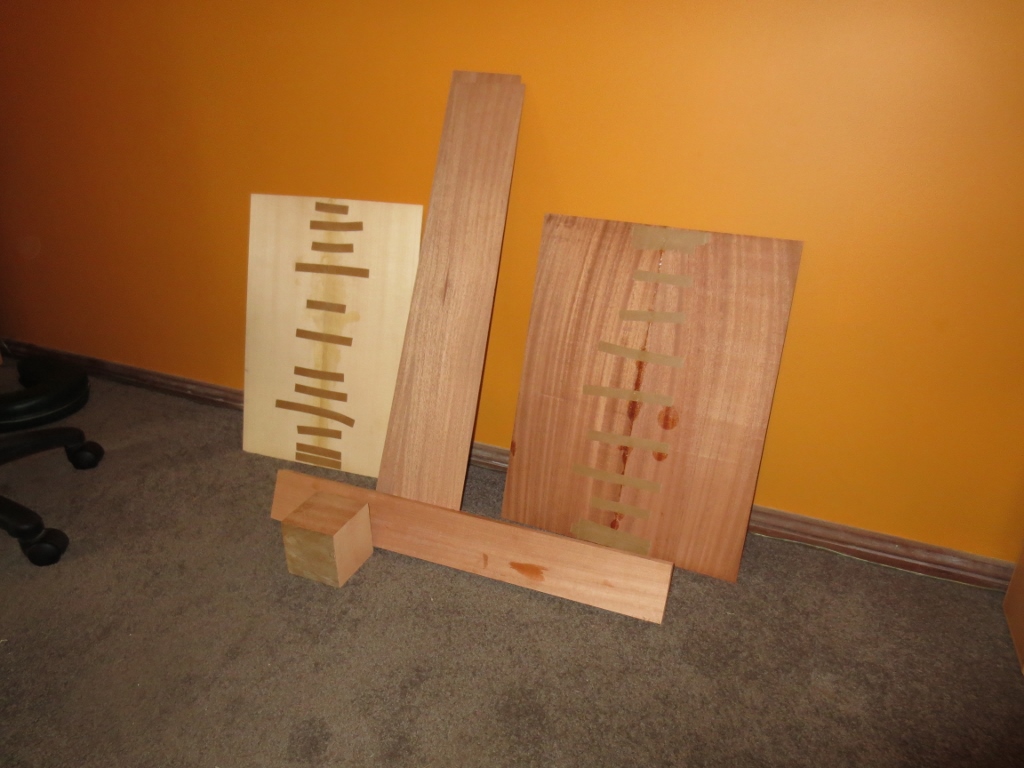

Post by jeffhigh » Sat Mar 09, 2013 1:30 pm
Top and back halves tested for properties (gore Method) then edges shot and joined using HHG and tape
QLD maple neck blank prepared
Side taken down to 2mm thickness

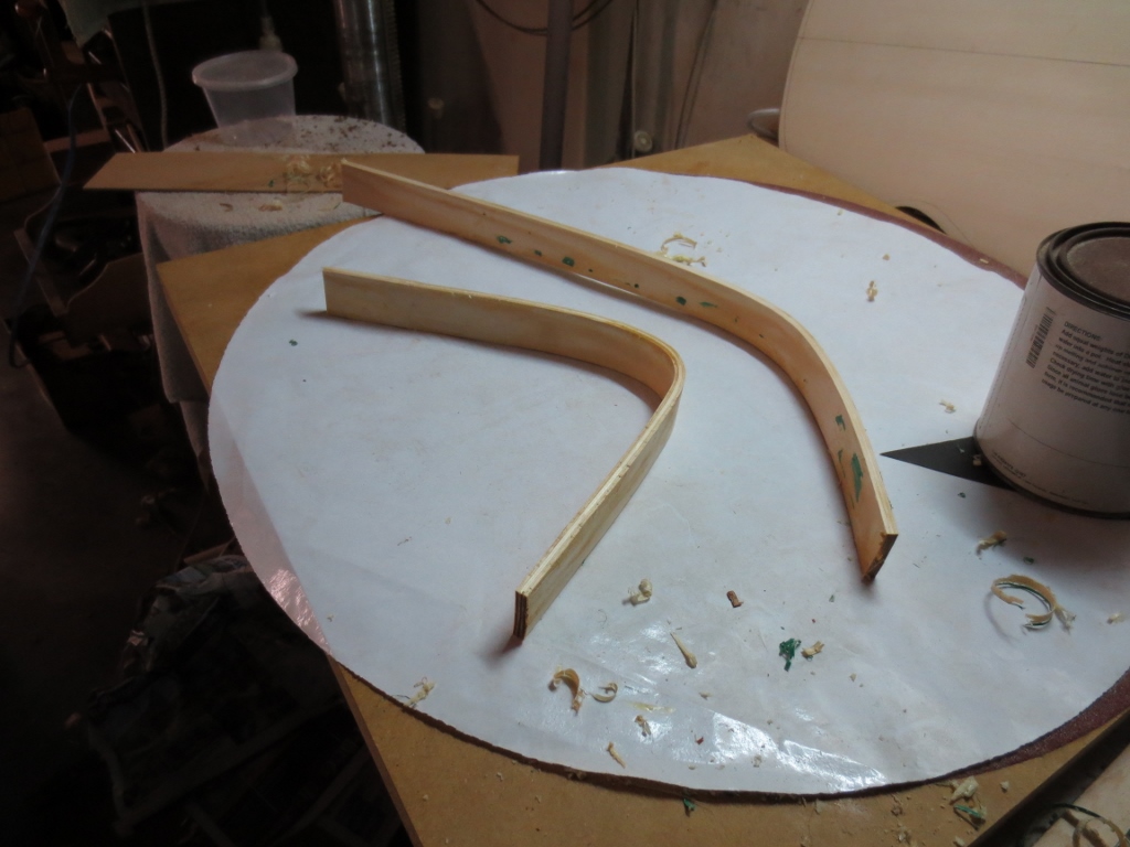

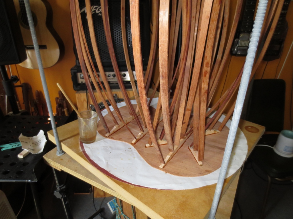

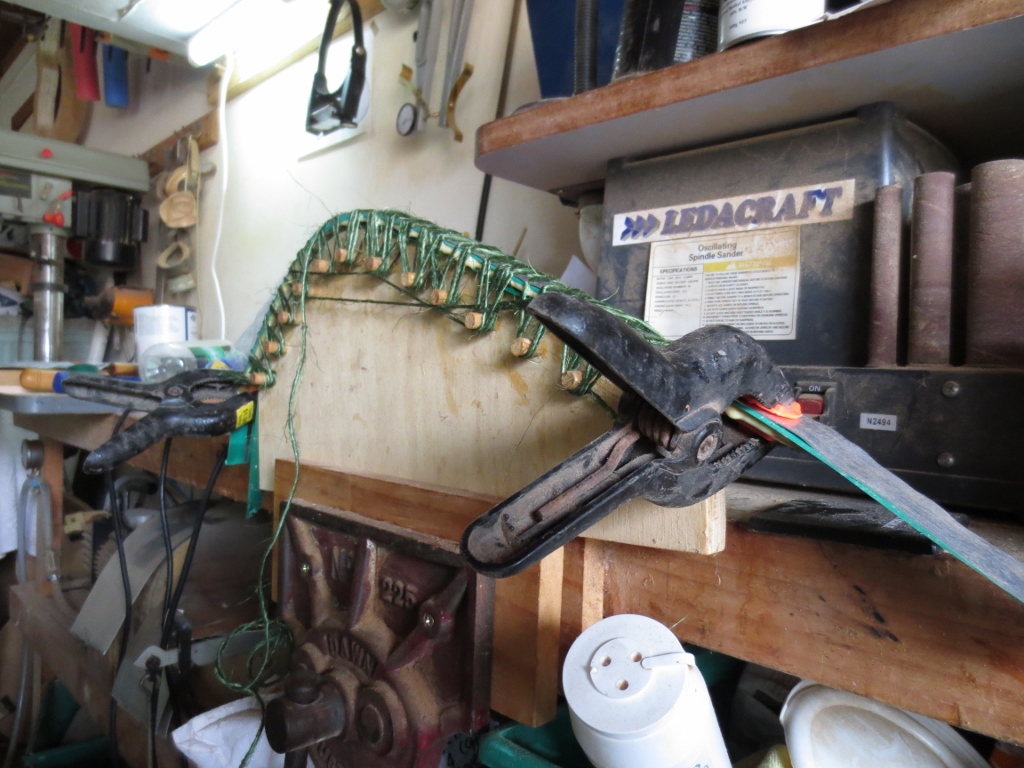

Re: Acoustic bass guitar build

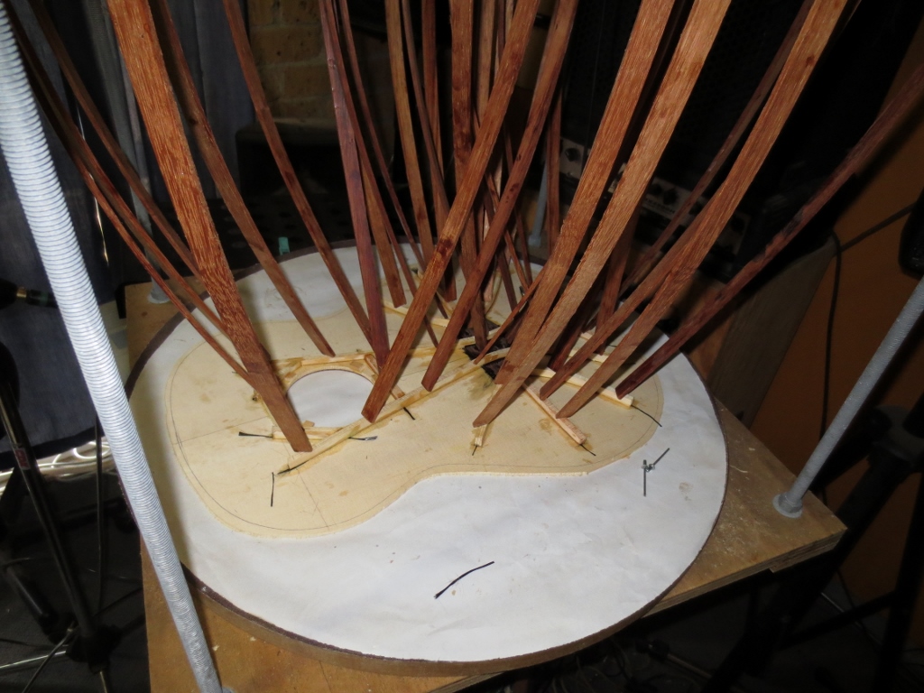

Post by jeffhigh » Mon Mar 25, 2013 8:18 am
Back braced, sides bent and falcate bracing laminated

Post by P Bill » Mon Mar 25, 2013 10:10 am
I like the no frills heat blanket bender.

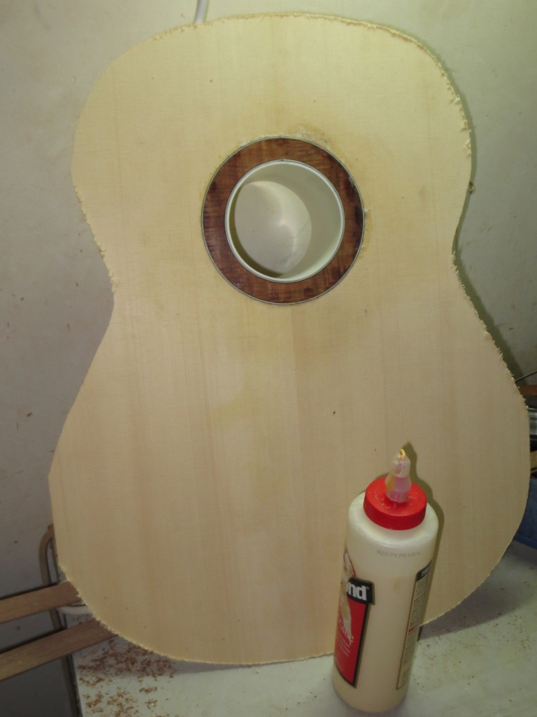

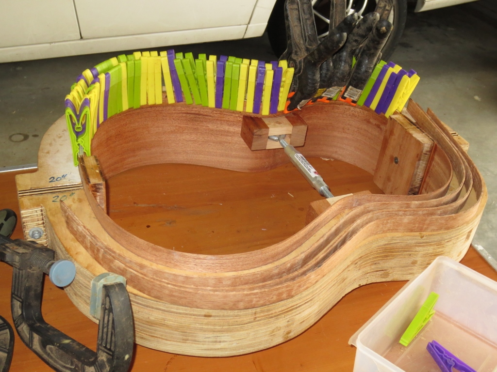

Post by jeffhigh » Fri Mar 29, 2013 1:08 pm
Laminated linings fitted to soundboard edge of rims
Rosette and tornavoz installed to soudboard (press fit)

Post by charangohabsburg » Fri Mar 29, 2013 10:37 pm
Hi Jeff, I'm following this thread with great interest, thanks for sharing! :)
May I ask, what did you made the tornavoz of? And will it be removable on the finished instrument? If not, I'd like to see one or two pictures more of it before you close the box! ;)
@ Graham: Thank you for sharing the article!
Post by jeffhigh » Sat Mar 30, 2013 6:33 am
It's 90mm pvc stormwater pipe with a section of bwb purfling glued to the top edge.
The outside is thinned a bit to reduce mass
At the moment it is a press fit, which I will either adjust with teflon tape or add a couple of small screws
It is removable and will be adjusted for length during the tuning process
