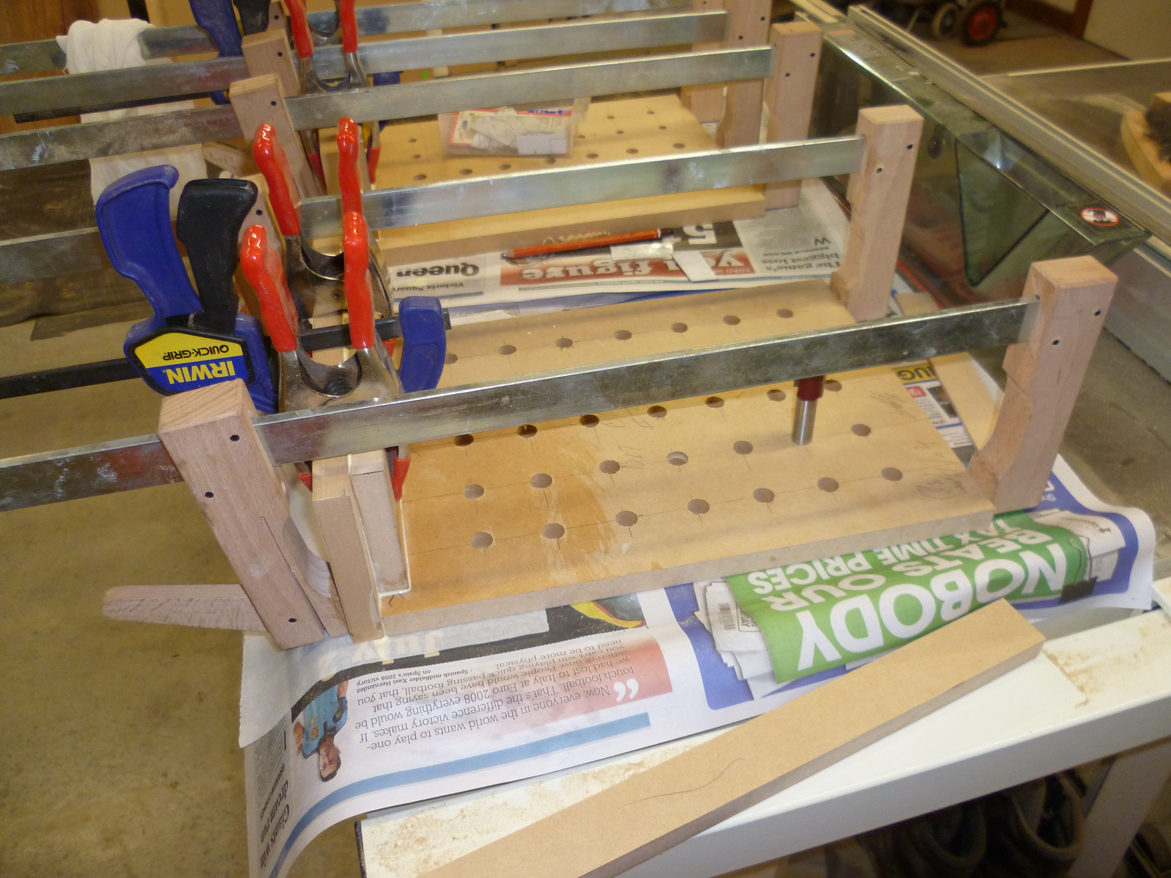

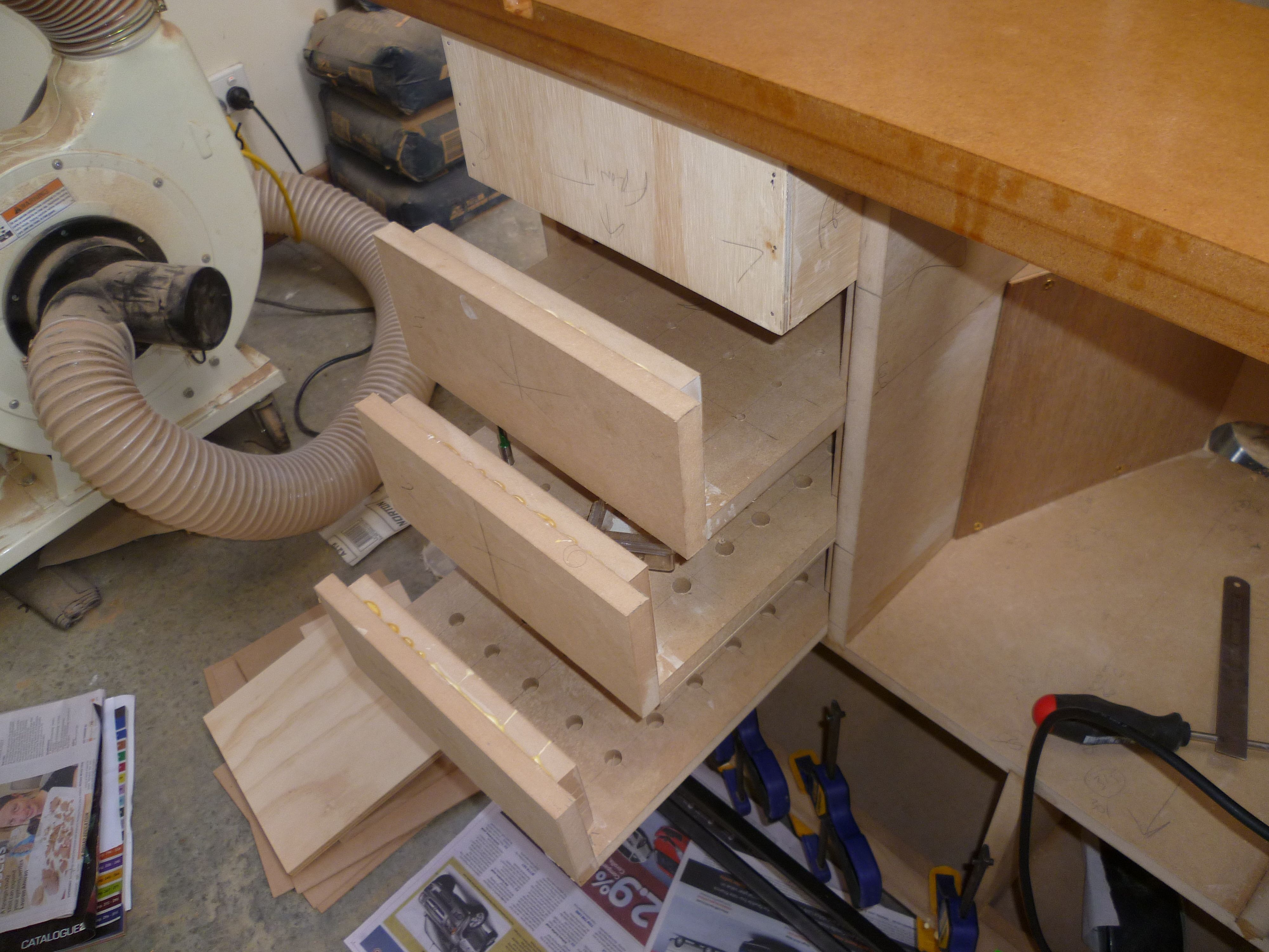

A bit more progress on the router table. Making up first of the drawers. These are the bit drawers.

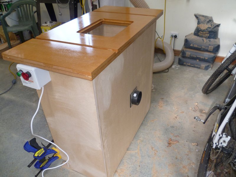

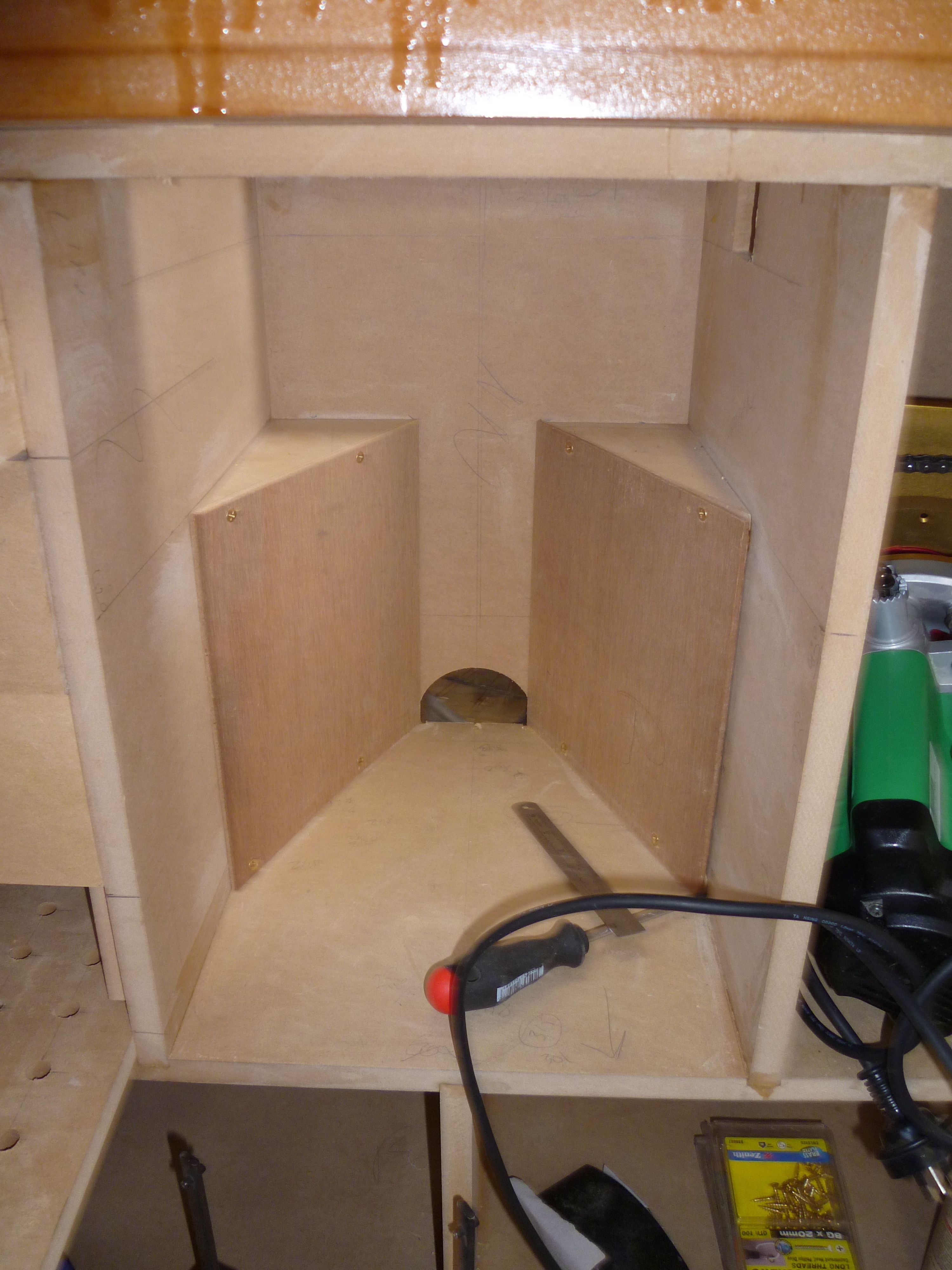

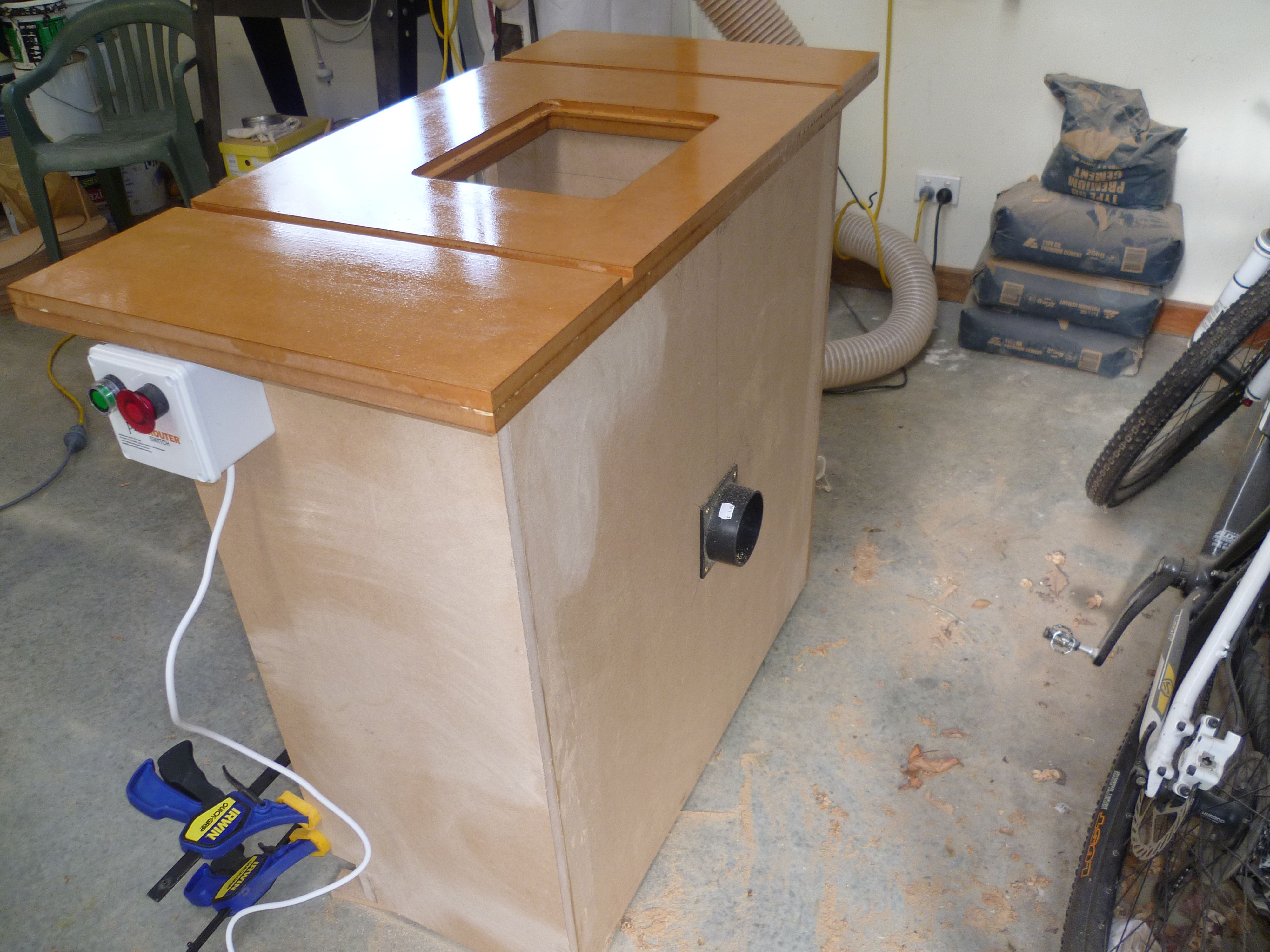

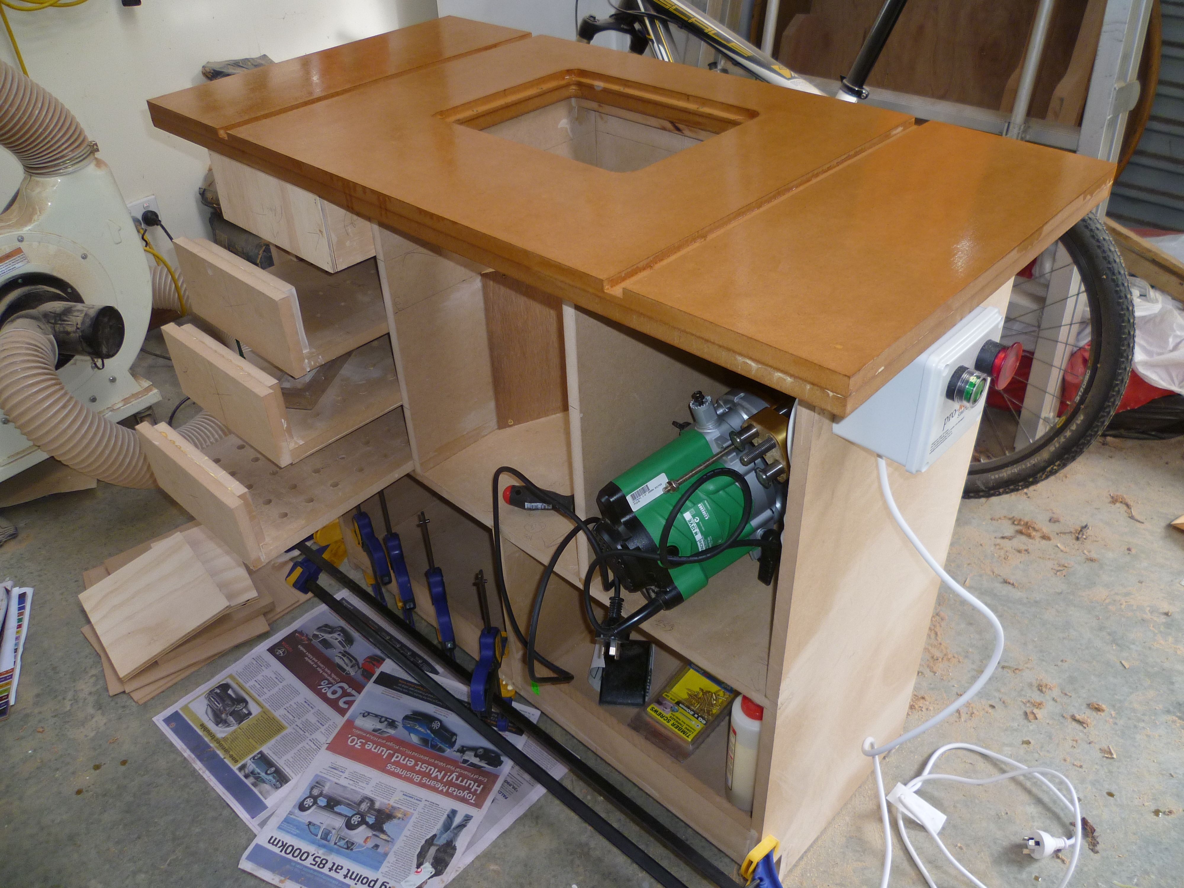

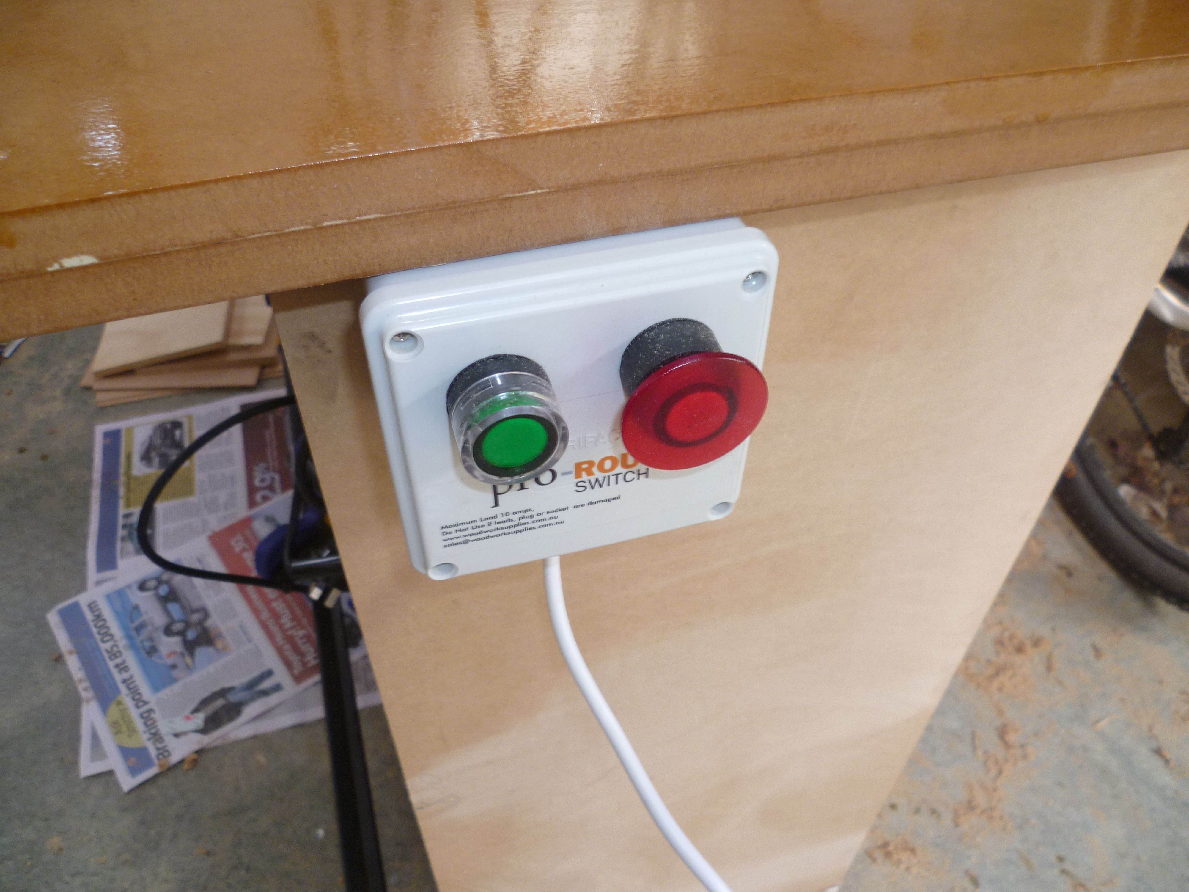

An update on the router table. The project has turned into a bldi monster. There are still 3 more drawers to be made up for left side of the table. Top had had three coats of tung oil applied and will be finished off with paste wax. I f**d up location of the dust port but it'll still work. The plans called for three large drawers on lower deck of the table but I cant be bothered and cost is already blowing out.
Rob....a close up of the zero volt switch included.
Re: Adhesive advice
Post by Lillian » Sat Jun 30, 2012 12:33 pm
Its coming along nicely Martin. I hope you have that beast on castors.

Post by auscab » Sat Jun 30, 2012 12:35 pm
Looks good, nice and solid.
Sure is no lightweight router table, paint the base grey and people who give you a hand moving it will think you have a cast iron base :D
Are you going so suck dust away at the fence as well.

Lillian wrote:Its coming along nicely Martin. I hope you have that beast on castors.
Yeah castors are planned,..
Re: Adhesive advice
Post by kiwigeo » Sat Jun 30, 2012 12:44 pm
auscab wrote:Looks good, nice and solid.
Yes there'll be a T piece at the dust port at rear and a 2" line up to the fence.
If I was doing it again I wouldnt use MDF for the carcass.....ply would be the go. Dados dont work too well on MDF.

Hi Martin.....would you mind telling me where you got your safety switch from.....I am looking for a couple of them at the moment....thanks
MBP
Posts: 180
Re: Adhesive advice
Post by MBP » Sat Jun 30, 2012 9:45 pm
John,
Here is the link. Martin mentioned it in another thread
http://www.woodworksupplies.com.au/prod375.htm
Re: Adhesive advice
Post by kiwigeo » Sat Jun 30, 2012 10:10 pm
The standard switch is out of stock at present with new stock due in circa July 13th. The deluxe switch with illuminated buttons is in stock and this is the one on my table.
