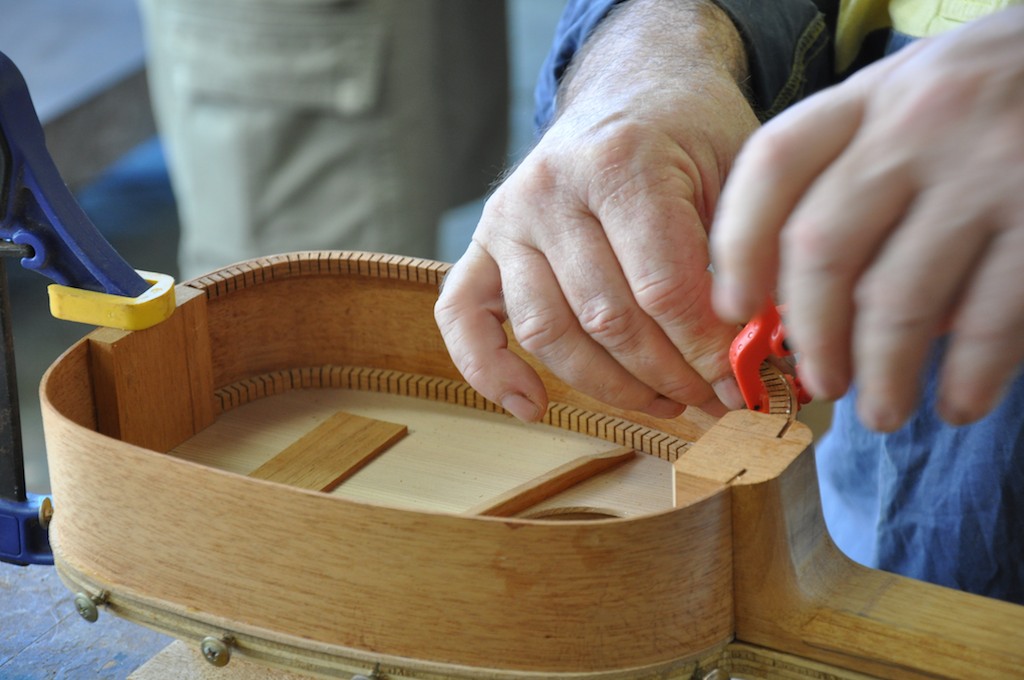

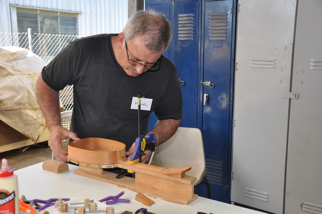

Tail Block is glued to sides first up.
Levelling it and inspecting
Pleased with the results
By the end of the first day we've got up to the back linings in, plus braces glued to the back.

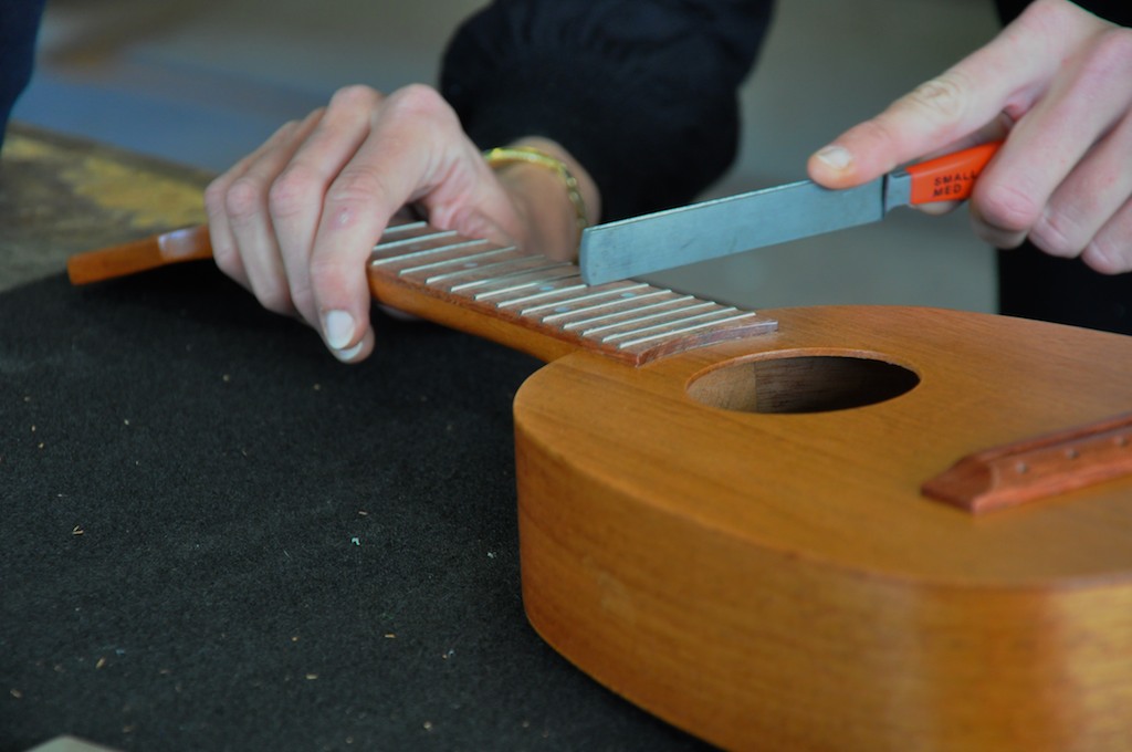

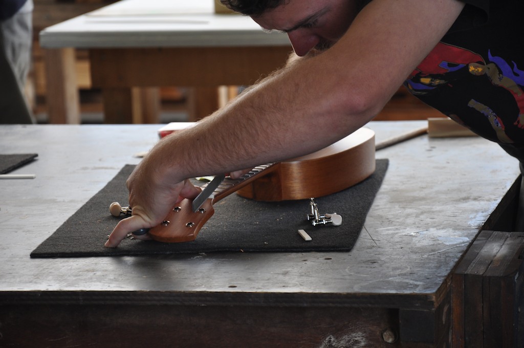

First up was levelling frets with a 6" diamond stone and then dressing frets.
