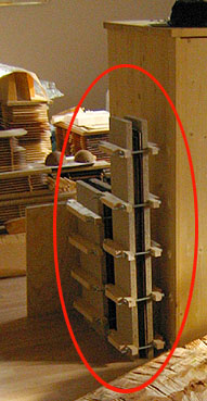

1. I work in a kitchen...they have a steam convection oven and later in the year they are closing the kitchen for renovation. I could chuck it in the steam oven at temperature with steam, remove it from the oven and place it on stickers in a small wood storage rack with threaded rod and wingnuts and tighten the hell out of the nuts, paint/ wax the ends the next day and wait a few months for the timber to dry properly under the pressure of the rack.
The rack would look something like Bob's phpBB2/userpix/2_IMG_1607_Medium_1.jpg

Ended up going with the steaming option after trying to correct the cup by placing it in the sun for short periods. Put it in for 40 minutes in the steamer at 100 degrees C. Then had a cheap $10 Kmart Pan full of wax. Dipped the ends in wax straight out of the steamer and had it all clamped up and stickered within two mins. I replaced the clamps a day later with weights and it doesn't seem to be moving much. Will report back in a year on the findings (after resawing)
Stu

(I'm sure I've seen those wood presses somewhere else??)
