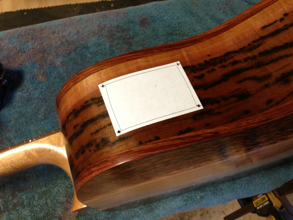

I recived my first LR Baggs stage pro anthem today . Do you have a template for the cut out or just measure and cut the hole ?
Regards Steve
martintaylor
Posts: 288
Re: Tasmanian Tiger Myrtle and King Billy Pine Dreadnought
Post by martintaylor » Wed Jun 12, 2013 10:25 pm
Hi Steve, I used the paper template they supplied and I used double sided tape to stick it in position. First, I drilled the screw holes (in stages) then I drilled the corners of the cutout, then I used my Dremel with a cutting wheel to cut it out. One of my side supports was in that section so I had to use a small router bit in the Dremel to cut away a little of the ends so the system sat up in the hole correctly. It went in really well. Oh, and the hole for the jack/strap larger than other pickups I have installed. I covered the area in low tack masking tape and then drilled the hole in stages. It sounded great through our sound system at church.

Thanks Martin
They did not supply the template so i will have to make one.
Regards Steve
