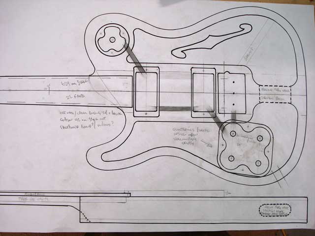

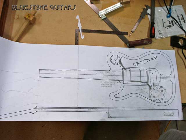

Seeaxe -Michael is the man to see about soundclips for his axe. You there BBM ?
PaulB - The plans for this I'd drawn from scratch with the only part taken from elsewhere being the tele body shape. Everything was
drawn out on paper then made into templates for this build.
Here's a pic. of the plans.
