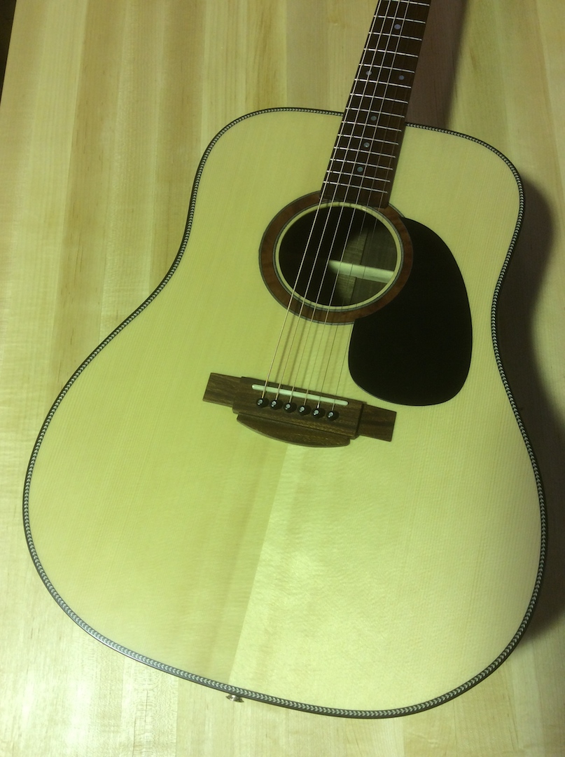

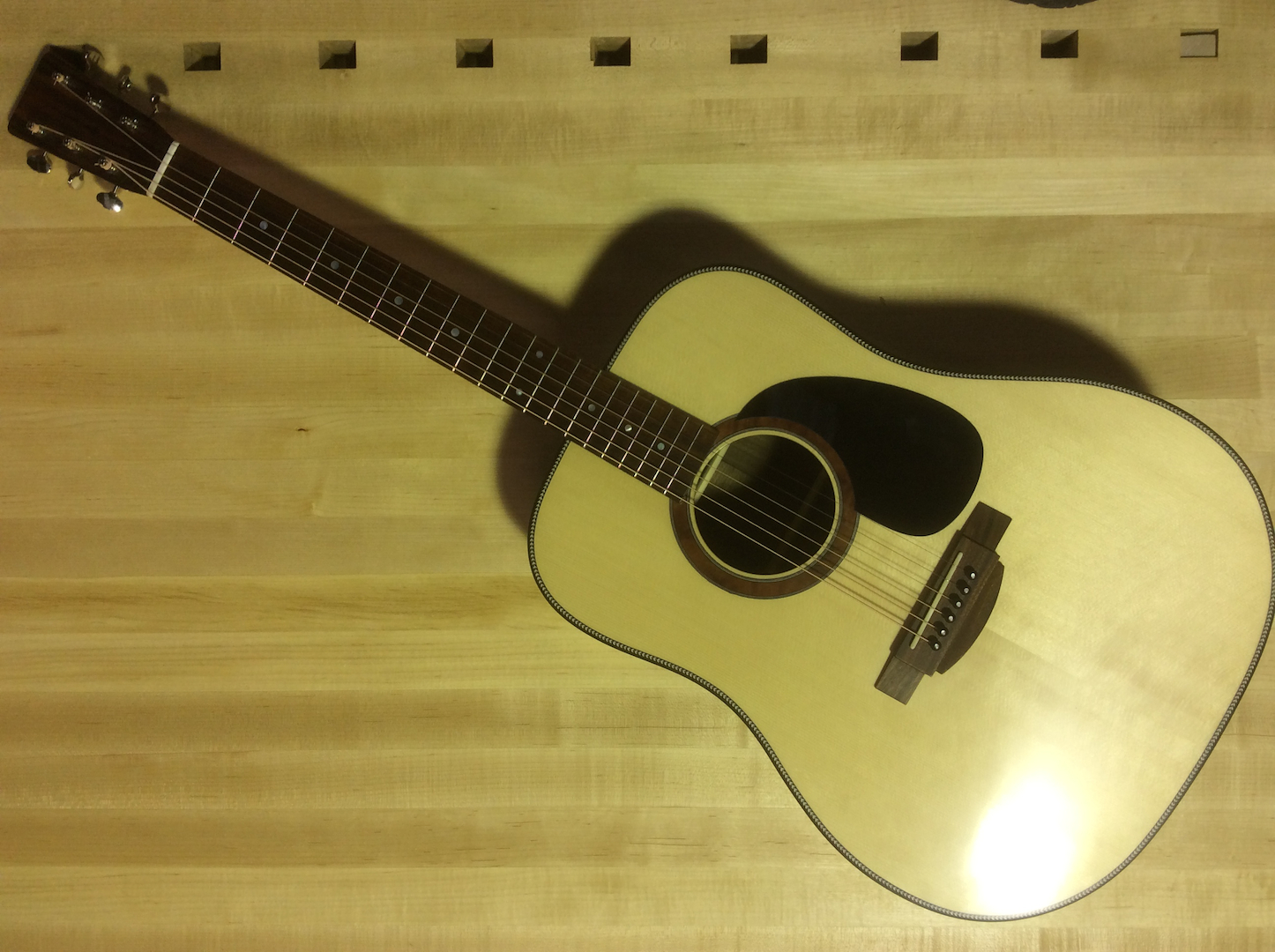

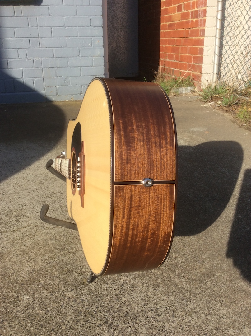

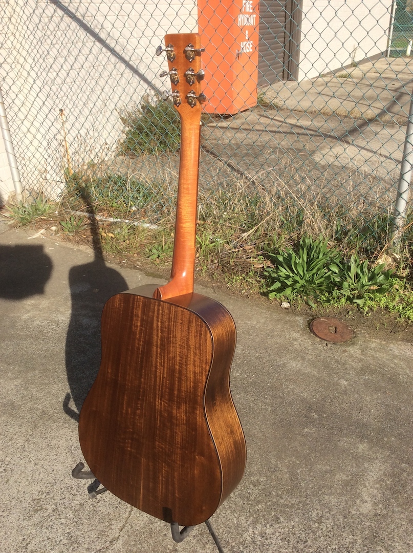

My 3rd acoustic
Nandu (Pericopsis Mooniana) Back and sides
Engelmann Top
Sth American Mahogany neck, neck block,end block and kerfings
Gidgee Fretboard and bridge
Macassar Ebony and US Maple bindings
Burl Myrtle Rosette (colour doesn't really work for me, maybe gidgee next time) with blk/wh/blk thingy from stewmac
Herringbone from stewmac
Grover Sta-Tite's
Headstock Veneer 4 layers top is Macassar Ebony/Maple/Wenge/Maple
Bone Nut and Saddle
K&K pure mini
Sounds ok, similar to my 30y old Koa Takemine, seems louder? Huge difference against my daughters Maton
it's easy to play, bought the bible (Gore) in time to make the neck a little wider but not in time to do a compensated nut, next time

I am not usually a fan of Dreads but that looks great. Love the side purf. How does the engleman work on the Dread? I love it on some smaller body guitars I have played.

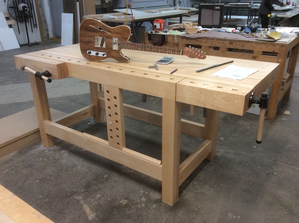

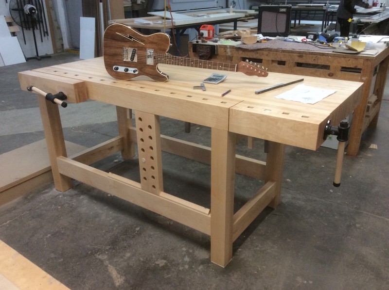

Nice workbench!

the Nandu looks very shimmery, i haven't heard of it before, how is it?
What finish did you use?

Jeremy i'm a 60's child and love my dread's, this is my third acoustic build and the second with engelmann, top was a bit spongie but firmed up with the strings on, may have gone a bit thin 1.9 on the edges i guess time will tell
Matt, yeah the new work bench!! we're all too scared to use it, The whole thing is solid rock maple, takes four guys to move it!
The Nandu came from a mate, His parents had their furniture crated up in it when they emigrated from Sri Lanka 60 years ago,
Not really a tried and tested tone wood, not a lot about it online, the figure however is something else
Mirotone 3220

Fortunately one of the blokes here is a German Master Cabinet Maker( his bench)
And again fortunately he has some awesome tools that he lets me use!
The Gidgee bridge on that dread was started using my cheap Japanese chisels and finished using his chisels
The difference was amazing, the tip here is spend money on good steel and quality water stones and the veritas honing jig is pretty cool
and nice saws and rasps and.............................
