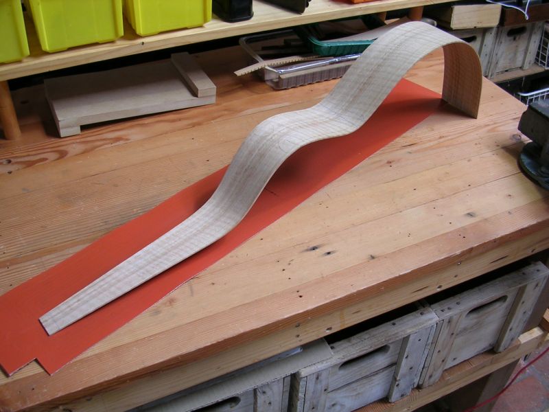

I finally got back out there in the past few days. After preparing the sides I began the bending today with my first side and the new system - but all was in vain.
I sprayed both sides of the timber and layed the blanket on top followed by a stainless steel sheet. I turned it all on and after 2 - 3 minutes there was a lot of steam.

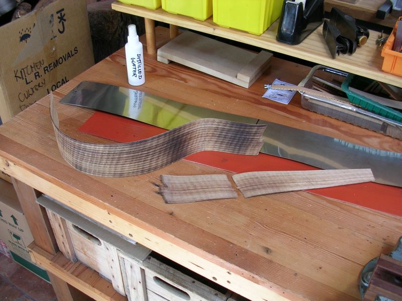

I turned off the blanket as I thought it was getting too hot and began the bending process. Centre partly down, then large bout, followed by the small bout.
The wood still seemed a little stiff so turned on the blanket again for another 2-3 minutes. I again began tightening everything up and turned off blanket. However, I heard cracking and realised the side had broken and part of the side was burnt.

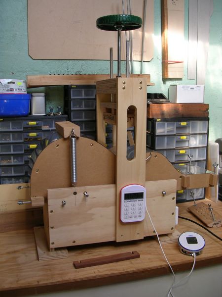

Above is a pic of my bender.
I am now at a loss to know what to do differently with the other remaining side. I should at least sacrifice this to hopefully get a little closer to getting the bend right.
Any advice gratefully appreciated.

The problem to me sounds like you dried out the wood before starting the bend.
My procedure for bending is to firstly run the sides quickly under a tap, then get everything in place, switch the blanket on and start the bending procedure ( bringing down the waste clamp, working the cauls down the bouts) as soon as it reaches 100ºC which is never more than about 20-30 seconds in. The whole process of getting everything in place is generally done within about two minutes and from there I spend a few minutes monitoring it and switching the blanket off every time it reaches about 150º and on again when it's down near 100º.
Is the wood Alpine Ash? I just bent my first set of it (for a Weiss) the other day and it bent fine. The intense figuring had me a bit aprehensive but it's quite a nice timber to work with.

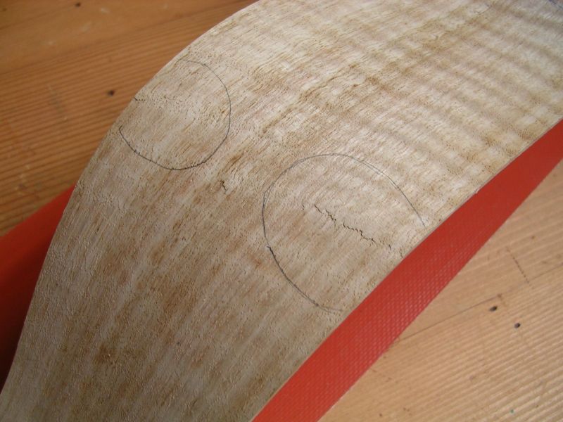

The crack seems to have happened at the upper bout bend going into the hollow neck area. I suspect this was because the wood was too dry at this stage of the bend, plus the support on the bending form in this area may not be enough. Kim - is your bending form solid or hollow with cross slats in this area? Any chance of a pic?
Also as I asked and Bob echoed - what thickness was the side? Hard to tell from the pic you posted.

I am bending over a solid mould made with 20mm custom wood with bracing side to side, which has a stainless steel sheet screwed to the sides.

I guess that's fairly thick for most woods and probably has a lot to do with your breakage.
I bent my last at 2.5 mm. , but it was a very easy bending type of wood ( Oregon Myrtle ) and got away with it.
You may have to resign yourself to bringing the side thickness down a little to maybe around 2.1 mm. ( .083 " ) or there abouts . Maybe even thinner if it's figured
Bob would have better info on this as he has recently bent some Tas . Oak ( Alpine ash ) ,I haven't !

I think the scorching tells it all... the side had dried out before the bending got underway.
