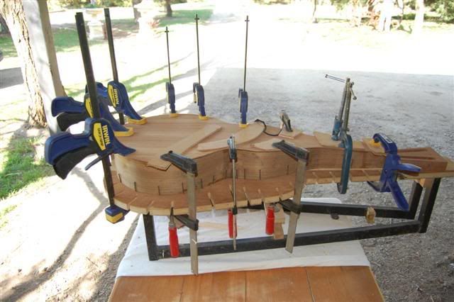

i took the timber to tim kill the other day and he said it was only really good for kindling which was dissapointing. I just wish it had've split before i spent hours carving out the f-holes and doing the bracing.
but i was lucky and was able to get some new timber from Tim so im almost back to where i was a week ago.
i glued the back on yesterday and will brace the top today (ran out of clamps).
for my next build i will definately be buying more Quick Grip clamps, theyre so easy to use.

I'm sure you're already aware of this , but just in case ,, You want to do all your glueing jobs when the humidity is down to 50 % or preferably a bit lower ( in the 40's ).
Wood contracts and expands with humidity fluctuations , so tis better to glue up in a medium % to avoid deformation at extreme humidities

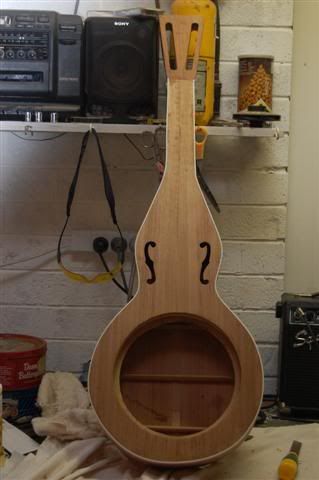

The box is now closed. binding is on, fretboard is ready to glue, coverplate/tailpiece are made and the whole thing is ready to be oiled.

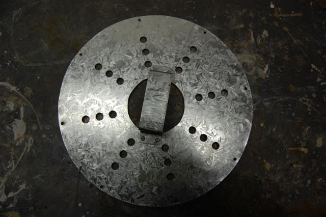

there's the coverplate. made from .6mm galv sheet. i decided not to rust it for two reasons- 1. it takes too long to do. and 2. the rust paint stuff costs $150 for the smallest kit. i played around with hydrochloric acid on some off cuts and got some cool rusty effects but i just dont have time to do it all properly.

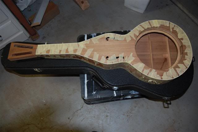

Binding is on- tim kill helped me cut the channel which made life a heap easier. i glued it with super glue, next time i will definately be more careful when doing this----it takes forever to get the excess glue off!!!
but it looks good now so im not too worried about it

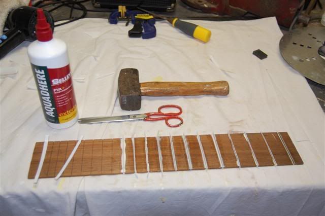

I was really lucky with the fretboard- tim kill gave me a spare one that he had that was already slotted. I used a plastic home brand ice cream container for the markers which was suggested by tim and worked really well.

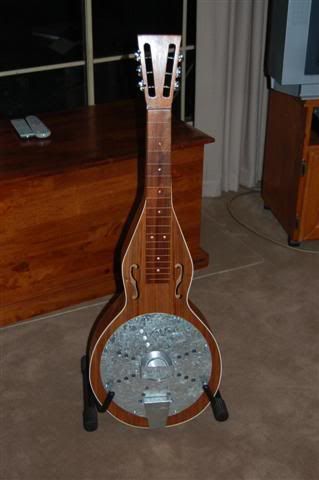

ITS DONE! finally! :D
ill upload more pics tomorrow.

Congratulations Josh, that is one innovative guitar. You should be very proud! It is going to be interesting to hear this guitar. Hope we get a chance to!

Congratulations ! . That is very very cool. I love the design!

Just one question....have you been using Aquadhere PVA for all your joints or just for the fret markers in the photo above?
Cheers Martin

Martin, yes i have used aquadhere for all joints except the bracing (used titebond). was that a bad move?

With CA/supergluing palstic binding, to cut down on mess I'd recommend using less of a stronger tape (the binding tape most suppliers sell is perfect and fairly inexpensive) and cleaning it with a scraper. Sanding is hard work but a scraper takes care of the job in minutes... just be careful not to gouge the top/back with the corners as you go.
