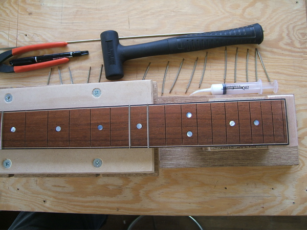

Here's the neck in the neck support - just started fitting the frets.

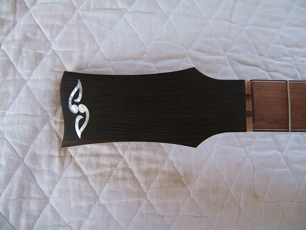

Headstock with inlay

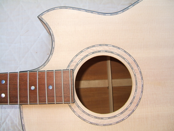

the Silky Oak rosette will look gorgeous when its finished but it doesn't show at all in this photo.
It isn't defying gravity. Should have rotated that one :oops:

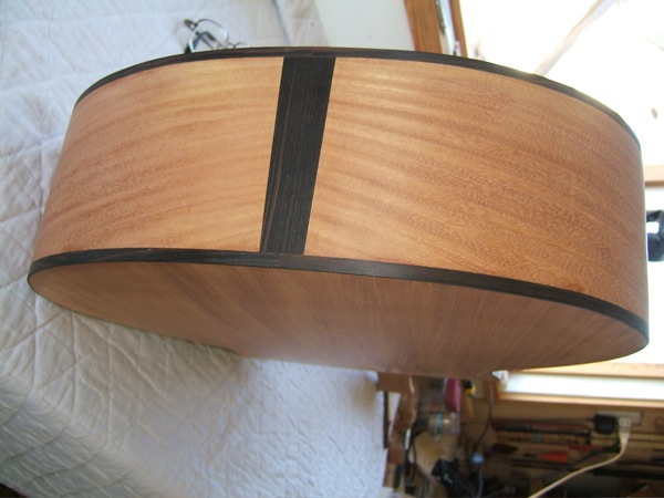

Back and sides are Osage orange from Bob Cefalu, bindings are recycled ebony cut from strips that lined the top of some old draws that someone had thrown out. They were shallow draws used for kimono storage. I left the cabinet, took the draws home, cut off the ebony strips and fitted the draws under the bench.
It has since been poor filled with Z epoxy and sprayed with water base finish. I'll leave it another week before cutting back and buffing with a lambswool pad fitted to an electric drill, and final buffing by hand.

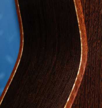

Here's a photo showing Tiger Jarrah binding and Silky Oak purfling from the previous guitar, Wenge Back and sides. A closer shot would show the black fleck through the Jarrah. It doesn't show up too well in this photo.

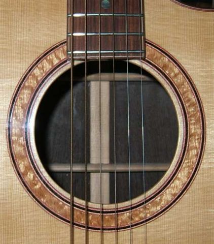

Sabastiaan wanted to see a Silky oak rosette. Here's the one I did for the Wenge guitar. Note that its close to flat sawn to bring out this figure. And Allen is right about it being soft, but unlike Lacewood from South America, Silky is a dream to bend. More about that topic later.

Welcome to the ANZLF. Nice looking guitar - is that your own design? I really like the purfling and rosette.

Ooohh that rosette is pretty, thanks for posting.

I meant the purfling on the first guitar (and rosette) but the second rosette is nice too.
