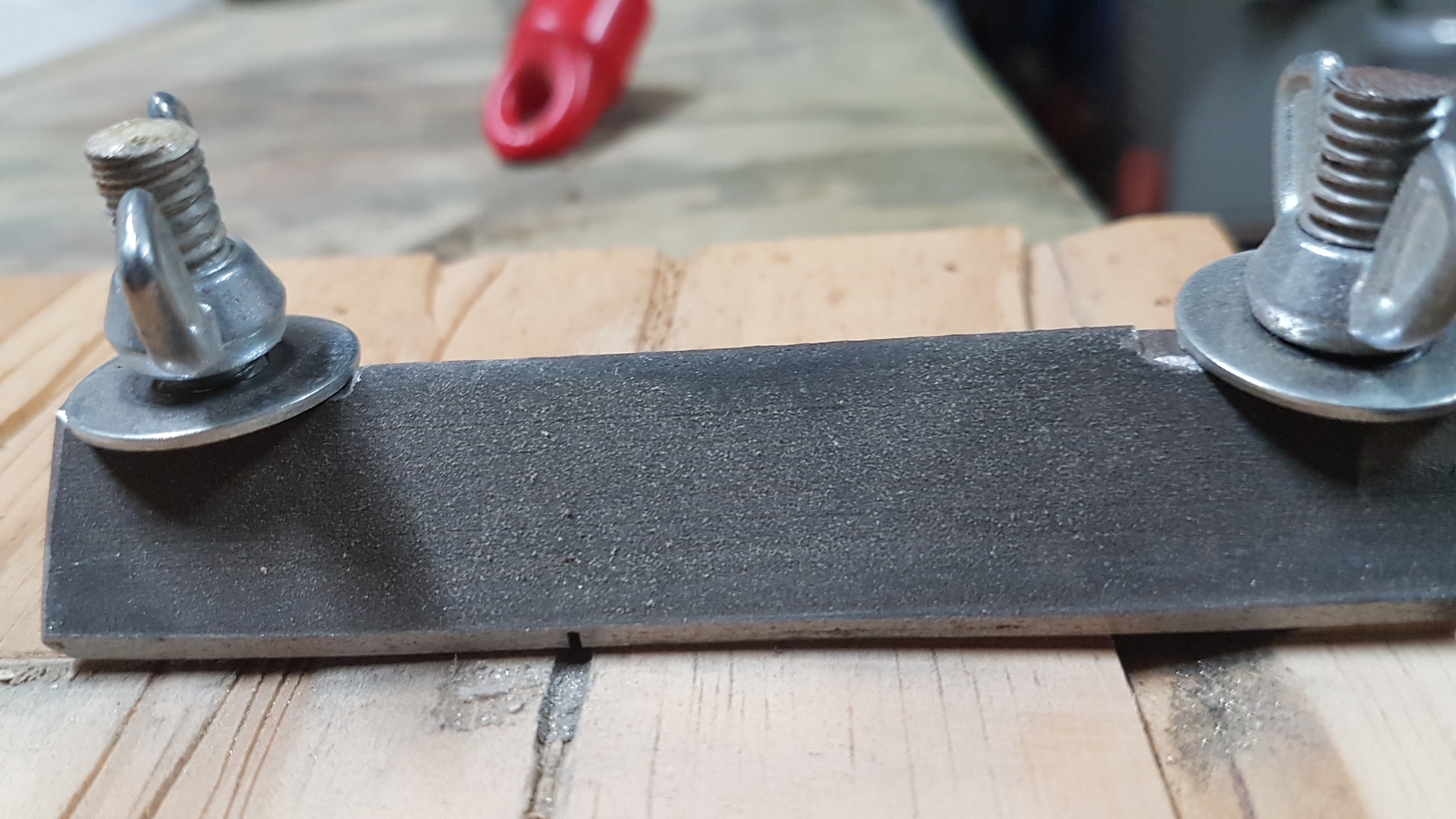

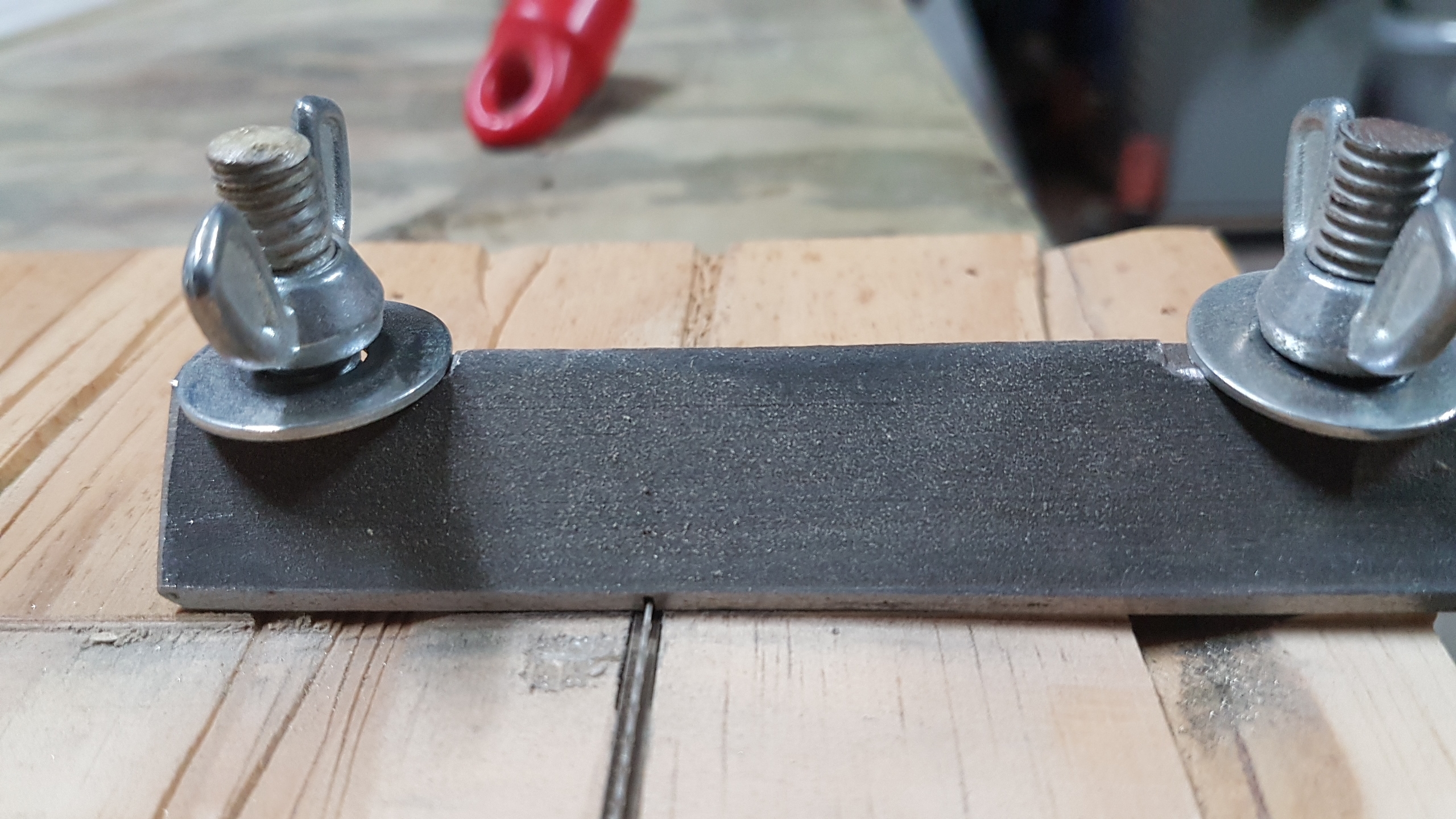

I don't have a tang nipper. I use this little jig to hold fretwire upside down and file tang off. Takes 30 mins to make. Every now & then i have to cut a a new 'trench' in the ply. Works gine for me. Frank
Great tool! Yes, the tang nipper gets most of the job done, but file dressing is needed as well to get the frets to sit professionally in my opinion. Can do the whole thing without the nipper using one of these jigs. How about a mod to the jig to also round the fret ends as well for the spherical fret end look and feel? Could also mod for multiple frets at one filing, along with a way of fine tuning the fret lengths at the same time.One of the trickiest things to nail with spherical fret ends and tangs, given that the frets need to be over radiused before pressing is getting the bullet ends lined up evenly once pressed into place. Streamlining that work would be a good thing.
