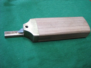

Post by Craig » Sun Aug 03, 2008 5:12 pm
This is the type of purfling cutter I use James. (Sloane) . These are available at Carba-tec .
The blade is fully adjustable for depth and width of cut. They come with left and right beveled blades . These must be kept very sharp.
When making your first pass with it , let the weight of the tool itself score the first line . Don't be tempted to add a pound or two . You can gradually increase the depth of cut once the scored line is established. Keep the tool perfectly upright ,in line with your sides. It goes faster than you would probably think and is a must for cutaways and tighter type bends, ( particularly when doing the back ledges ) ,even if you do have a router type set-up.
I really enjoy using it actually ,and end up with a nice crisp edge

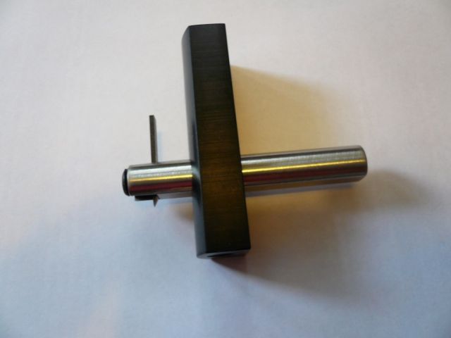

As Bob said I often cut my binding and purfling channels by hand, using a gramil and chisels. Most of the time now though I have to admit to using a William's jig with Dave White's modification, but I do have a panchant for hand building.
I used to use the Sloan type of gramil, but switched to the one from LMI and I believe it is far superior for guitar use. The Sloan type is really designed more for cutting the groove for violin purfling wheras the LMI is made with guitars in mind.
As you can see the LMI cutter can be used in various ways. For cutting on the side of the guitar it can be set up as shown so that only a small length of the guide runs on the top so that it is not affected by the dome. But when cutting a line on the top or back it can be turned round so that a longer section rides alone the sides for better control. It can also be turned round so that for the convex sections of the side the flat runs along it and for the waist the rounded side. One thing to watch with these cutters is that the bevel on the blade is always on the waste side of the cut.
Take very light cuts at first. Clean up is with chisels. Go slow and take your time. I find that I can cut the binding channels with this nearly as quickly as I can with a jig and laminate trimmer, but even if I'm using the trimmer I always define the cuts with the gramil first especially on Cedar or redwood tops, far reduces the risk of tearout.
