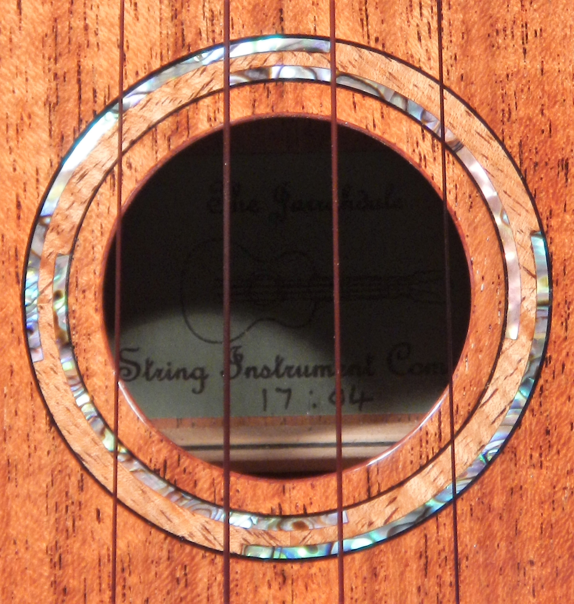

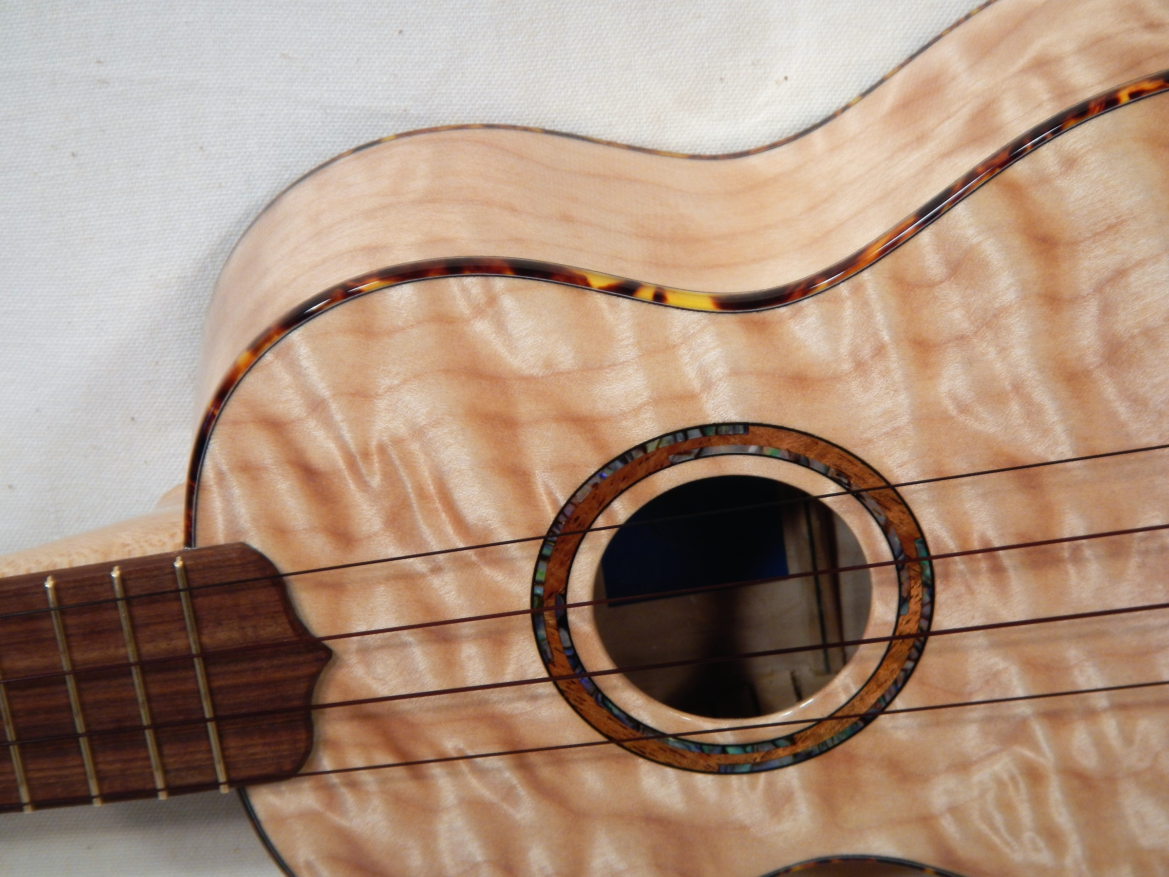

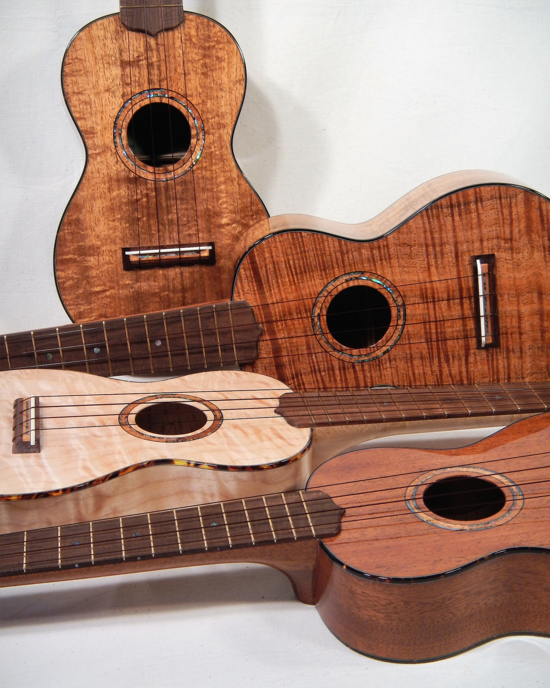

Hi,
This is my first post to this forum. I’ve been watching from the sidelines for a while and really appreciate the mix of gallery and Q&A. Inspiring and informative.
I make soprano ukes as a hobby and currently spray finish with Wattyl Stylewood precat lacquer 95% gloss. I use it because I’m familiar with the product, its locally available and I already had some on the shelf from previous adventures in woodcraft. I’m happy enough with the results but I haven’t sprayed anything else to compare it to. It’s shiny, durable, doesn’t react with my superglue grain filling and doesn’t blush unless I spray when it is very cold and wet. Generally, I’m satisfied with the product but most of you guys seem to use Miratone 3220. I need to buy some lacquer so what benefits would I get if I swapped to Miratone?
Based on an interesting previous thread I will be upgrading to a new gun which will probably be an Iwata LPH-80-124G with a 250 ml pot so thanks to those that contributes to that question.

Welcome to the forum Paul! some nice little ukes there. I use the 3220, it is also a pre cat lacquer so from what you say of the Wattyl ( I've never even heard of it let alone used it (we do have Wattyl products here in NZ but never seen that one) so I can't comment on a direct comparison) they sound very similar so if you are happy with the Wattyl and the results you get then stick with it. As they say, if it ain't broke don't fix it!

Hi Nick,
The Wattyl stylewood might be the same stuff that they used to (or maybe still ) marketed as Isoguard. I think I remember a Wattyl shop guy telling me that the 20 litre tins got labelled isoguard and sold to the trade and the 4 litre tins got labelled stylewood and sold to the home handyman market but I heard that a while ago and might have mixed it up. I'm over in Western Australia and it's the Miratone that's a bit hard to get. I can only find one distributor and its a bit of a trek from my place.
Thanks for the comments on my little ukes.
