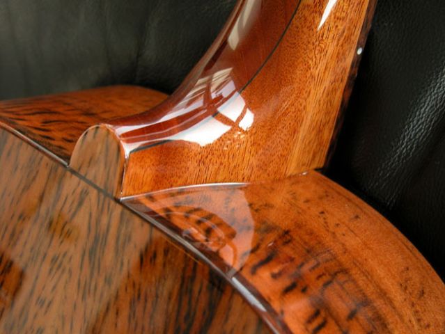

Hi Nick
Some of the guys on this forum are laminating necks with a wide centre strip (Hesh and Bob spring to mind). This was common in the past where they would use a strip of ebony laminated into the neck to add strength. I think that laminating necks this way provides a far better finish than stacked heels with spliced heads (especially with figured timbers).
Building necks this way also opens up the list of neck timbers by allowing you to utilise some of the heavier local timbers and offset the weight by combining them with lighter ones. For example Aust red cedar with myrtle or white beech with jarrah.
I had a dig back into past posts and found this photo from Hesh… really is a fantastic look.
