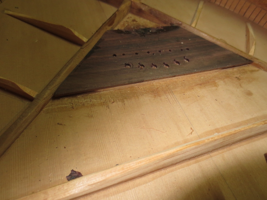

This one has collapsed in front of the bridge, the bridge plate has come adrift the soundboard has a small crack, the X brace has split at the intersection and some misguided person has tried to repair it by epoxying on a Carbon Fibre Bar in front of the bridge plate,
The Bridge plate will have to come off, but first that CF bar, any suggestions on how to remove it?

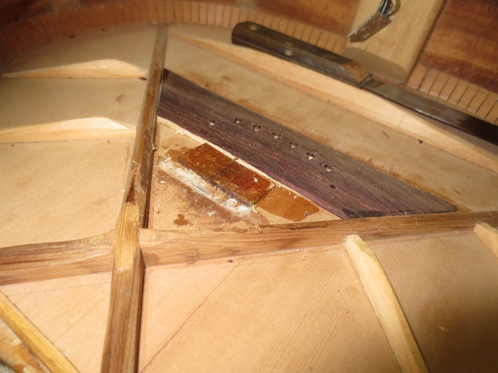

Managed to get the CF bar off with a hot pallet knife and more surprises.
Someone has been in here before and it's not pretty
Beneath that Humungeous rosewood bridgeplate is the original Maple plate and a 30 x 20 patch at the front, total 4.8mm thick, but just floating over much of the area.
All epoxied on........
And the brace behind the bridgeplate was only just hanging in there so it's off now.

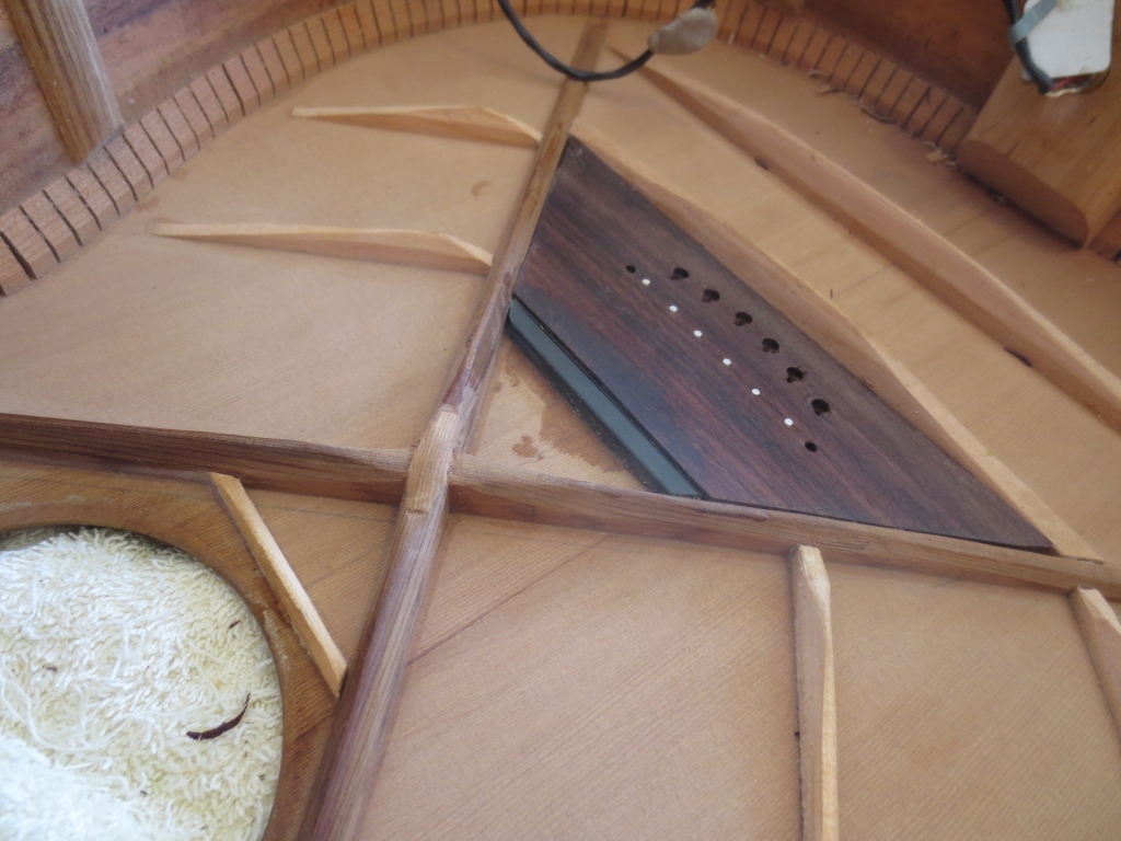

I dont know if its the photo or just me, but those bridge pin locations, look way to far back from the x brace, and the x brace looks to be to far back from the rosette.
The load on the top would not be pretty, and explains all the collapsing and cracking forward of the bridge
Re: Jim Williams 2009 Repair
Yep, its a 12 fret neck so the bridge pins are a fair way back, and the X brace angle is spread more than I would like.
But I am assuming that it has experienced some physical abuse too such as being sat on.
The new owner paid $2000 for it. I am disgusted that someone would sell it like that with such shoddy repairs.

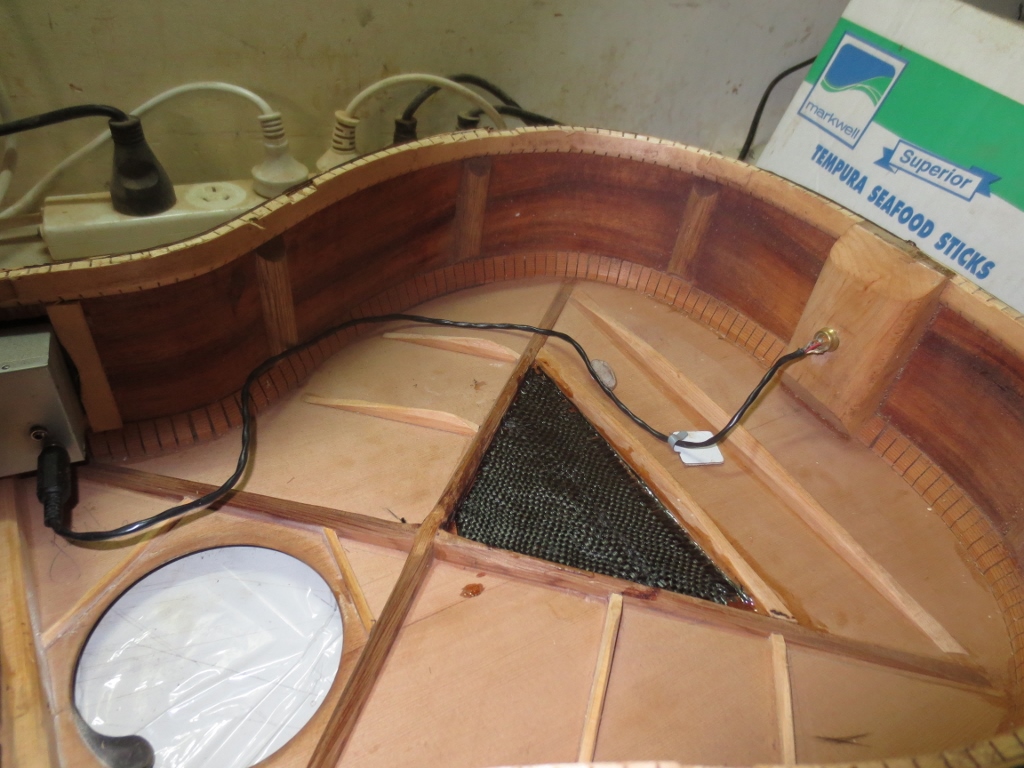

Repair plans include a Carbon fibre/spruce /Carbon fibre patch filling the V

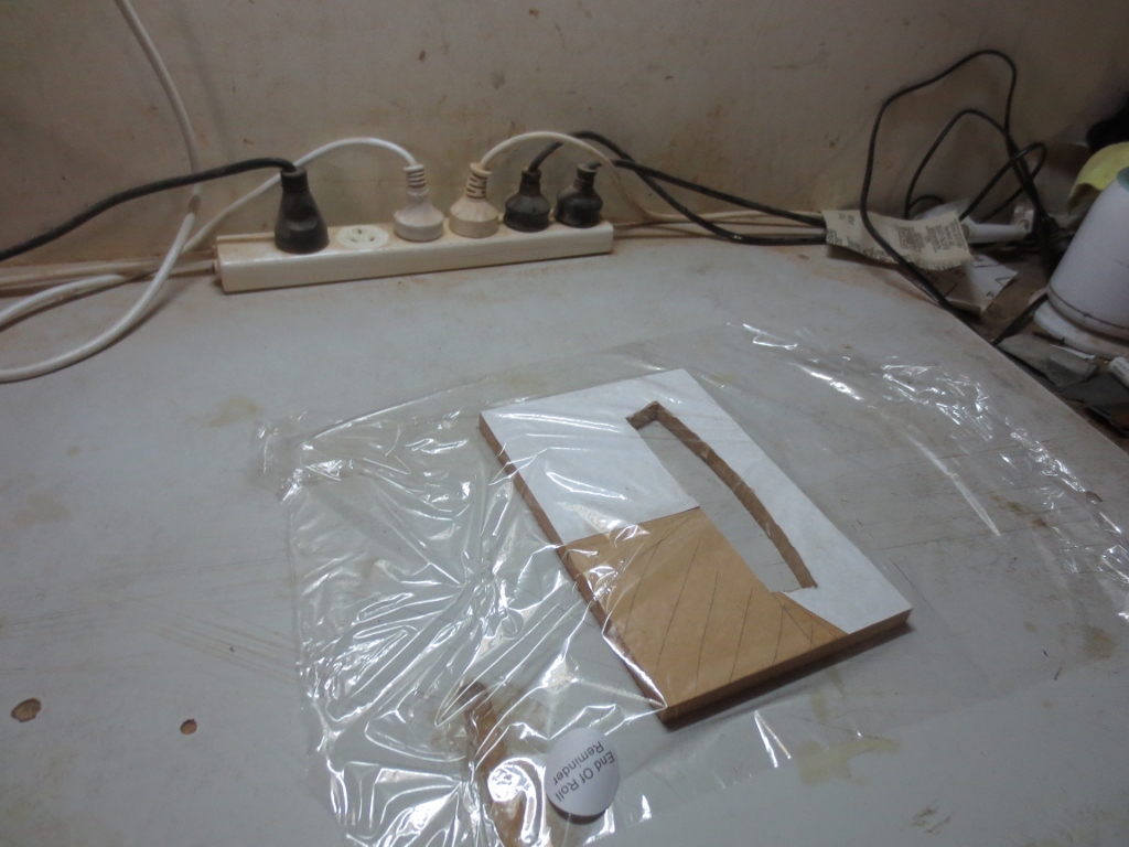

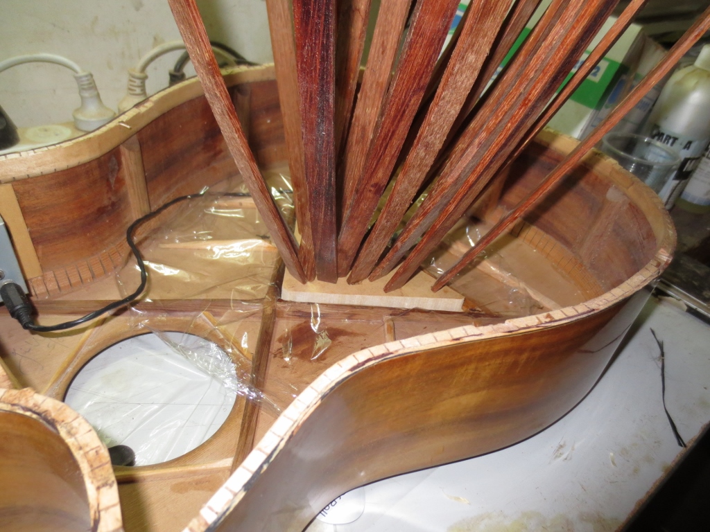

Staring to reinforce the bridge area
Epoxy/CF/Spruce to start
The face is sitting on a caul cutout for the bridge and packed up to the pickguard thickness
