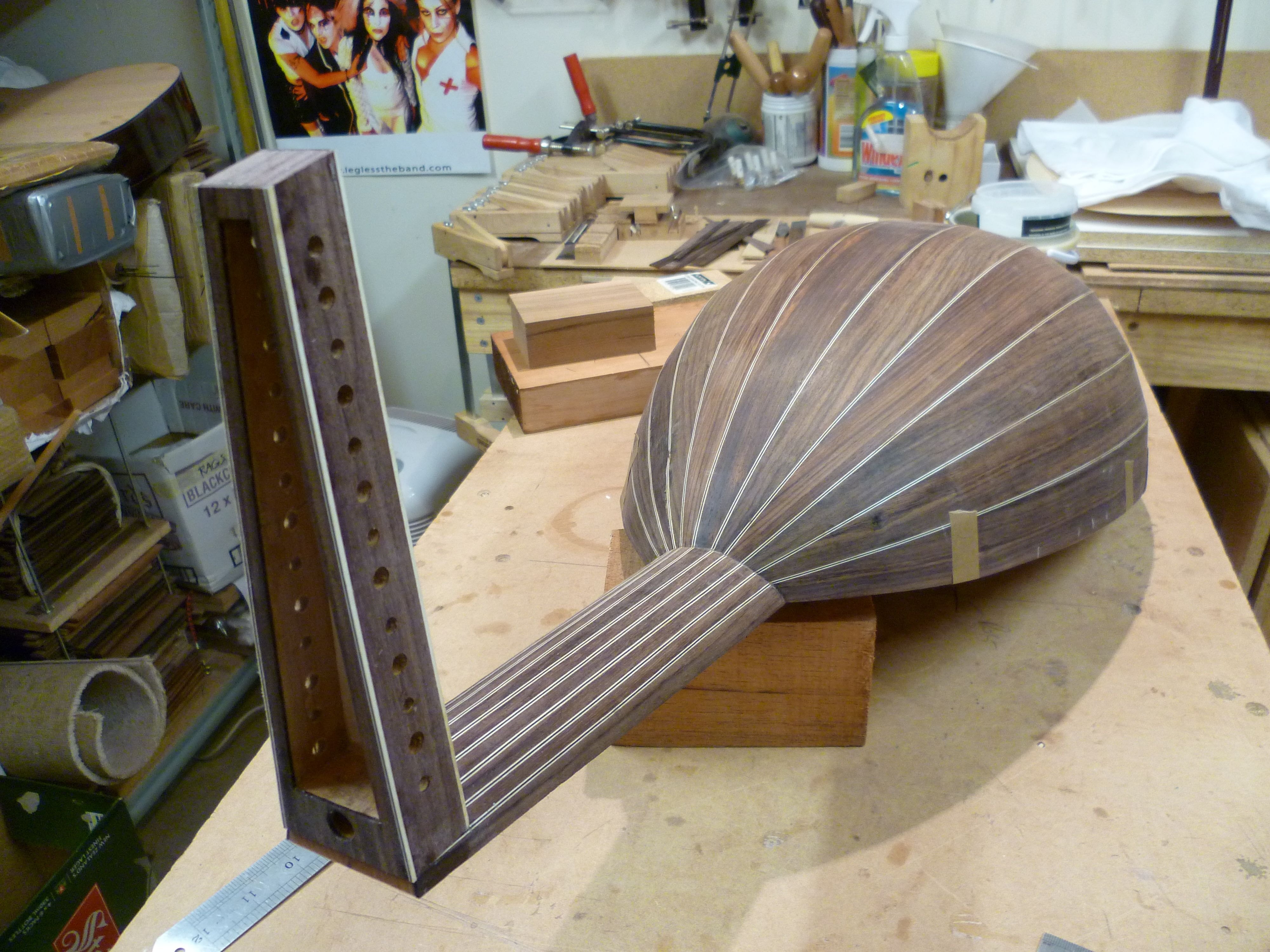

It's amazing how much wood you can remove if you want to:
The gibson headstocks snap due to the use of Mahogany (weak) and the largest truss rod routs in the business, the headstock angle, the nut being recessed into the neck, and the lack of volute.
Posts: 10877
Re: Some new thoughts on bass headstocks (I think...)
Post by kiwigeo » Wed Mar 12, 2014 1:49 pm
More holes than wood in this baby....
