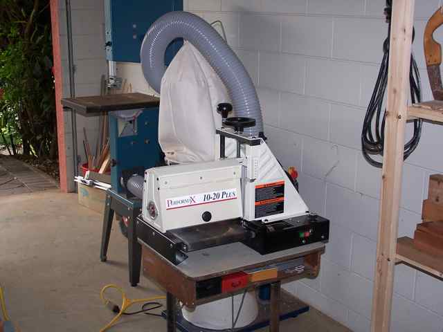

I just took delivery of my new Performax 10/20 today and boy I'm stoked. :D
Out of the box it was set up about as good as I think you are ever going to get it. All I had to do was attach the hand wheel for the depth adjustment. That's about a 30 second job.
My digital calipers don't register a difference of even .01 mm across 10 inches. I had a back that was glued up and I wanted to take down a bit more. A couple of run throughs flipping it around to get both sides and its perfect. No ridge down the center and dead even from side to side.
Highly recommend this one.
Post by Hesh1956 » Sat Apr 19, 2008 11:12 pm
Congrats Allen I have the same machine and love it.
Here are some tips for you if you want them.
First mine was dead on right out of the box too - I checked it and decided that it was too close to even attempt to improve. I see about .002 variance across a plate - tough to beat and why bother?
I use 80 grit for hard woods and 120 for soft woods with good results.
I never crank the handle down more than 1/8th of a turn at once and this is typically .004 - -008 of material removal.
I have noticed that if you run the plate through again with out turning the knob at all you can see around .002 - .004 more reduction.
The circuit breaker on mine is to sensitive and trips prematurely so I plug my machine into a circuit that my dust extractor and dehumidifier are not on and the problem is solved.
The feed belts are notorious for wanting to track to the right. Even when you adjust them perfectly after a few minutes of use the feed belt is again all the way on the right side.
But not only does this not hurt anything I have also noticed that when I center the feed belt and sand, before it moves to the right I do see the slight ridge in the center that some complain about. Once the belt returns to where it wants to naturally live, the right side, the ridge is not there. When you think about this the ridges appear on the left most edge of the belt when they show up. When the belt is not in this position, the left most side, no ridge. So I actually think that we are getting lucky when our belts track to the right because it also cures the ridge thing too.
I used masking tape to tape the cracks and spaces in the hood and this improves the dust collection and also the cooling of the drum.
These machines can get off balance when the fins inside the drum fills up with saw dust. So I cut a nozzle on my vac to 45 degrees and place it against the side of the drum and spin the drum slowly by hand to vac all the dust out of the center of the drum. Please unplug the machine first.
I set the speed control on 30% for all tasks and it works well.
Enjoy!
