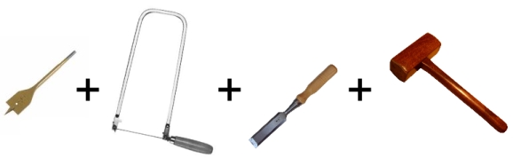

This little size 5 that I'm going to building next is going to have a slotted head stock. I really like the look of the top of the slot being square, rather than the round left by a router bit. Any suggestions on the best way to tackle this?
James Mc
Posts: 245
Post by James Mc » Sun Mar 02, 2008 4:26 pm
Post by Allen » Sun Mar 02, 2008 4:54 pm
Your forgot the most important step James.
James Mc
Posts: 245
Post by James Mc » Sun Mar 02, 2008 5:01 pm
yep... I think it would be a three beer job.
Post by kiwigeo » Sun Mar 02, 2008 6:29 pm
Allen wrote:Thats good to know Martin, I was thinking that these might be ideal for that. I'll have to rethink this then.
Routing will give the cleanest straighest cut. I do it bhy hand, rough cutting with a coping saw and then finishing off with a very sharp paring chisel and then a wide sanding stick. I try and work with the headstock at eye height in my parrot vice so I can quickly see both sides of the headstock. The rounded upper end of my slots get rough worked witha rat tail file and then I finish off with sandpaper wrapped around an appropriate diameter piece of dowel. The square end of the slot gets done with paring chisels of an appropriate width and then finished off with sanding sticks.
