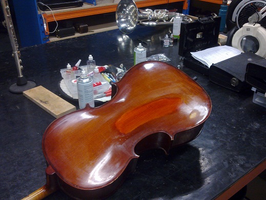

I thought I would ask others what theyve seen, I got in today a cello for repair that has been "touched up" by someone else "paid job", the customer was not very happy with the finish. Ive taken photos Mmm what does one say

That's a very ordinary repair , especially when you consider the time and effort that would have gone into it,
But can I ask , What was the original repair ? was it just the touchup of the finish?
Re: How bad can a refinish touch up be
Simso, I don't mean to be rude, but are you serious or having a joke - that was actually a repair?

Im deadly serious, this was given to me to repair today, this was the job someone else has done and returned to the paying customer, it apparently just had a crack in the back for fixing, you can still see the crack through the layers of ??, im guessing its a shellac finish.
Go figure, its not even close to the original colour. I cannot say to much becuase Im only going on what the customer has told me, they even gave me the luthiers name. But without both sides to the story you never know.

The finish isnt too bad...considering it was probably applied with a 4" cheap as chips paint brush.

Perhaps the 'repairer' was going for that Fender artists re-issue sort of look? An exact copy of some famous Cello players instrument. Classic example of trying to colour match transparent colour in a small area, a good illustration for newbies when trying to explain why it pays to strip & refinish the whole back rather than spot fix!
The original repair was bad enough but I'm surprised the customer accepted it or did they refuse to pay & bought it straight to somebody who might do a better job? But as you say, without the other side of the story it's hard to know what the original repairers instructions were or whether he/she was told that what we see was fine with the customer. Some people prefer to be all sweetness & light in front of you then grizzle like hell to anybody that would listen!

A crack in the back of a cello is not an easy repair to do well, as unlike a guitar back it has to support soundpost pressure. It can be an expensive repair even on an expensive instrument. Sometimes MORE difficult on a cheap instrument, because constructione methods are cheap not good. So on a $200 cello-shaped-object, who's going to pay a ot of money for a proper fix? it's not worth it.simso wrote: it apparently just had a crack in the back for fixing, [...] But without both sides to the story you never know.
While i agree it looks very shonky, it really depends on what the customer was told and what they paid for the repair.
It does seem a huge area of refinish for a simple crack. I would normally reglue the crack and just run a little touch-up varnish into the crack and or FP to level it. No need to sand back to bare wood ... and an almost impossible job to try to match the varnish colour on an area that size. But a crack like that needs reinforcement from the inside, at best an inlaid patch, at least an overlay patch. You can do the latter through the FFs at a pinch.

Looks like he's hit it with a Makita belt sander by the size of the bare patch that's got the pink primer slopped onto it

Its interesting isnt it, as I said without both sides I cannot really comment on there work, but I can comment I would never let something like that leave my shop, I would decline the job rather than have something like this go out and be a representation of me.
Our work is our advertisement, imagine someone at the schools or stores saying WT when they see it, and then the owner saids yeh it was done by Joe X Blow down the road. "As I was told", super bad advertisement for your business
Ive quoted them a very reasonable touch up price, hopefully they will make a fast decision, so I can get it out of the shop.
