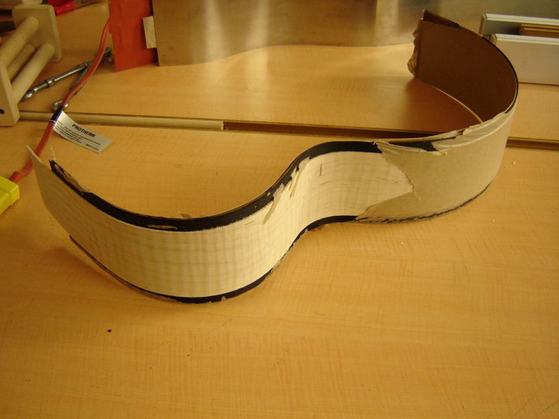

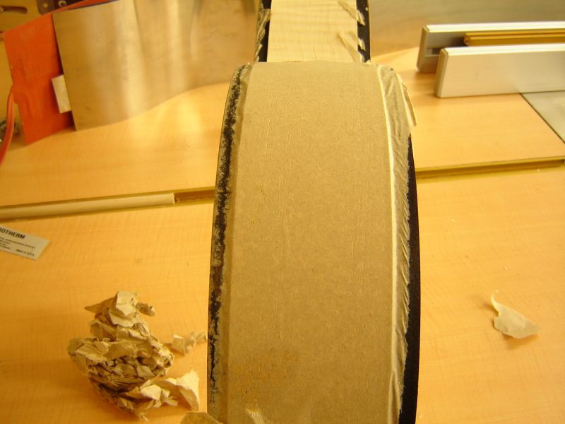

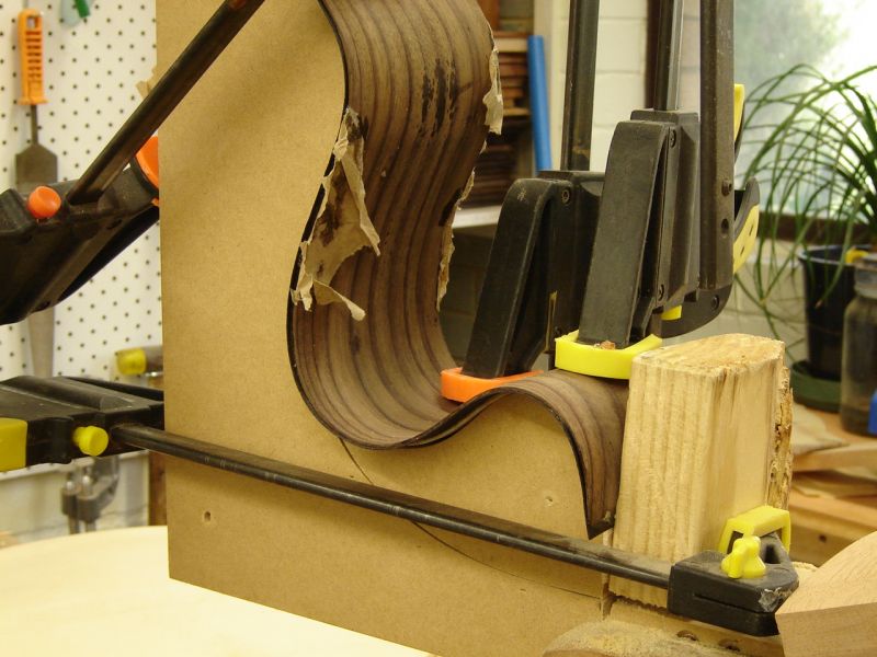

I think the experiment was a success. For bending I normally use 3 SS slats with a heat blanket and put turnbuckles on each end so I can pull it all down tight so my set up is perfect for laminating.
Took the sides out this morning and everything looks great. Fish glue seems to be as hard as normal and it was much easier doing it all in one step. The cutaway side I did in two steps and I was always worried I'd crack something trying to get the bent gluey sides back between springy SS slats and into the press and lined up properly.
This time I added fish glue between the layers and sprayed water on the outside then wrapped in paper. Then bent as normal but turned the heat off as soon as I thought I could to avoid cooking the glue too much.
Here's some pics.
You can see how flat the paper wrap is showing everything is nice and tight when in the mold because of the turn buckles on my slats.
With the maple outside ...
And the inside of the cutaway in the mold.
Here's some pics.

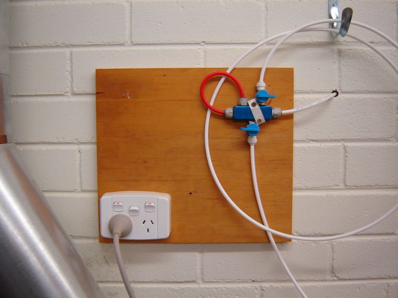

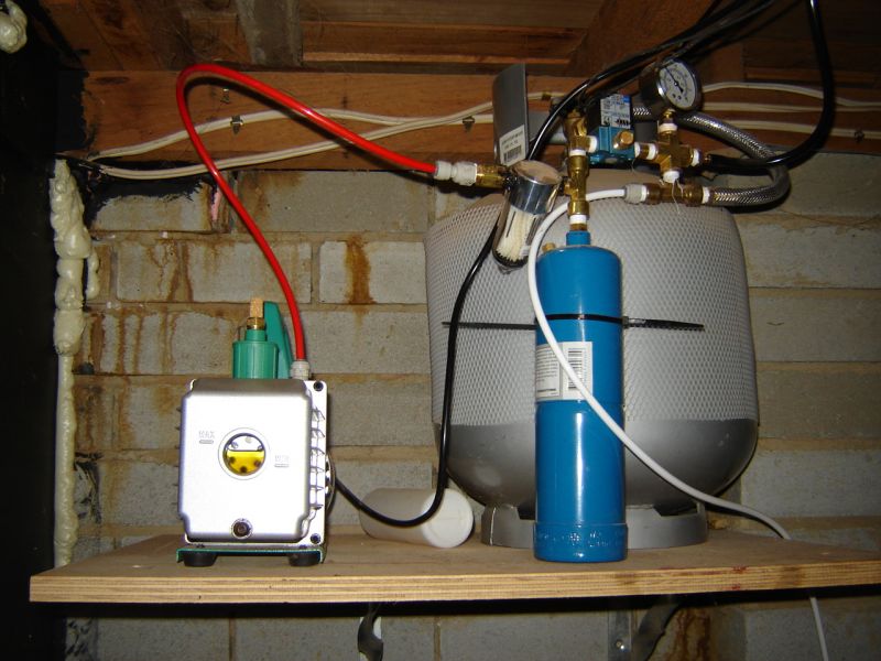

Allen, If you have not already I recommend getting the kit from Veneer supplies (Jo woodworker) to make a cycling system like an air compressor. They have lots of ideas on the web site for designing your own system. I used a 20l gas tank as the main storage and a small 2l tank for the buffer but the designs they use all are made of PVC pipe.
Here's a couple of pics from both sides. The switch is on the power point and I just tap a lead from one of the outlets on the manifold to what ever fixture I am using.
The pump is behind the wall where the oil mist from the pump is no problem.
