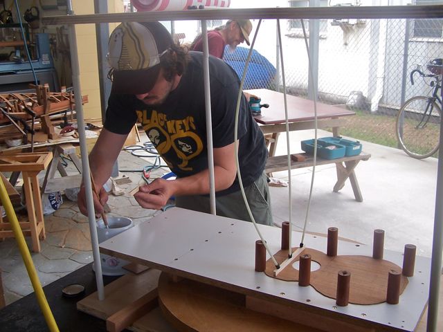

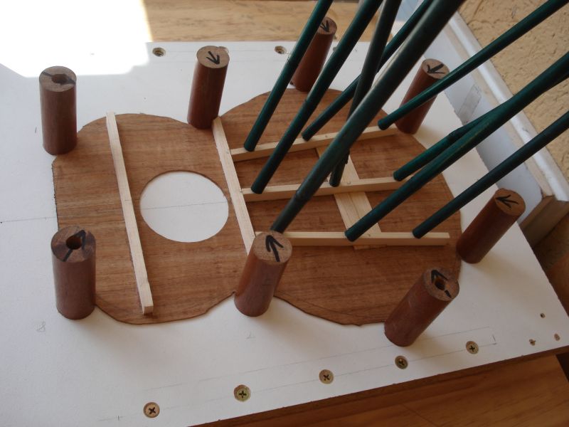

I thought that the best way of tackling this was to do a mock up of the parts, dimensions similar to the smallest pieces that we were supplied. I did these in New Guinea Rosewood, as I've got some sides and back all ready to go on another instrument, so a neck is just what I need. I haven't got any pictures of this part yet, but will soon.
The other part of the day was to shoot the back and top joints, and get them glued up. This was a real eye opener for everyone in the class. How to get a light tight joint with minimal effort. Thankfully the first couple of pieces that I demonstrated on were dead easy, to make me look like I knew what I was doing. :D Then I let them have at it, and helped out when they ran into trouble.

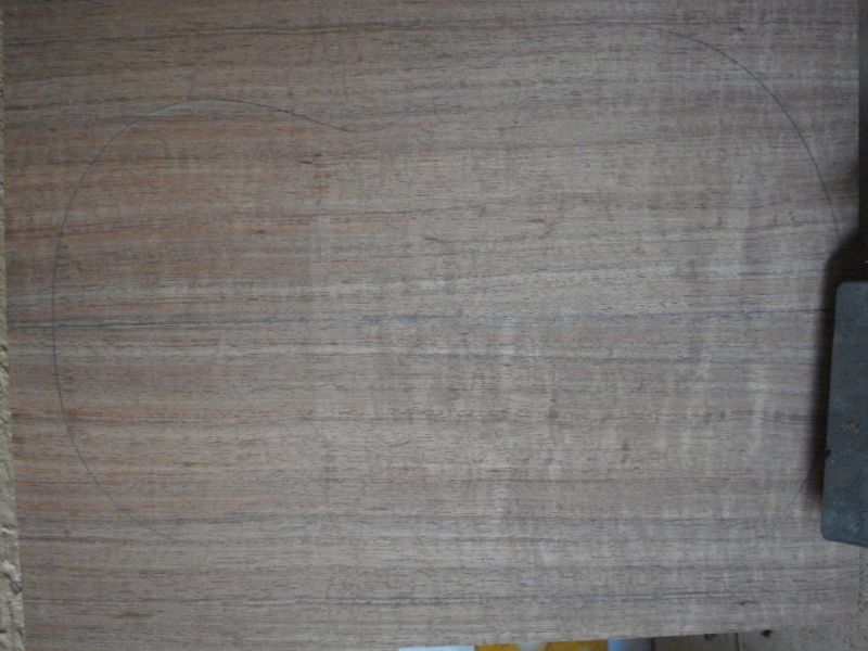

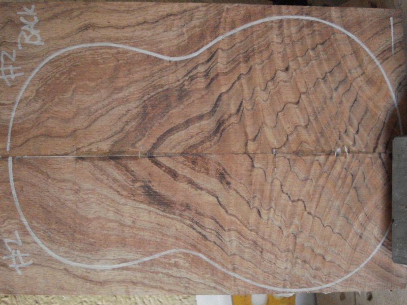

here's some of the uke timber supplied by tim s. to allen for the uke course.
pretty flash hey? 8)
nicer than the scrap i make my guitars out of :)
cross your fingers i dont wreck any of it.
photos don't do the sets justice.

Those sets look quite nice Liam. I was actually thinking building a little uke with the same timbers and all a few weeks ago and this thread has defiantly got me wanting to build one. Maybe something to do over the school holidays in two weeks!
The grain on the back set is pretty crazy, how did it get so squiggly? (to anyone who knows)

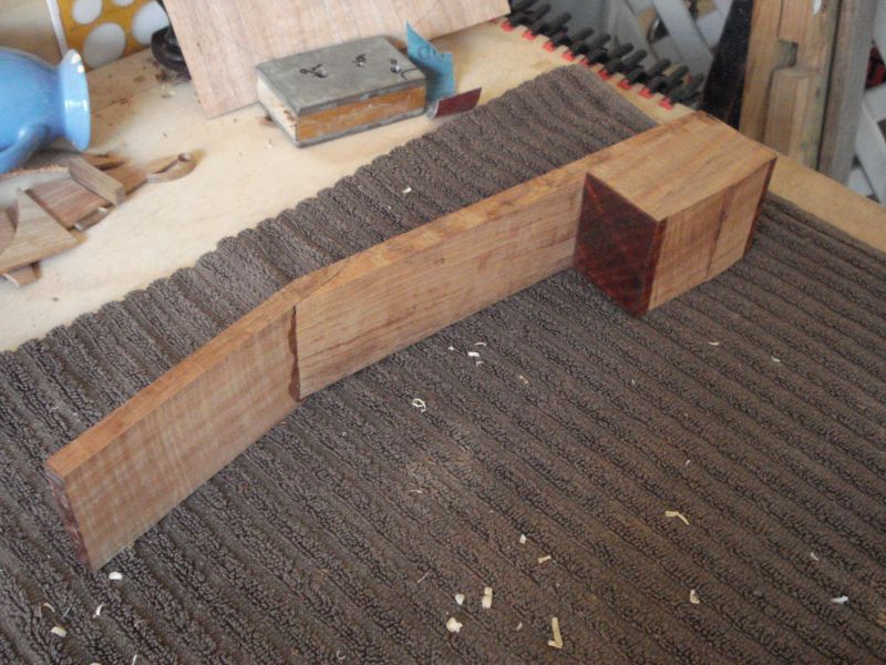

The necks were glued up last week using a scarf joint and stacked heel. I didn't get any pictures of the students one in the process, but did take a picture of mine.

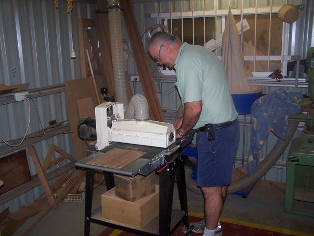

The top and back plates needed to be run through the drum sander. Took the backs down to 1.8 mm and tops varied from 1.5 to 1.7 mm

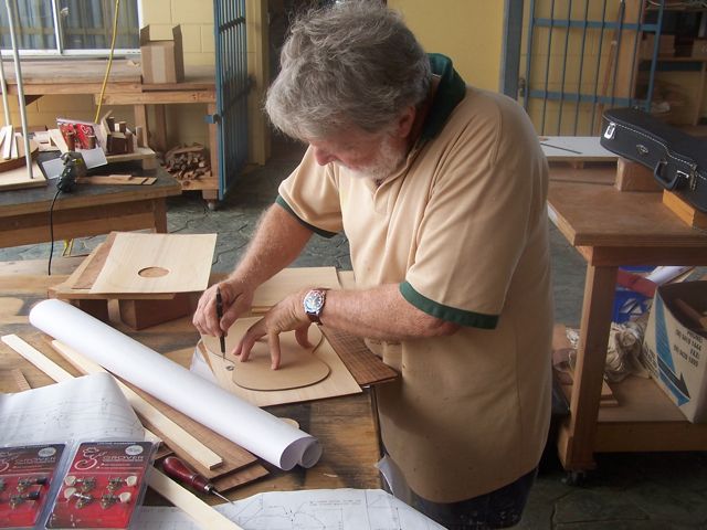

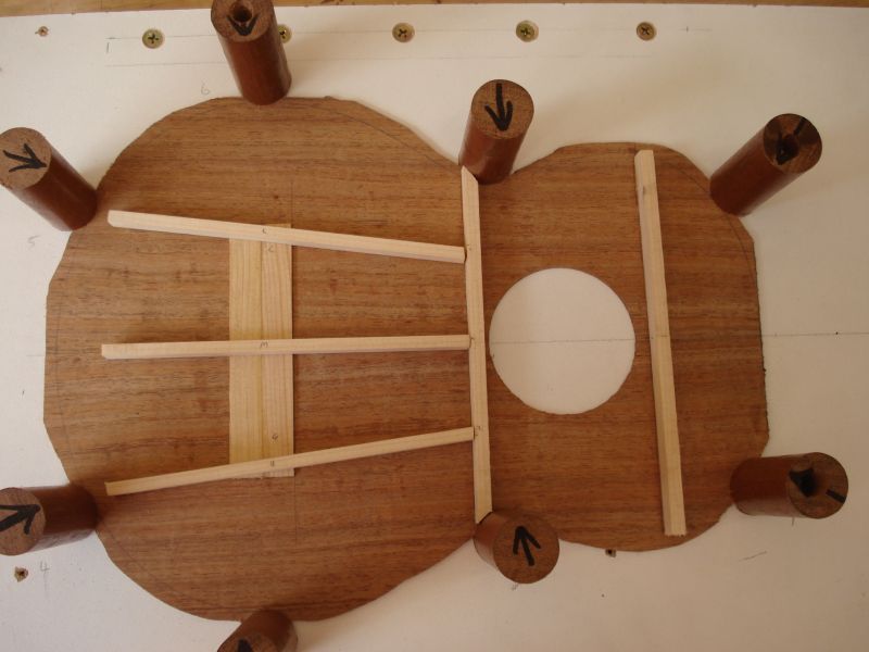

We used a body template with a washer to offset the pencil line by about 1/4" larger than the finished instrument. Then it was trimmed to this line on the bandsaw.

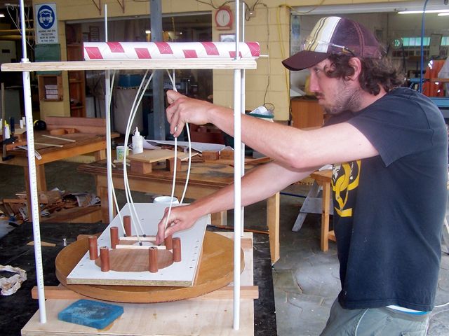

Then, I thought that if everyone wanted the full on "Secret Luthiers Training" they had better know about Hide Glue. So I brought in some dry glue, showed them how to mix it up, and gave a demo on using it. Then they had at it using my go bar deck.

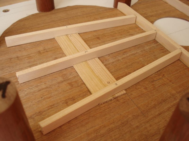

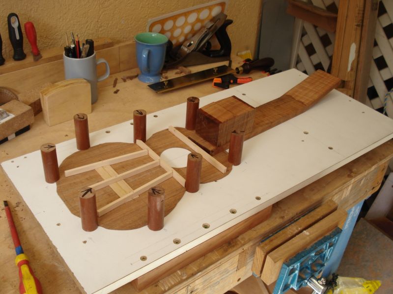

Then they put a 15' radius on the back braces and then glued them using my radius dish.

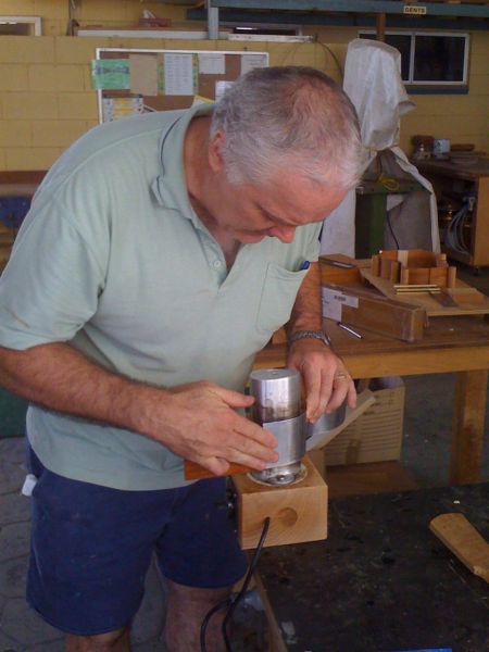

We also got the fret boards tapered using a little jig that I think that I first saw on Sylvan Wells site. I'll post pictures of that as well. Hard to keep the camera handy with so many people about at one time.
