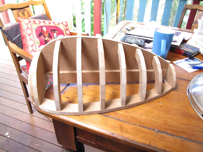

Slowly Getting somewhere
Post by zendo » Wed Jul 29, 2009 8:07 am
Well I am finally getting somewhere, at least with the mould. It has been a long journey... being re-acquainted with tools and wood, avoiding injury, cleaning up the old workshop, still playing my guitars and banjo and fitting in "paid" work at the same time. Martin has been a great and willing helper. My family have been tolerant and my friends look in amazement "What is this man doing?" Anyway I have learned heaps and surprisingly it has involved some "personal growth" as well... like connecting with others "past and present", exploring the art of making things by hand, questioning modern mechanical "perfection" versus using hand tools and deciding that "good enough" is the way to go... thank-you for the help from you all... Robert... ps. I will upload photos from now on.. :lol:

ooops, forgot to send the picture... hope this works... Robert
Post by Nick » Wed Jul 29, 2009 9:35 am
Receiving the picture Loud an Clear Robert. Another armadillo, good to see. It's funny, 6 months ago I hadn't even thought about Lutes, let alone seeing a build, now in the space of 2 months all I've seen is Armadillo's :shock: :lol: 8)
As far as self immolation with tools go, it still happens when you least expect it even if you build all the time! Every time I do a build I still end up with belt sanded finger nails and knuckles :oops:

All looking good there Robert. With my work schedule Id say youre going to be ahead of me in a few weeks time.

Looking good there Robert, you have done an excellent job on the mould.
I look forward to seeing more photos.

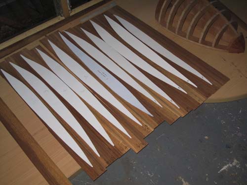

Post by zendo » Fri Aug 07, 2009 7:47 am

I agree about the Lundberg book but used in conjunction with other information it seems excellent. Productive days come and go but at least at the moment I am happy about the slow progress. I have regrets every so often but what else would I spend time and my money on? (don't answer that). Currently I have the rib pieces and templates ready (see photo) but I took a chance and cheated by using an electric planer to get the ribs to 2-2.5mm thick and will eventually reduce by hand plane to about 1.6mm. I am also taking another chance by using the band saw to cut out using the template before taking it thinner. I am reluctant to cut them out while they are 1.6 thick. The first cut one has worked well. I will need to be really careful and sand rather than plane the delicate thinner parts of the ribs. Wish me well. Sometimes I think I should have put the money down on a ready made Lute but then I would have missed all this fun :P By the way the ribs are made of Queensland Black Wattle because I wanted a cheaper wood for my first attempt and I won't use the AAA grade spruce top, any suggestions of what else to use, perhaps A grade or King Billy pine etc? Any ideas welcomed. Robert
