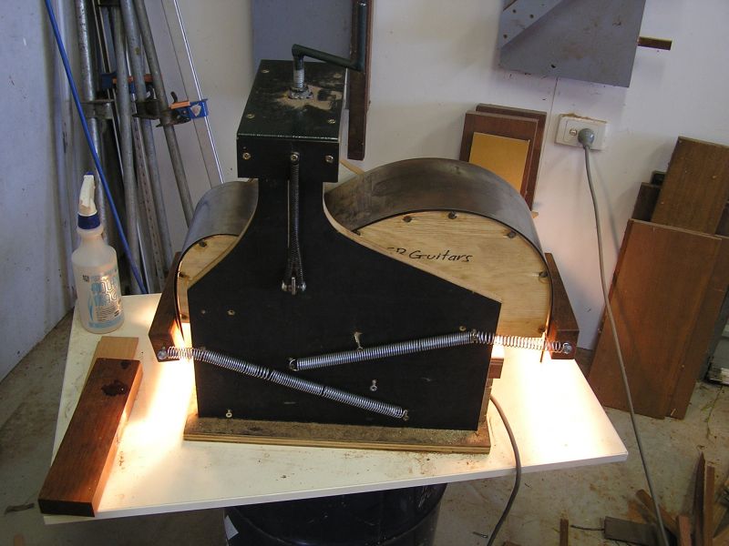

Hi PJ I wouldn't get anybody to bend my sides for me. You can make a Fox type bender with some ply offcuts and a few metal parts. Mine was made up from stuff that I had lying around at home. I want to upgrade sometime to a silicone blanket but for now the lightbulbs will have to do for the foreseeable future.Image

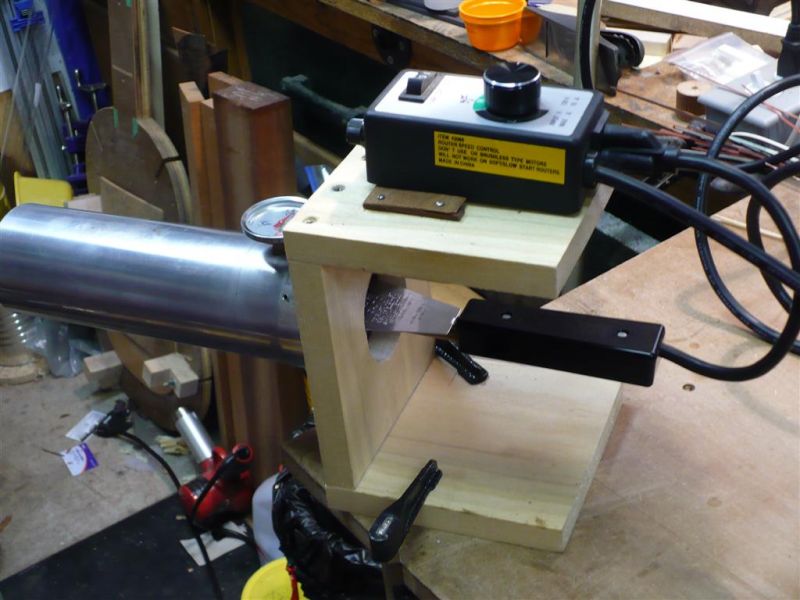

Here is my bending iron. Truck tail pipe section, electric charcoal starter, router speed control, grill thermometer. I have done two guitars with it, and it works just fine.Image
Waddy

Electric charcoal starter...brilliant! Didn't have 'em back in my day when I built mine...
Waddy, is that stainless steel for the pipe? Important detail to prevent rust staining wood...

Not stainless, Rick, but it stays rust free in my humidity controlled environment. I keep it wiped off, and scrub it with one of those synthetic steel wool pads when I'm through with it. If it does start to rust, I'll sand it clean.

Probably wouldn't want to use stainless steel, granted it would stay rust free, but it has poor thermal properties that wouldn't assist in bending sides (inconsistant heat regions e.t.c). You would be better off either using Waddy's method of cleaning it well after use or using a Copper or Brass pipe.
