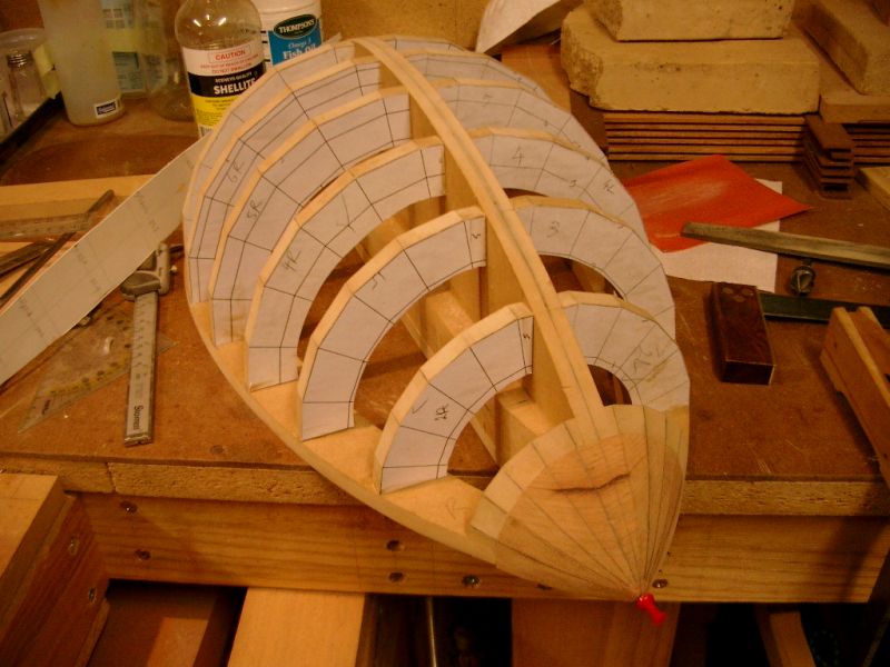

Post by kiwigeo » Sun Jun 14, 2009 7:37 pm
Back to square one with the (bldi) Renaissanice Lute. I wasnt happy with the first attempt on the body mold so made version two of same this time paying more attention to dimensions. I followed Allens suggestion of sticking photocopies of the plans of each ribhb section onto the MDF and it resulted in more accurate cutting out and shaping of same. I also shaped the rib sections using a hand plane and sanding stick rather than the power sander.

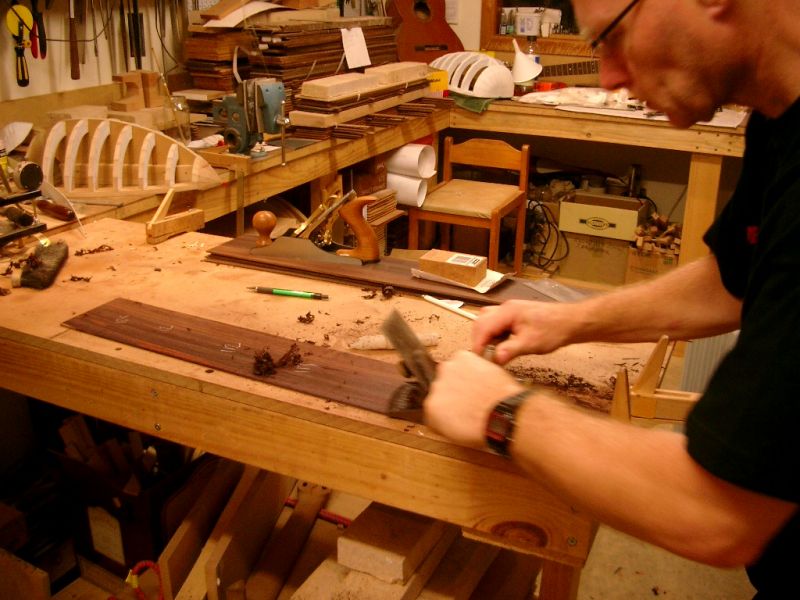

Ive got a stack of Opp grade Allied IRW back and side sets and most of them arent matched so theyre going to make up the bowl of the lute. Some of this stuff is really quite pretty.

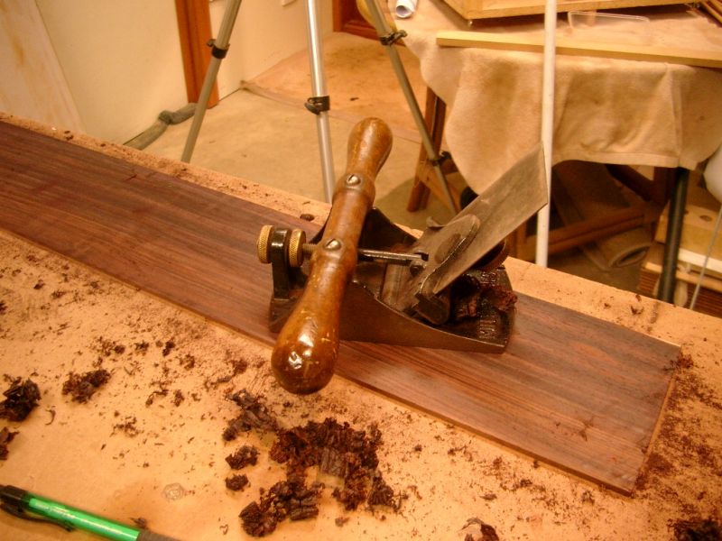

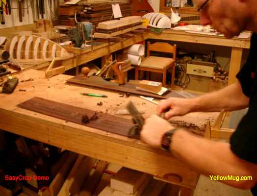

Working side blanks down to circa 1.4mm (0.065") using the trusty old Miller Falls scraper plane. This bodgey looking old handtool is great for working on rosewood and other woods with rogue grain.
Post by Allen » Mon Jun 15, 2009 5:32 am
Now there's a mold that anyone would be proud to hang on the wall.
Are you going to be using some contrasting purflings between the staves Martin?

Post by kiwigeo » Tue Jun 16, 2009 8:52 pm
Like any huge project that gets into trouble I've spent the last few days looking at what Ive done so far and how I could re-do things better. Version 2 of the body mould went ok and although its not perfect Im going to run with it.
Van Andrews supplies plans of the ribs but in his instructions he says to make up cardboard ribs and test fit them and from these make up actual rib templates. I tried this with the central rib and just about drove myself crazy trying to get the thing right. The original middle rib plan as supplied by Van Andrews fits roughly with a few adjustments needed in places. Im going to run with same and make final adjustments to the rib prior to gluing. This is the approach Dave White took with his lute and it sort of makes sense.

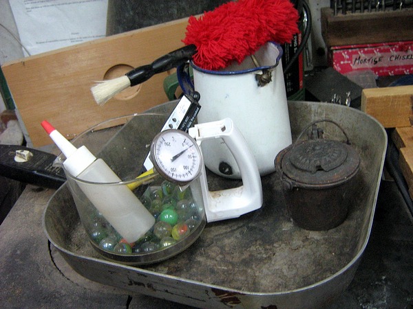

I've always used hot glue for my piano work . Here's a pic of what I've been using for many many years . Just an old second hand electric frypan . It allows plenty of room for a jug of hot water for clean-up and brushes etc , an old glue pot, and more recently, the newer idea of a little squirt bottle. I warm up parts to be glued on it as well. I sit it next to the job at hand and because of it's thermistat keeps a constant temperature

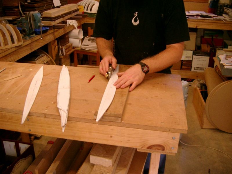

Working on the templates for the ribs. Ive just taken the plans and stuck photocopies of the rib drawings on some 3mm MDF. Ill cut the ribs oversize and then trim them to final shape after test fitting on the mold.

Ribs are different shapes.....13 ribs in all. Each template makes up two ribs...one either side of the centre rib.

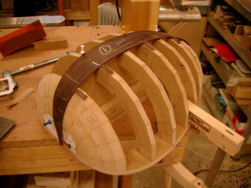

Post by kiwigeo » Sun Jun 28, 2009 7:16 pm

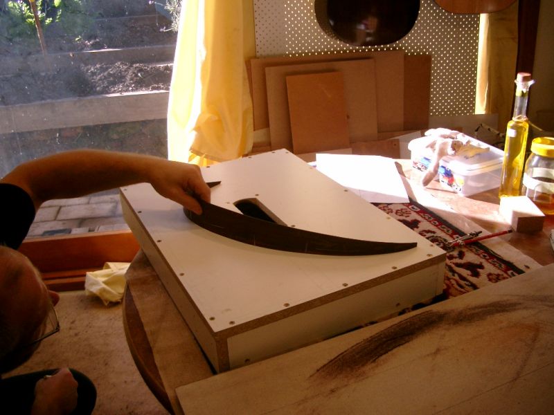

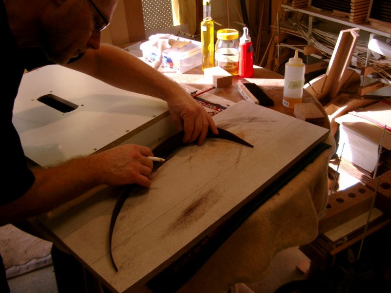

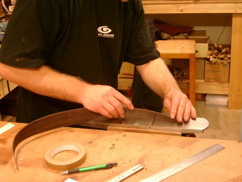

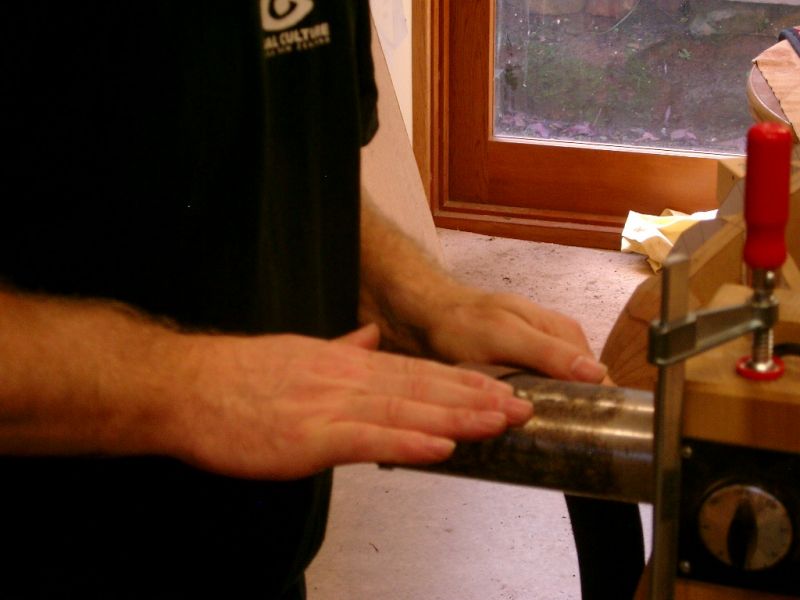

Rib number one got worked on today. Pics show bending and shaping of the central rib. Shaping of the rib was done on a Veritas Big Daddy Plane and a sanding board.Image
Post by Allen » Sun Jun 28, 2009 7:20 pm
Ooooo, bending wood. It's all starting to come together Martin. That first rib is looking like you've been building these for years. Looking forward to seeing the glue flying next.
Post by Dennis Leahy » Sun Jun 28, 2009 8:30 pm
Looks great, Martin! And, it looks really difficult to get the bend just right, but I suspect the devil's in the seams.
Thanks for documenting this - very interesting!

Post by Dave White » Sun Jun 28, 2009 10:33 pm
kiwigeo wrote:All going too well for my liking. I dont like instruments that go together without any problems.
Martin,
Don't worry - your wish will soon be granted, trust me I'm a luthier 8)
Great stuff - the first rib on and the form looks in great shape. Nice to see someone doing the joins the traditional way :oops: That will keep Colin happy.
Keep the pictures coming.
