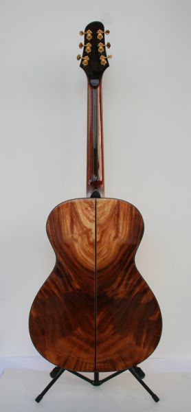

Hi Friends of ANZLF,
Just completed an OM with lots of runouts Sitka and Monkeypod B&S.
Binding is Malaysian Blackwood.
Fortunately it sounded much more better than it looks.
Thanks for looking.
Jeff

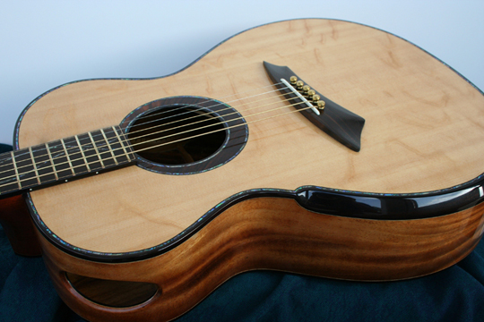

Nice, I like the soft edge for your right arm. Very stylish bridge and rosette too.

Um, welcome Jeff, and that "lots of runouts" top looks like nice bearclaw Sitka to me, and I don't see any runout (dark/light halves) in this particular photo.
Glad it sounds better that it looks, because that means it sounds very good!

Beautiful, as usual. You have an excellent sense of the asthetic - great taste.
If it sounds better than it looks, I'd bet it sounds awesome.
Gotta get me some of that monkey pod!

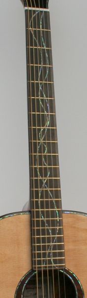

Any chance of some photos of the inlay work on the fretboard?

Hi Martin, The inlay is a free form of abalone strips, its easier to inlay a crooked line than a straight one!
Hi Dennis, I hope this photo is much clearer to see those 'defects' on the top.

Hi Jeff, that a great looking guitar a good balance of everything. The figure in the back is very striking, well done very pleasing on the eyes.

I love the way the fingerboard inlay transitions into the rosette.

Good to see you drop in again, it's always a pleasure to see your wonderful work. As usual this is a stunning guitar and it has some real eye candy features. As Bob pointed out the transition of the fretboard inlay into that of the rosette is very stylish, but another thing that caught my eye is the brass bridge pins. Do you think they add anything tonally or did you just decide that you like the colour?

Yes, those pins are custom made, people always think that it will sound brassy....brass are naturally related to sound. I made those pins less massive comparable to those fosillised ivory, its all about density of the pins. It brings out the clarity and sustain and power too. :idea:

I agree with you about the pins being about density. I think that the folks who notice a difference when adding the commercial brass pins are really hearing what more mass can do for perhaps an overbuilt guitar. Since you have reduced the mass and like the results this is an alternative that I never thought of and it makes sense that they would work on a guitar that is not over braced.

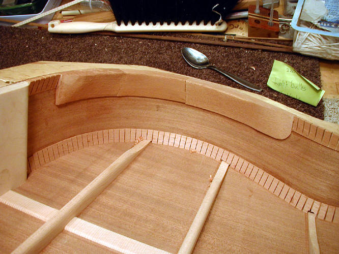

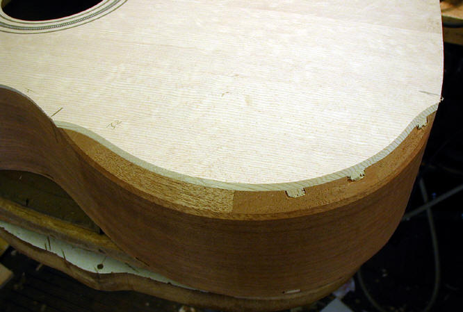

Absolutely beautiful Jeff. Great combinations of timbers used, I love the bridge shape and the ecentric rosette. There's just too many features to mention them all. I must find out how those round arm rest edges are done too, they're a great feature.

Hi Nick,
Thanks.
Here are some pictures I found on someone's site.
Hope this helps.
Jeff
Post by Nick » Tue Mar 03, 2009 5:22 am
Does indeed, thanks Jeff. :) :) :)
