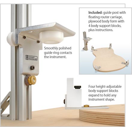

Craig buddy cutting bindings is always problematic for builders until we jig-up with some special jigs.
Here are 3 possibilities for you from high-tech to low-tech. In all cases something that is often not addressed by newer builders is the importance of truing up the sides perfectly flat prior to cutting the binding channels. Since most methods register off the sides any imperfections in the sides that the binding jig registers off from will show up as an imperfection in the binding channels.
With this said a great tip that I got from Mario, a superb Canadian builder, is to cut a very shallow binding channel just deep enough to take the top and back plates less than flush and out of play. With the end grain of the top and back plates out of play truing up your sides with a flat block and 120 grit is FAR easier and way faster.... Also, the climb cuts as per the diagram above, are always how you want to make any binding cuts including the initial shallow passes.
Here are the jigs:

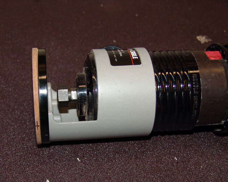

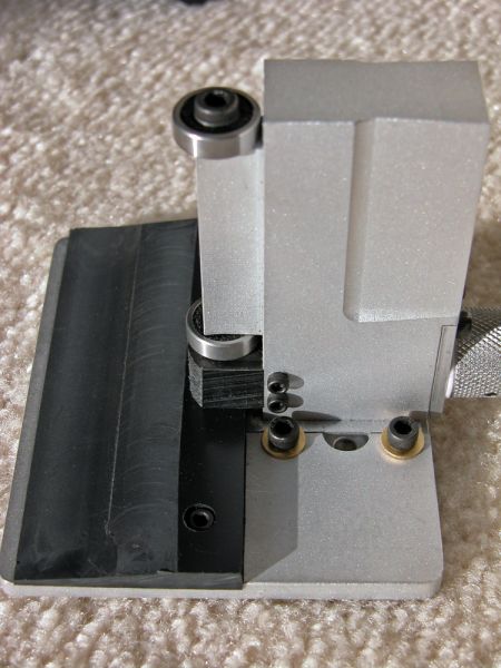

First is the William's jig, much like Dave's but without his mod. It's so very easy to use that even a Yorkie can do it....
Next this type is a commercially available jig from Luthier Tools. Lots of folks like these and I would have too if the possibility for the thing to lean inward and take a divot out of your back or top did not exist.
Lastly this is just a double stick taped wedge on the bottom of a Laminate trimmer. Very low-tech but if you calculate the angle of the wedge needed to match the respective dome of your top and back, you need two wedges, these things can do a decent job for very little money and effort. Note the marks on the thinnest part? These marks should be always toward the peak of the dome when routing around the guitar. So you rotate the Laminate trimmer in your hand keeping the marks pointed correctly much like a draftsman will twirl a pencil to keep the point sharp.
Dremels as others have said are just not powerful enough for routing binding channels.

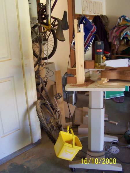

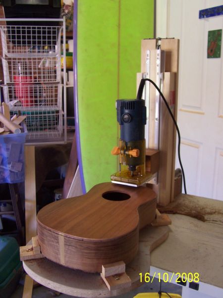

My take on the binding channel cutting problem is this
-A laminate trimmer is the right tool because it is powerful, light and fast. Speed is essential to get clean cuts.
-A downcut spral bit helps to get cleaner cuts compared to a straight bit
I cut my first instruments channels by hand with a purfling cutter knife ( too much hard work)
The second was with a handheld trimmer with a base registering on the sides with two bearings.(still the danger of tipping inwards)
The next and all after are with a post/ slide mounted trimmer
set the body up on a plate and move it into the trimmer. WORKS GREAT
I used the baseplate from the handheld jig but with the bottom bearing removed. I could have used the guide that came with the trimmer.
I used a pulley wheel at the top and a counterweight to lessen the pressure on the face of the guitar.
You have the choice when using this type of rig to use the stewmac bits with the attached bearing or a separate bearing. Having experienced a seized router bearing in the past, I preferred to use the separate guide bearing. you do need to keep the body edge perpendicular to the jig (or the cut will be shallow), but this is easy and you can go around again if needed.

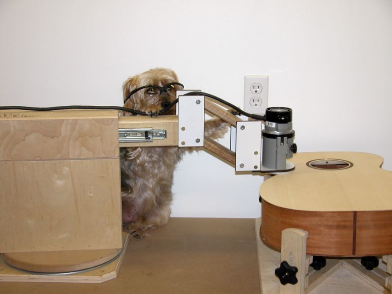

Craig,
I'm stealing Stew Mac's version of a binding jig.
Granted it isn't built yet, but I have all the bits and pieces now to put it together. The pillar is T-slot extruded aluminum that I got off of eBay. Shipping was more than the part and shipping wasn't bad.
I picked up a piece of aluminum angle for a few dollars and then I stalled trying to figure out how to mount the wheels. Not working for me, so I decided to ditch the wheels and go with linear bearings, which in reality are nothing more than pieces of some sort of plastic that fits into the slot. No wiggle no need to figure out the depth and the width.
These will get mounted on a plate that will be screwed into the side of the angle piece. I'll probably put one behind the angle plate as well.
