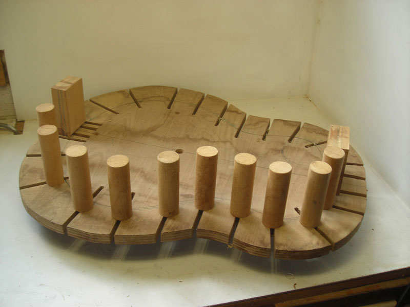

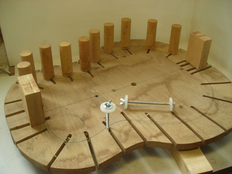

Here is my universal guitar workboard. 3/4" ply with some 2x1 underneath so it can go into a vice.
The end blocks are attached with lag bolts and wing-nuts
Using long bolts with big polyethelene (kitchen chopping board material) washers the workboard can also be used for gluing the back with the soundboard supported in its slight arching

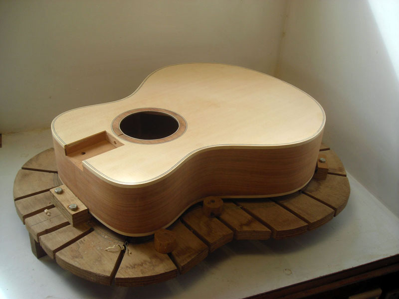

And with a couple of extra little brackets it holds the body for sanding as well
Hope that is a little useful

This one is flat, though I have another with a scoop in the lower bout that I modified for a classical I recently built following Eugene Clark's methodology that was written up a year or so ago in American Lutherie. The guitar in the pic was built on the workboard with the arch on the soundboard supported by two crescents of thick card that extend around the edge of the lower bout to the waist. The soundboard above the waist is essentially flat with the 25' curve in the X braces only sanded in below the crossover. On this instrument I built it like a Spanish classical, but without the integral neck. The soundboard and sides are animal glued together with tentalones and then the back added.
This sort of jig can also be used in the same way as a solid mould to put together the sides, blocks and linings. I don't radius the soundboard edge of the sides, just keep them flat, but the back edge gets radiused to 15' with a piece of tubing inserted into the large hole in the middle of the lower bout and the sandpaper covered radiused dish rotated around it . I find this a versatile and flexible approach for a mould, especially if you don't want to go into production with a particular body shape. Mine kee4p evolving so this works well. It works for both guitars and my guitar bodied bouzoukis and I have a couple more for different bouzouki types.
graham
