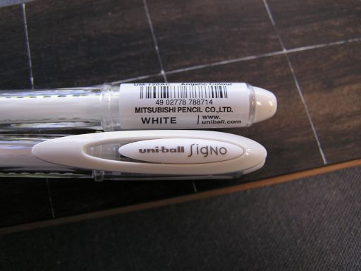

I picked these ballpoint pens up at the local art supplies store.
The tip is 0.7mm - fine enough for many tasks - and the ink can be removed with a damp cloth.

Nice tip, I have used my kids white pencils so far but after your post I am really annoyed with my partner as she has worked in a Art Supply place for 15 years. Hmmmm or should I blame myself for never asking.
Post by Allen » Tue Dec 23, 2008 12:45 pm
Welcome to the forum Peter. Good tip about the pens. I could use them for all kinds of things. Gotta go into town and get me some.
Post by ozziebluesman » Tue Dec 23, 2008 2:43 pm
Thanks everyone for your tips. The awl and the chalk and the white ball point pen are great tips.
