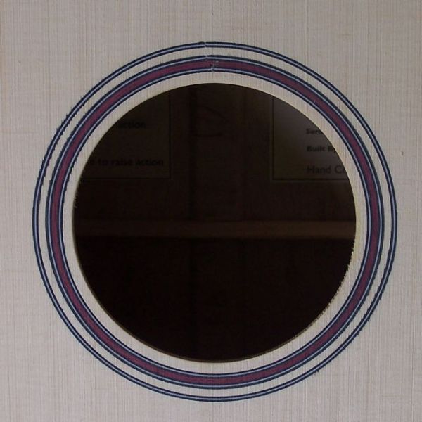

Some more progress today. Back strip inlayed and back thickness sanded, ready to brace.
The binding is going to be purple heart. I've had some for a couple of years, and this is the first set of wood that the color works with. I wanted the rosette to tie in with the theme, so had to bend some up. It was slow going trying to get the radius bent without snapping and splintering, but I got there eventually.
The top is Engelman and is really stiff, with some beautiful silk. More of Graham Hiens AA wood. It's just so nice, I'm not sure why you'd spend more for the higher grade stuff.
I also have the X-braces glued up and drying over night.

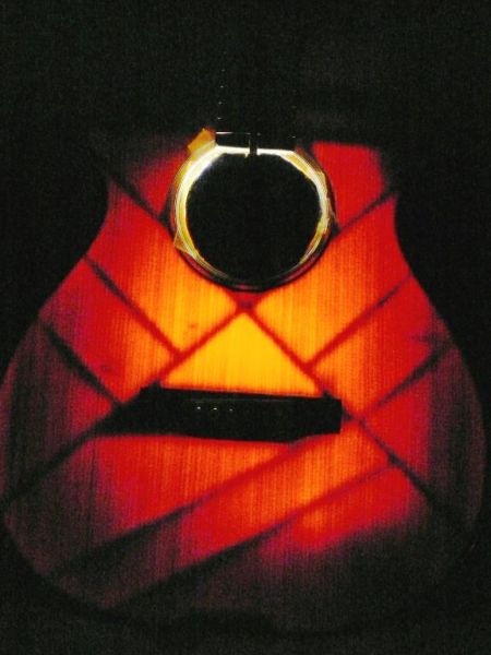

Another productive day. Glued on the back last night, had most of the bracing done on the top, then finished it off today and got the box closed up.
Now the pressure is off. It's bloody difficult building anything in the tropics during the wet season. Moving from the RH controlled environment to the garage, where I'm allowed to make all the mess I like, and back every 5-10 minutes is tiresome. The top wants to turn into a donut if left out too long.
I made the bridge patch larger than I usually do. It's 1 3/4" to the edge of the x-brace. I was concerned that the large area would show a flat spot without some sort of reinforcement.
This is the first time I've used scalloped braces. Being a bit of a mystery to me, I watched Robbies bracing video, and jumped in. I penciled in a line 3" in from the rim. This marked the peak of the braces. I tried to keep the x-braces full height to the bridge, so penciled in the bottom of the scallop 1/2 way between the two points. Then went at it with a chisel.
Interestingly, the tap tone and response from a scalloped brace is different from a parabolic one. I ended up taking the point of where I started to scallop the x-brace north to the edge of the bridge plate to get it to loosen the top up a bit.

Now that the top is glued on, there is a really nice tap tone to it. I also notice a slight change in pitch from bass to treble side, with the treble being just a bit higher in pitch. I'm hoping that this is a good sign of getting things right on the inside.
The lower tone bar just ended up that way Bob. When I penciled in the 3" in from the linings, that's where the peak ended up on that brace. I'm treading in unknown waters with scalloped bracing, so I took my best educated guess, and went with it.
