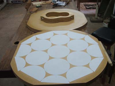

If your after sticky back paper for your radius dishes it works to just buy 150mm PSA discs from the paint and panel (auto paint ) shop.Make a nice pattern and it has an additional benefit of somewhere for the sanding dust to collect between the circlesImage
Paul B
Post by Paul B » Fri Dec 05, 2008 2:06 pm
That's a pretty cool idea.
But, do the edges of the discs lift and accumulate dust underneath?
Localele
Moderator
Posts: 357
Location: Corndale,NSW
Post by Localele » Fri Dec 05, 2008 5:29 pm
Hasn't been a problem as they are stuck to a lacquered surface.I have since got some rolls from Stew-Mac but I think the discs are easier.Cheers.
