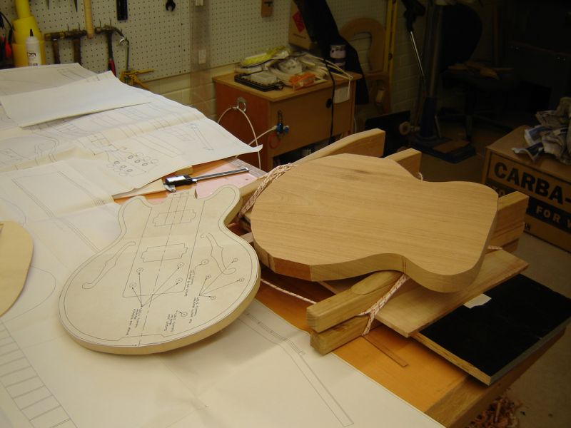

Someone posted a lovely Spalt maple CS336 a while ago and I instantly wanted one.
I have a nice piece of maple from Perry Ormsby for the top and I have a 3m slab of Sapele which I use for bodies. Here I have glued up the maple top and roughed out the Sapele body. I still need to make the routing templates.

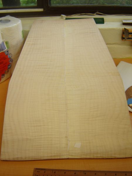

Here is the maple top. This will look great with a stain. The Gibson web site has an up speced CS356 in red with gold hardware that looks great.
http://www.gibsoncustom.com/flash/produ ... S-356.html
I could go for something like that.

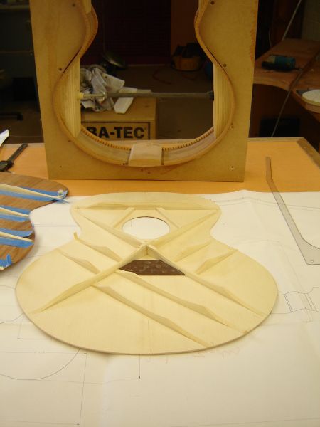

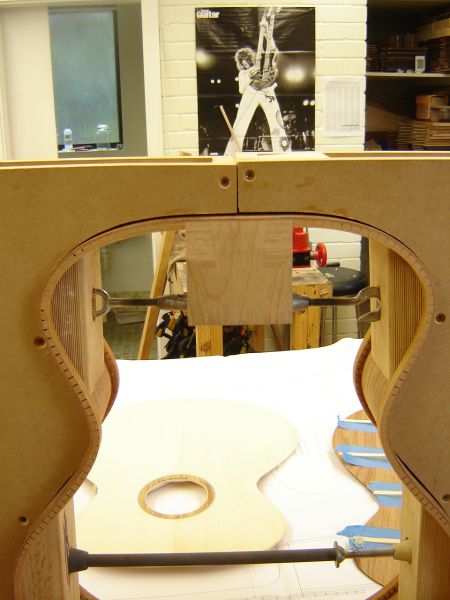

I have also been making an MJ. Carp spruce top and blackwood B&S. I have followed the plans very closely including the brace scalloping.
But I have used a large foot on the head block that is dovetailed into the block to increase glue surface. The idea to stabilise the neck block area with a foot is from an article in the Winter 2007 GAL journal on Eugene Clark. Very interesting article btw.
In theory it is trying to do that same thing as flying braces like Mr Turner et al. The end of the foot will meet up with the upper cross brace to help distribute the force from the strings over a larger area and prevent the neck pulling up over time. That's the theory anyway!

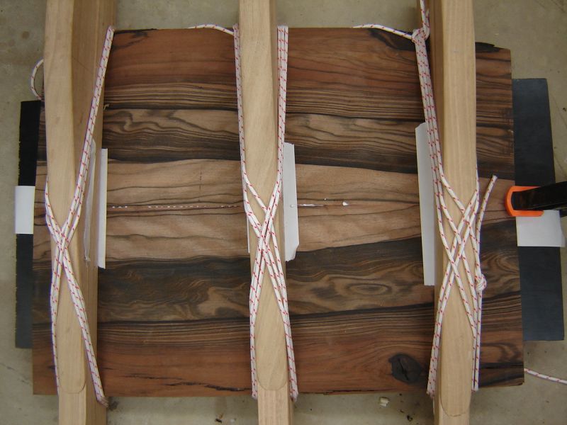

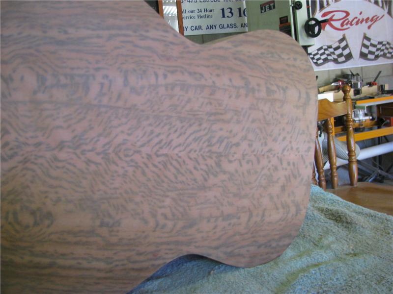

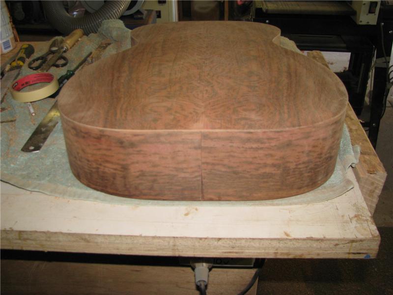

Julie has been hassling me to use some nice striped Macassar ebony she got me for my birthday a few years ago. So I decided to make an L00 and i started that today.
Glued up the back and put the sides through the sander.
Here is what it looks like.
Back
and sides

Thats one busy piece of tone wood, gonna be great to see it come together. My latest two/three guitars, two with three piece backs, recently started look boring in comparison.

Great progress Dom my friend and that wood is just killer!!!

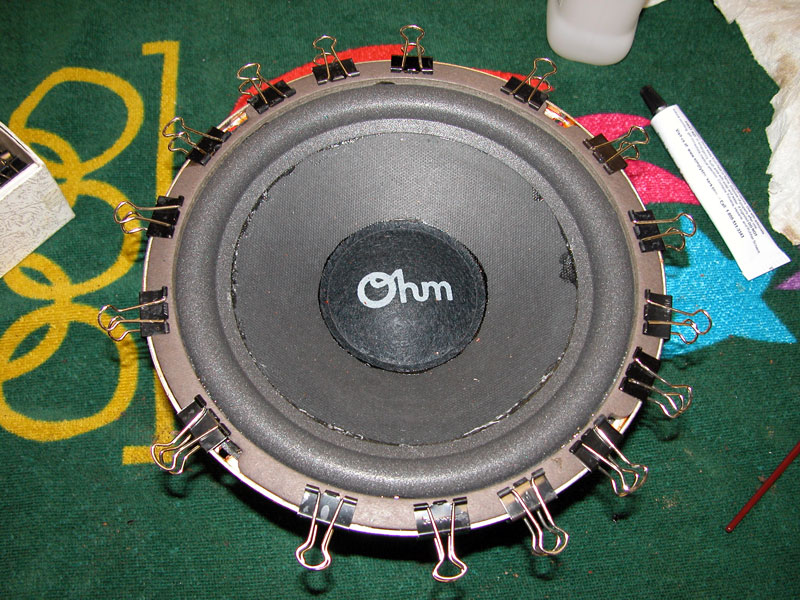

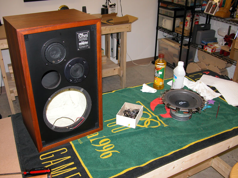

One of the details is installing some nice speakers and I have this pair of 30 year old Ohm's that needed the surrounds replaced. So I have been repairing these speakers and gluing in, with rubber cement, new surrounds.
It's a nice break from what I usually do in my shop, other than the fumes from the cement.... and they are looking great. I'll know how well they sound, or if they work at all, later this morning.

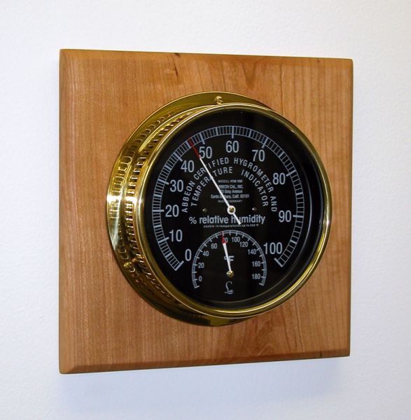

Also my friend JJ made me a plaque out of some awesome cherry that he milled. This plaque is for my Aberon hygrometer. This device is pretty good looking so I wanted to do it justice and have it mounted on some nice zoot.
Check it out:

Nice timber Dom, I gotta get me some of that stuff.

Hesh, those clips are not evenly spaced around that speaker....... maaaaate.......!?!.....

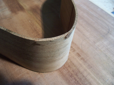

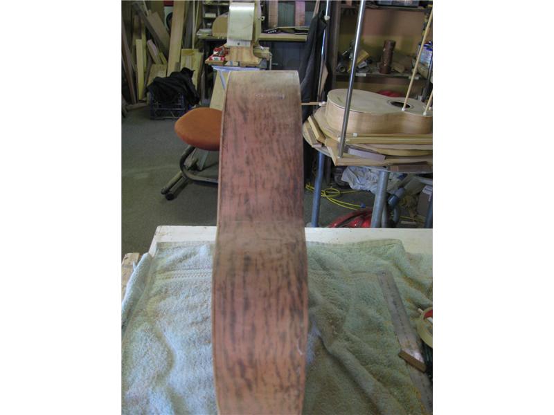

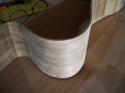

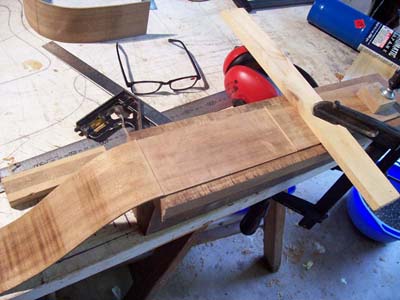

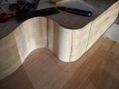

Some pics
Here is the start of the Semi-Acoutsic. I have never bent this wood before (Acacia Ariculiformis). To look at it reminds me a little of Qld Walnut except a tan colour rather than brownish.The bend on the upper bout on this design requires a 30mm radius and I decided to just go for it with the wood being about 2.8mm thick, the results are shown in the pics. For the even tighter bends of the Cutaway I thin that section of the side to about 1.5mm and then rebuild it after bending with Veneer and Epoxy glue (Mega Poxy), next time I will thin the 30mm radius bend too. :roll:
Pic 1, Too much crack is not good
Pic 2, After crack rehab, a dose of Urea Formaldahyde
Pic 3, Thining the side to bend the tight curve for the cutaway
Pic 4, After rebuilding the bend with a piece of Sassafras Veneer

Post by kiwigeo » Tue Nov 25, 2008 3:38 pm
Nice save on that cutaway Jim.
I think 2.5mm is probablly a bit thick for a tight bend like that. I work down to at least 2.0mm on normal bends on my classicals and steel strings (using IRW).

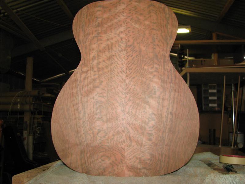

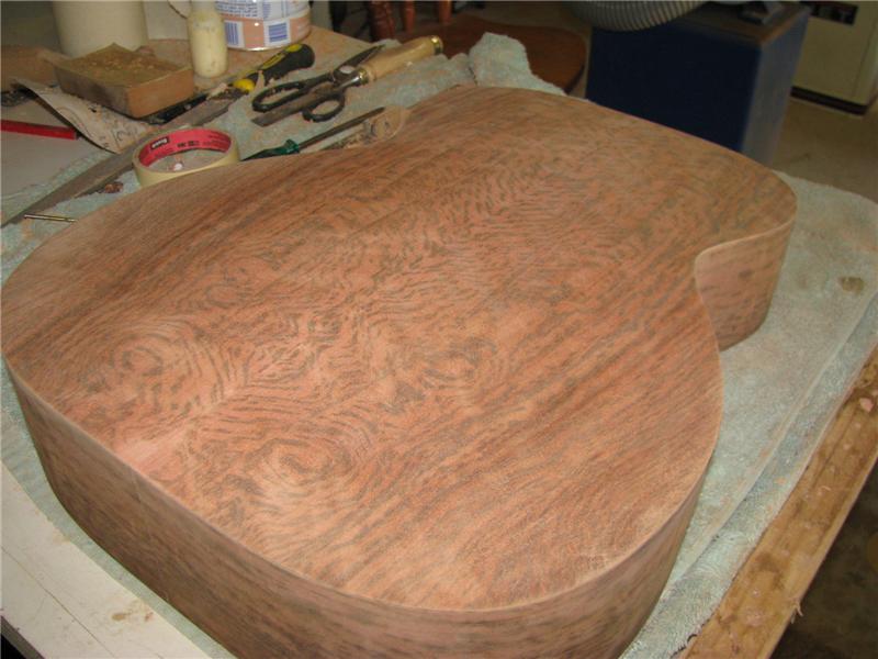

Post by Bob Connor » Tue Nov 25, 2008 4:16 pm
This is an OM we're building for Tony O'Neill. Tony is the owner of the prototype mando we built a while back.
This is Tiger Myrtle and it'll have an Adi top which has already been built and voiced so it shouldn't be too far away before we close the box up on this one.

I'm looking forward to seeing a finish on that Tiger Myrtle.
Hi Martin
I knew I was pushing the limits there and grinned when it snapped. I'm not sure if you understood because you said "nice save on that cutaway Jim"....it was the left hand upper bout that I snapped the cutaway side I thinned to 1.5mm and bent easily.

Post by sebastiaan56 » Tue Nov 25, 2008 5:24 pm
Bob,
Was the Tiger Myrtle from your foray to Tassie? it is fairly spectacular.
matthew
Posts: 1193
Location: Sydney, Inner West
Post by matthew » Tue Nov 25, 2008 5:42 pm
bob wrote: Image
Oh, yum ...
... so does that stuff come in double bass sizes? :twisted:
Post by Allen » Tue Nov 25, 2008 5:47 pm
A double bass in Tiger Myrtle. :shock:
Now that would be a thing of beauty. Live and dream Matthew. Maybe you too will have a neighbor find the Lord, and leave you a cubic meter of the Tassy Tiger. 8)
Post by Bob Connor » Tue Nov 25, 2008 9:25 pm
That's from a really nice piece I got a few years ago and unfortunately there's not much of it left.
Matthew - most of what I get is 30mm thick. If it is left much thicker than that it's a bastard to season. Plus it's really difficult to get Tiger Myrtle in long, clean boards. There always seems to be some checking or rot that makes it difficult to get a reasonable yield from it.
What size do you need for a bass? I'll keep an eye out for some if you want me to.
