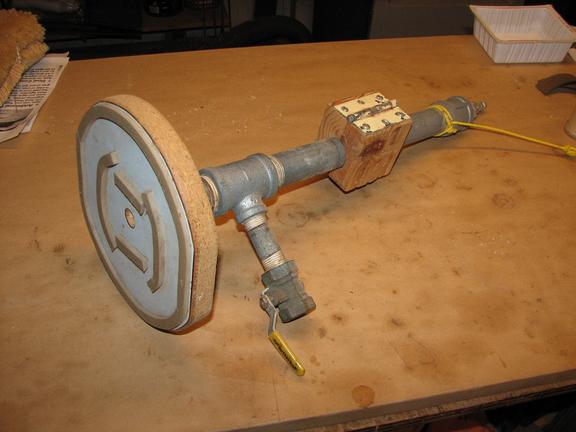

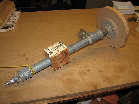

Here's an inexpensive version of the rotating vacuum clamp that I used many years ago.
As you can see, it's made mostly out of galvanized pipe and leftover fittings from my plumbing packrat box. The quick disconnect fitting at the bottom is from the auto parts store and leads to the vacuum source. A gas line valve opens and closes the system to the atmosphere. The wooden hinged thingie on the pipe goes into a vice wherein slight loosening of the vice allows for easy rotation of the device. The main pad comes from discarded mdf sink cutouts and the foam tape is closed cell weather stripping, again from the hardware store. I had many instrument-shaped plates that could be placed against the vacuum surface for different sized ukuleles. I think the vacuum system is ok, and LMI's version quite elegant but in the end I switched back to more traditional clamping systems. To each, his own...
